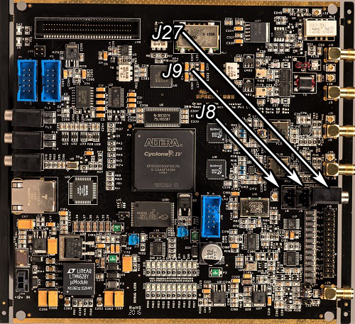

J9 (plastic jack) on the Orion Board is supposed to be the Left Speaker. In parallel with J9 on the board is J27 which is a TRS 3.5mm "stereo" jack.
J8 (plastic jack) on the Orion Board is supposed to be the Right Speaker. There is no additional 3.5mm jack on this one.
During assembly the Left and Right speaker wires going to the rear panel spreadout were plugged into J9 and J27. That puts both speaker jacks in parallel on the Left channel output. By moving the wire that was plugged into J9 and move it to J8 you restore the "stereo" output.
I believe that the L-R swap may be in that the L and R on the rear panel spreadout was swapped. Because one of the rear jacks has a 3.5mm plug it can only be plugged into J27. If the L and R wires from the spreadout were both on plastic plugs then they could be simply swapped on the Orion board. Because only one is a plastic plug it is the only one that can be swapped.
Fortunately the easiest fix as you said is to just swap the speaker plugs going into the back of the radio. The only way I can think of to permanently fix it is to remove the 3.5mm TRS plug and replace it with one of those plastic plugs so that the L and R speaker wires can occupy J8 and J9 with nothing in J27.

Thanks for the explanation Rick, the only thing is I moved from J8 to J9 not 9>8 ?
Looking at the photo of the photo of the Orion board in the back of the manual I am guessing J27 is the jack to the right of J9?
Paul

Hi Paul,
Here's what I saw in there. J27 is the black 3.5mm TRS jack facing outward at the edge of the board along with the SMA connectors. J9 and J8 are black plastic connectors. Starting with J27 at the board edge and working toward the center of the board the order is J27, J9, J8. On mine I moved the wire plugged into J9 and plugged it into J8. Hope this helps.
