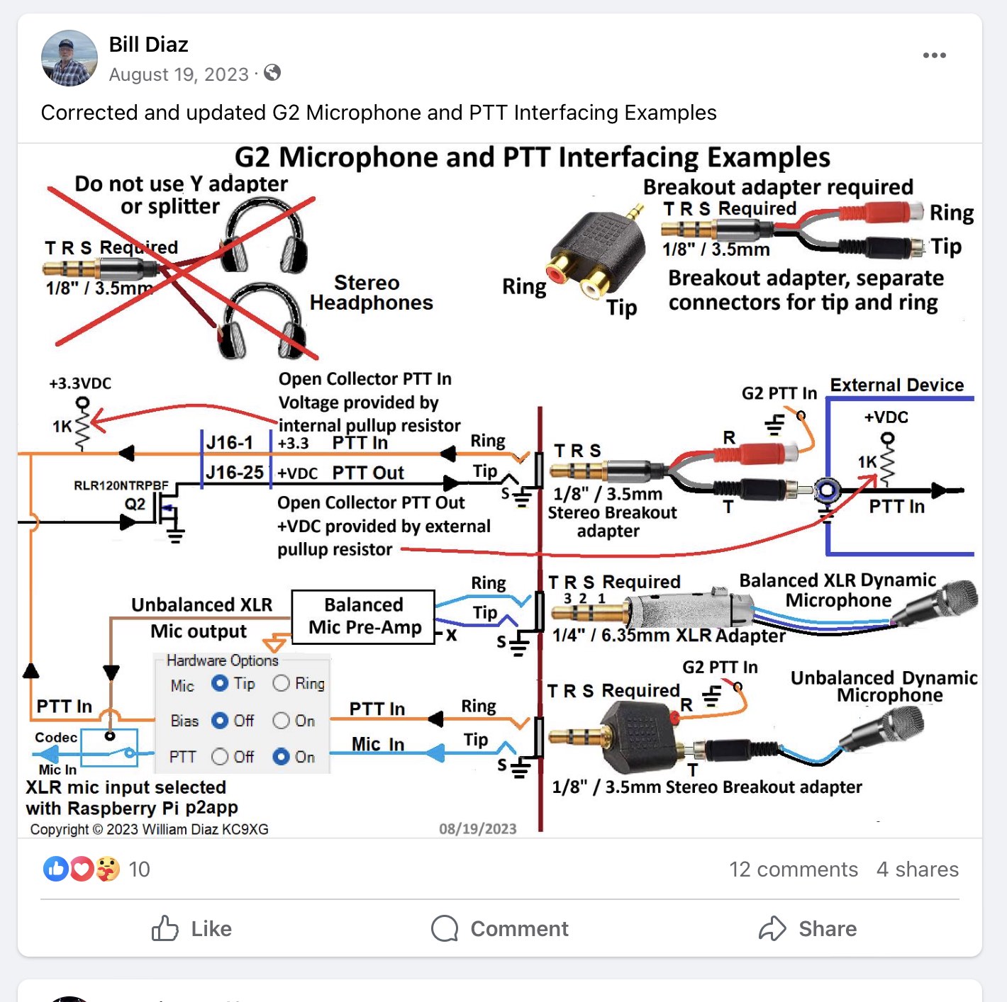

As a new G2 owner, I am about to attempt to hook up my HEIL PRO-7 dynamic headset (Mic and Headphones) to the G2's rear MIC port which is 1/8" or 3.5mm.
Looking at the Mic Jack on the PRO 7, it is a simple 3.5mm TS plug. Bill Diaz posted a G2 Microphone Examples diagram and as I understand that I need a 3.5mm TRS Stereo Breakout Adaptor with the T and S of the PRO 7 going to the TS of the adapter.
Then, I need to ground the other female port of the TRS Breakout adaptor such that the R (ring) is going to ground.
So to that end I did make up such a breakout adaptor.
Looking at Bill's example, (I have attached it below) where should I attach the ground wire to the G2? I could go to the rear ground wing-nut on the radio.
If any of you have integrated a PRO 7 to the G2 I would be greatly appreciative to hear from you.
Thanks 73
Art W1SWL
G2 MIC and Headphone Connections.jpg (347.41 KiB) Viewed 6374 times

Yes, but...to make things easy you are probably better off buying an adapter that provides a 3.5mm plug or jack for every connector. Something like this:
https://www.amazon.com/Gold-Plated-Connector-Splitter-RFAdapter-Headphone/dp/B096XNHTH3
With that adapter the mic of the Pro-7 will connect to the left (red) side, and a PTT switch will connect to the right (white) side.
Yes, for an external PTT switch. Ring grounded = transmit. Ring floating = receive.
Good on ya'! So many hams don't seem to be able to make cables these days :)
You haven't described your adapter, but if it is based on a standard, store-bought adapter as shown in Bill's illustration, or as I suggested above, then ground will appear on the shield of the PTT side connector of the adapter so all you need to do is short the shield and the tip there and the radio will go into transmit.
Don't forget to go into Thetis > Setup > H/W Select and set Mic = Tip, Bias = Off, PTT = On.

Thanks for that last tip.... pun intended... I did not check the PTT and was not getting any power out. Thanks for that.
