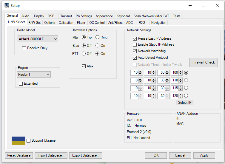

I connected the Hand microphone to Annan, it works fine with PTT KEYBOARD and MOX , but when I switch on PTT rear panel it's switch ptt but no modulation, any idea?

Postby 4L5O » Wed Jun 14, 2023 4:21 pm
4L5O wrote:I connected the Hand microphone to Annan, it works fine with PTT KEYBOARD and MOX , but when I switch on PTT rear panel it's switch ptt but no modulation, any idea?
You microphone is wired so that when the hardware PTT input is grounded so is your microphone element.
You have violated "rule 1" in the first post above.
Rewire your mic in accordance with the mic input pinout. Shield = ground. Mic signal and PTT signal must be separated onto tip and ring, or ring and tip, depending on the setting in General > H/W Select > Hardware Options > Mic. Internal wiring inside the mic must also keep mic and PTT signals separate.
Thank you for your replay, i have this settings, see photo
Re: Trouble with your microphone? Read this...
Postby w-u-2-o » Wed Jun 14, 2023 6:12 pm
That's nice. It's not relevant to your improper mic wiring.

I have a 3.5mm jack to stereo RCA splitter in the PTT IN/OUT on the back of the rig, one RCA goes to my Amplifier and the other goes to my PTT box.
Before I press the FIRE button, lol. I just wanted to make sure this all sounds legit. Fell free to ask any questions if I haven't given enough info.
Thanks in advance for any info.
73 Rich
Postby w-u-2-o » Mon Nov 04, 2024 2:05 pm
Rich--that should all work fine. However, be aware that not everyone has had good success with the balanced mic input. If you wind up having problems with that specific input I recommend you post in the G2 sub-forum here.
Postby W1SPS » Mon Nov 04, 2024 3:28 pm
Thanks for the heads up. If I have an issue with the XLR I'll try something else. I have a Focusrite Solo with Voicemeeter banana on the computer because at some point I wanted to be able to process my audio. For now I just want to get the thing working then ease into the complicated stuff.
Postby w-u-2-o » Tue Nov 05, 2024 3:05 pm
Rich--if you are still having problems, please start a NEW topic in the G2 sub-forum: viewforum.php?f=48
