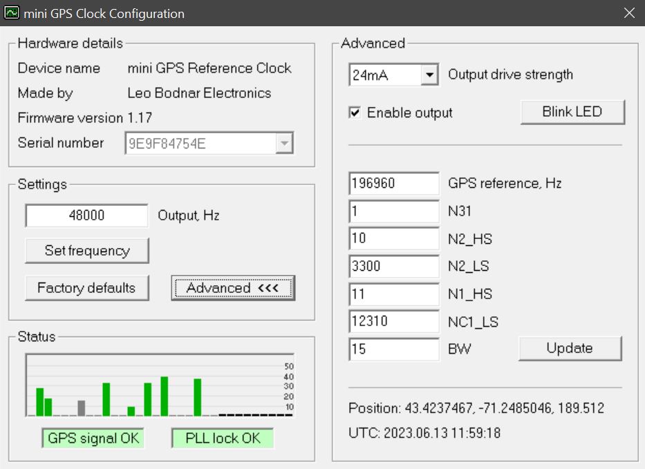

Postby w-u-2-o » Tue Jun 13, 2023 12:00 pm
These are the settings I'm using with my Leo Bodnar MiniGPS to drive my Presonus Studio 192 Mobile:
