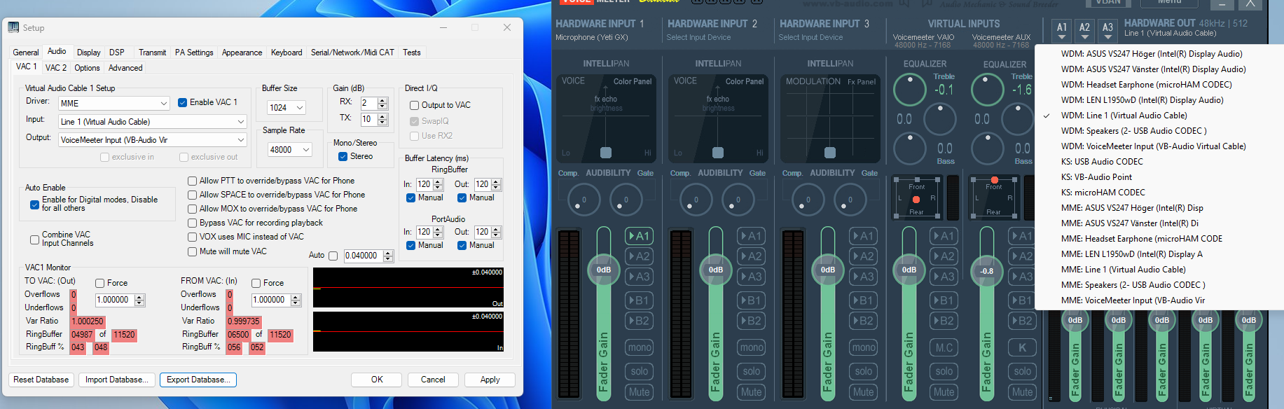

Ok Scott here are my settings using the USB mic on VM Hardware Input 1. Audio TX is fine besides the short delay. So if I activate ASIO in Thetis VAC 1 setup then what should the settings be in VM Banana?
73/Sam
73/Sam
- Thetis audio.png (276.79 KiB) Viewed 19937 times
Re: USB mics straight into PC
SM3PZG wrote:Ok Scott here are my settings using the USB mic on VM Hardware Input 1.
You may have misunderstood. Please show the VAC settings for the USB microphone directly into Thetis that are not working for you.
Again, take a look at this thread: viewtopic.php?f=13&t=5046&p=29266

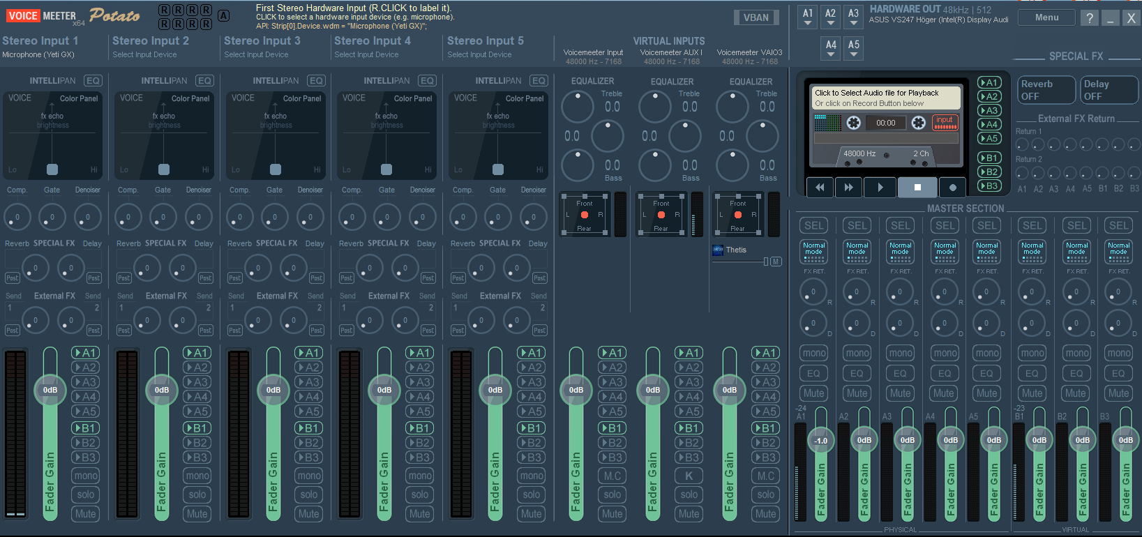

Ok so I uninstalled VAC and VM Banana and installed VM Potato. So now selecting ASIO in Thetis VAC 1 setup I get RX audio to VM Potato. I can then feed that RX audio for example to my PC speakers. The USB mic is on VM Stereo input 1 and I can also direct audio from USB mic to PC speakers. But how do I get USB mic audio to input in Thetis VAC1? Thetis also shows up in VM VAIO3
Just cant wrap my head around the audio path from USB mic to Thetis VAC.
UPDATE: In VM Hardware output A1 ASIO (Steinberg) is empty.
73/Sam
73/Sam
- Setup.png (58.44 KiB) Viewed 19903 times
- Potato.png (191.89 KiB) Viewed 19903 times

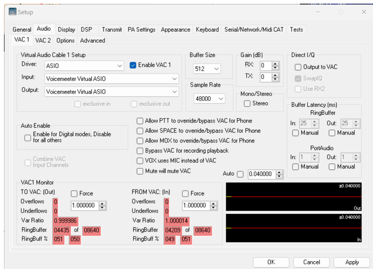

So I selected Voicemeeter Virtual ASIO on both input and output in Thetis VAC 1 setup and now USB mic audio is coming ok with much less latency.
Thanks Scott.
73/Sam
Thanks Scott.
73/Sam
SM3PZG wrote:Ok so I uninstalled VAC and VM Banana and installed VM Potato. So now selecting ASIO in Thetis VAC 1 setup I get RX audio to VM Potato. I can then feed that RX audio for example to my PC speakers. The USB mic is on VM Stereo input 1 and I can also direct audio from USB mic to PC speakers. But how do I get USB mic audio to input in Thetis VAC1? Thetis also shows up in VM VAIO3
It is well described in the other thread...
Good job. I had noticed that discrepancy in your screen shots, i.e. the mismatched Thetis VAC input and output settings.
Some other guidance for you:
1. In Thetis VAC setup, disable "Auto Enable" and set RX and TX gains to 0dB. You shouldn't need the extra gain.
2. You only need two send buttons (the A1 through B3 buttons) to be selected on:
- the B1 send button on channel 1 to send the mic audio to the Thetis virtual channel
- the A1 send button on the Thetis virtual channel (channel B1) to send receive audio to your PC speakers.
3. Save a TX profile in Thetis with these settings. All VAC settings are saved in the TX profile. Also, Voicemeeter will remember your last used settings so unless you change something it should be ready to go whenever you start Voicemeeter.
One last thought: you don't need Voicemeeter. You can go directly to the USB mic from Thetis if you wish. But Voicemeeter does have some nice features.

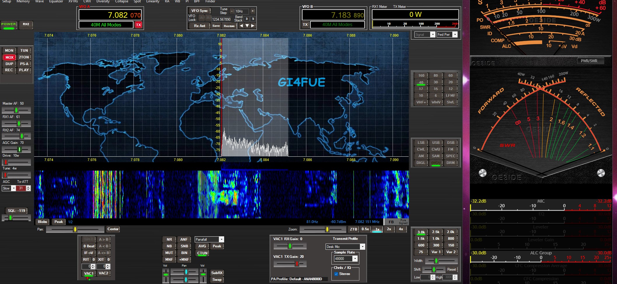

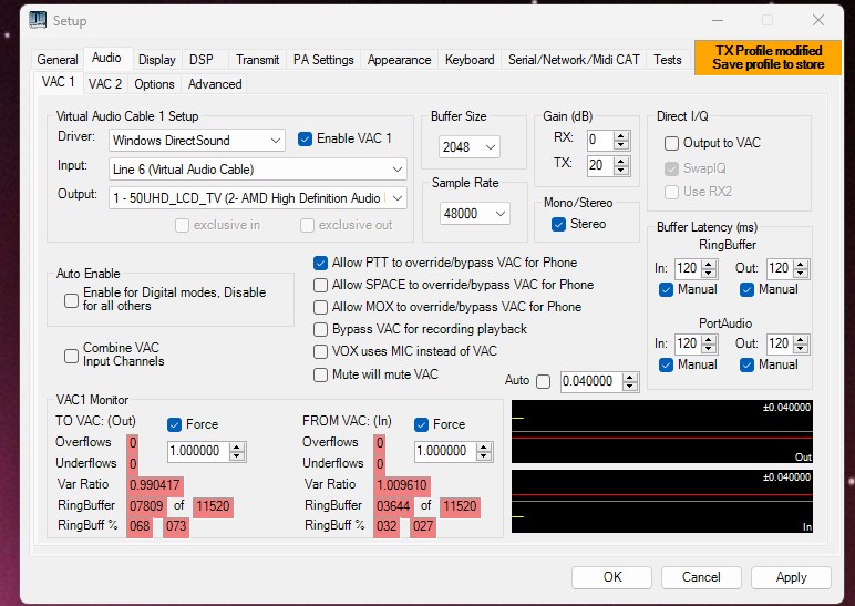

Hi Guys
I am experiencing exactly the same issue, I have a USB mic plugged in to my pc, but now audio being passed through to thetis using either MME or windows direct sound. I have JTDX working fine Via Voicemeeter potato, but I sorta stumbled on to making it work! I find Voicemeeter extremely confusing, jus cant seem to get my head around it at all. Could not get the mic to work using the voicemeeter virtual ASIO drivers. I tried 2 different USB mics, both of which work fine on my Hermes Lite, but refuses to cooperate on the Anan 8000. Screenshot attached
Any help would be appreciated
Charlie GI4FUE
Charlie GI4FUE
This has nothing to do with which USB mic you are using. You could use 10 of them and the results would be the same. The problem is with your Voicemeeter and Thetis setup.
You say it all works with Hermes. Are you using the same copy of Thetis to run both the Hermes and the 8000? If not, then perhaps you might copy all of your Voicemeeter and Thetis settings from the Hermes setup to the 8000.
In your screen shot, there is no evidence you are using either a direct connection to the USB mic or that you are using Voicemeeter. The input setting of "Line 6 (Virtual Audio Cable)" is evidence that you are using Muzychenko VAC.

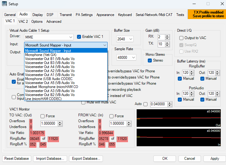

For a USB mic you don't need to use either Voicemeeter or Muzy VAC. Simply select the USB mic as the input in the Thetis VAC setup window. Start with this. Once you get that working then you can think about routing the mic and digi mode app's through Voicemeeter for convenience. But one thing at a time.
There are a million YouTube videos on how to use Voicemeeter (although not necessarily with Thetis).

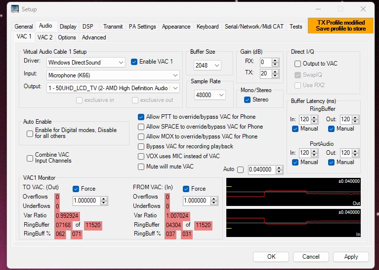

Hi Scott
Sorry, that was the wrong screenshot. I have it set up like this screenshot.
I am using PTT from mic socket on front of the Anan, thetis version is different from the hermes...the hermes version is using MI0BOT's software. When I enable PTT, thetis goes to tx i get this
I am using Thetis 2.10.3.6 rc1, firmware is 2.1.18
Charlie
Charlie

Just an update. I have now got audio out by using MOX instead of Mic PTT. I presume that is to do with the way Anan handles PTT. Is there a way to enable PTT without having to hit the MOX button every time?
Charlie
Charlie
Hi Charlie, try unchecking the mic over riding vac on PTT checkbox
Hey Cowboy
That did the trick!...now i need a tutorial on getting Voicemeeter potato to control everything, including the studio mic on a UMC202. I tried it with cmASIO, it worked but it would be handy for voicemeeter to handle all the audio routing, including the headset plugged into the mic/headphones socket
73, Charlie
73, Charlie
Hi Charlie, Scott did a nice tutorial which I used http://wu2o.dyndns.org/wu2o_vac_tutorial_2.html I could maybe do a teamviewer session with you sometime if you get stuck ?
