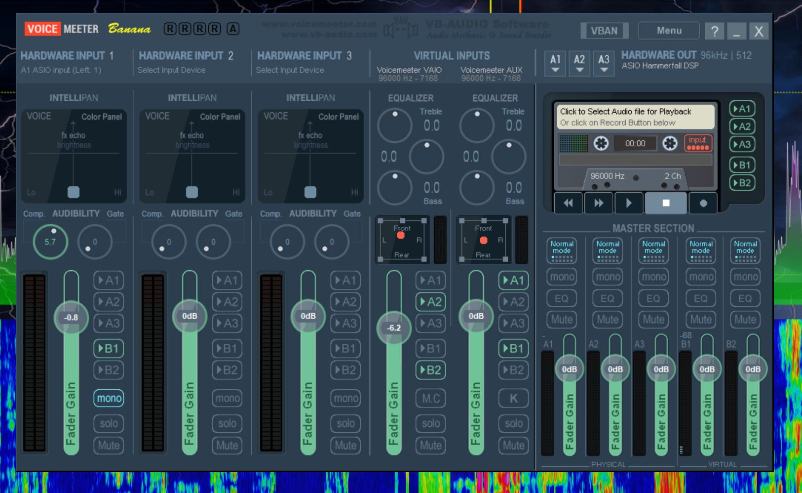

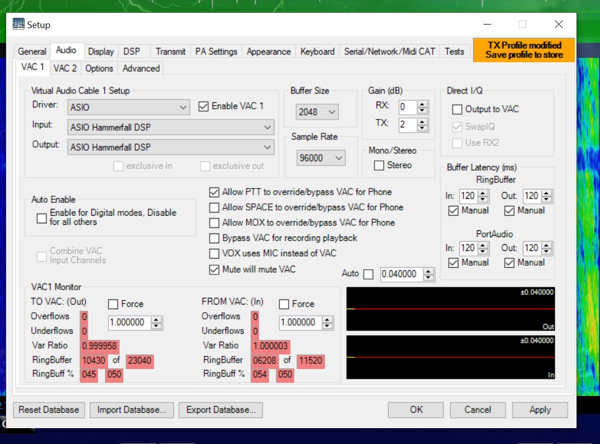

These are the settings that work for me. I enable HW input 1 B1 button when I want to input an audio signal in my mic for SSB ops. Else, for WSJT-X work I deselect it. Mic plugs into the Windows 10 PC via USB plug.
Only cable connecting the PC to the ANAN G2 is the 25ft. UTP CAT6 4PR 24AWG Network cable.
For CW ops, I plug my Iambic key into the ANAN G2 and also plug an external speaker into the G2 so that I can hear my own keying.
Hope that helps.

thank you for the screenshot. This is a good solution and I will try to set it up. But. I see that you don't use any DAW, you just connect the microphone to your computer. I have a DAW and the settings will be slightly different. I guess we will still have to send the signal using virtual cables? There's some fun with this setup. Maybe we'll be able to do something tomorrow.

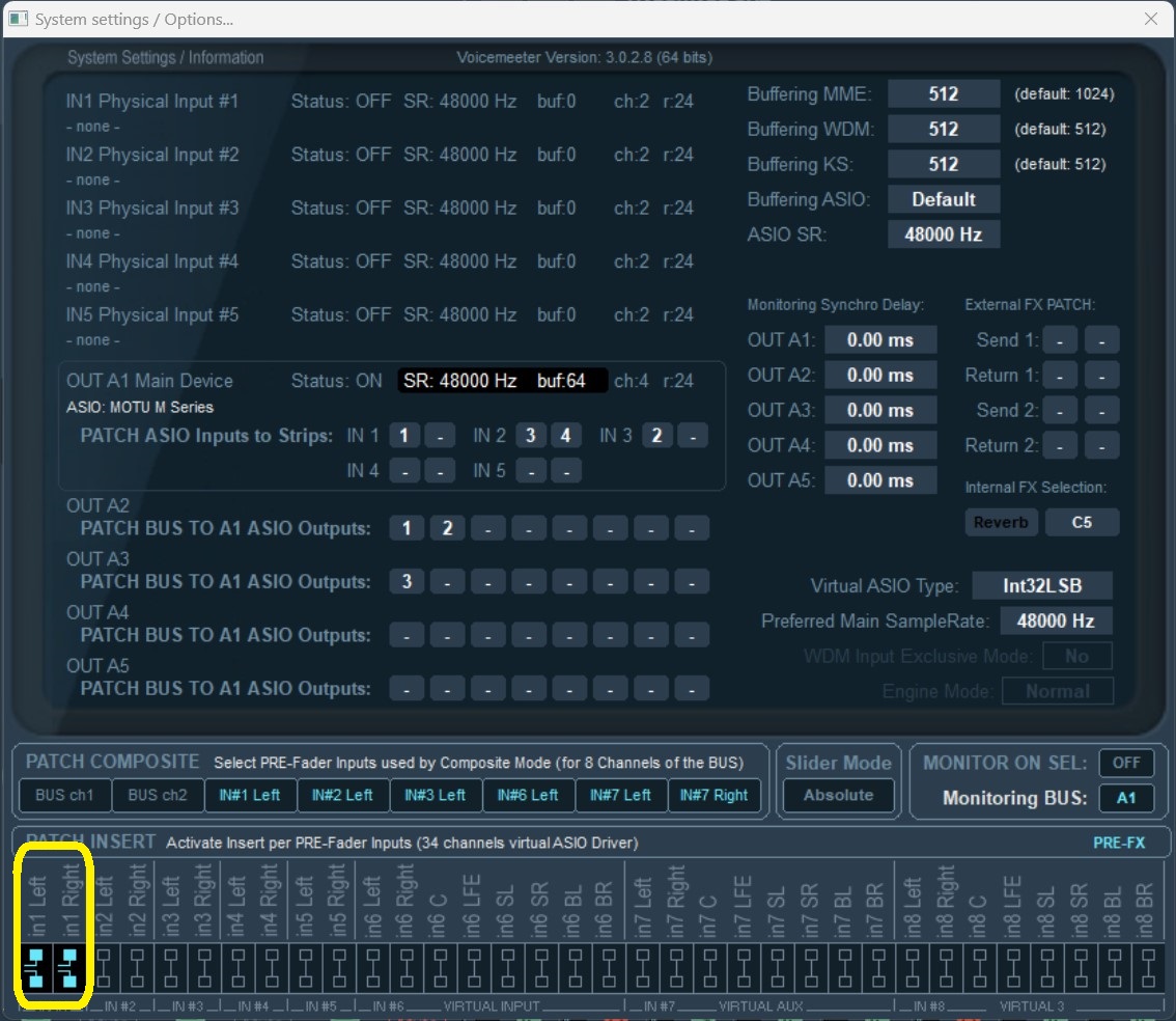

There is a way to "side chain" the audio from Voicemeeter into your DAW by pointing to the "Voicemeeter Insert Virtual ASIO" device in your DAW. That device is enabled in the Voicemeeter System Settings screen:
Re: DAW - Anan connection via VoiceMeeter Banana
Postby w-u-2-o » Tue Jan 30, 2024 11:25 pm
Here is an example of what Mark is talking about. What DAW are you using?

If you've got Thetis and Voicemeeter working with an audio card then I can't provide a better explanation that the one in the Voicemeeter/Audition video. Basically you need to use the patch insert feature to send audio to Audition from Voicemeeter and then receive it back into Voicemeeter from Audition. Voicemeeter becomes just a glorified patch panel at that point.
You might try this relatively new product from VB Audio: https://vb-audio.com/Matrix/
I've not tried Matrix yet, but it is literally an ASIO-capable audio patch panel. That might be more easily understandable for you.
