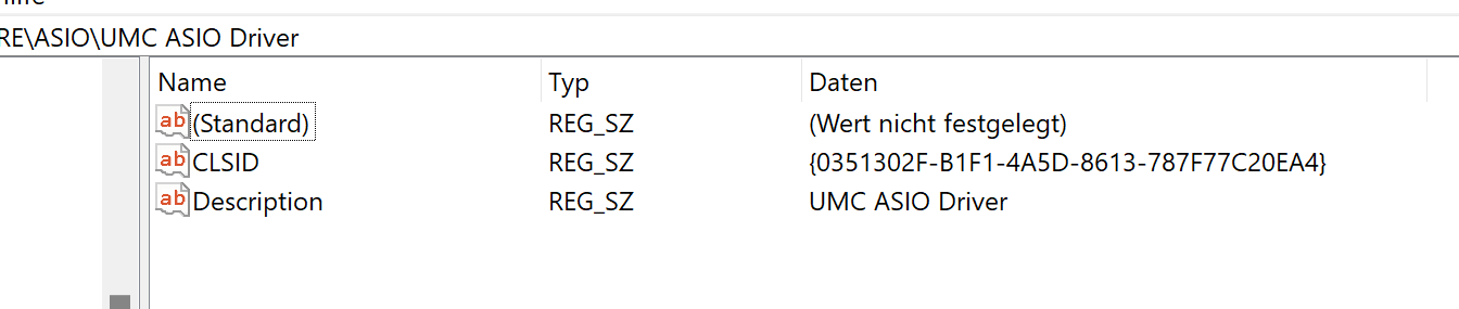

So far, so good. What's in your registry?

forgot to send you the registry entries. Here they are:
[img] [/img]
[img] [/img]
- Screenshot 2024-11-10 131351.png (21.02 KiB) Viewed 18848 times
