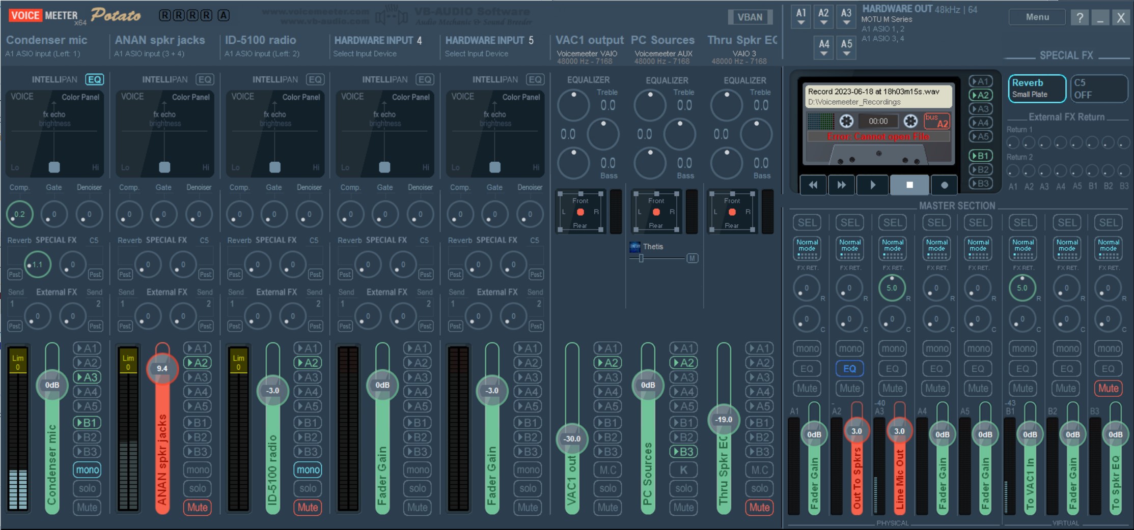

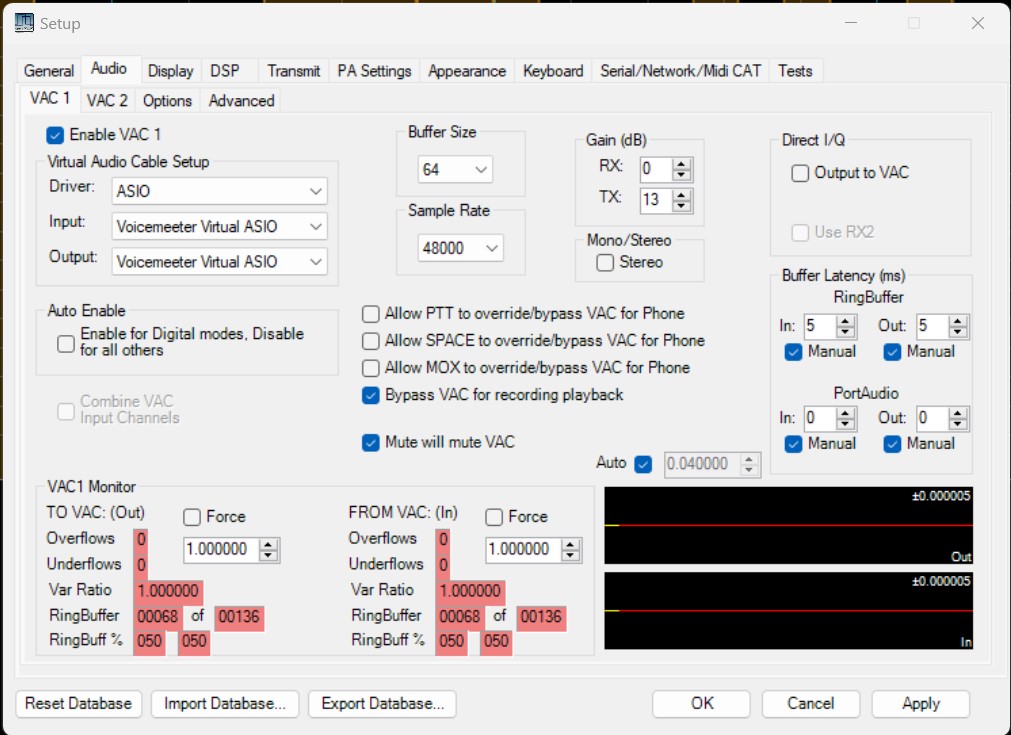

Postby K1LSB » Sun Dec 10, 2023 10:35 pm
I'm struggling to get mic audio from VM Potato into Thetis for TX. How can I get my condenser mic audio from Voicemeeter Hardware Input #1 into Thetis without using VAC1?
Screenshots attached
VM Potato.jpg (423.46 KiB) Viewed 66687 times
Audio VAC1.jpg (148.63 KiB) Viewed 66687 times

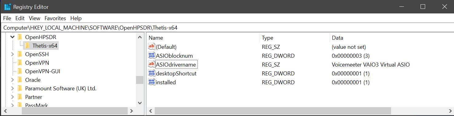

Postby w-u-2-o » Mon Dec 11, 2023 2:08 pm
K1LSB wrote:I'm struggling to get mic audio from VM Potato into Thetis for TX. How can I get my condenser mic audio from Voicemeeter Hardware Input #1 into Thetis without using VAC1?
Make sure you are running Thetis 2.10.3.5 pre-release 3 (or newer). Then...
1. Quit Thetis.
2. Run regedit.
3. In regedit look at Computer\HKEY_LOCAL_MACHINE\SOFTWARE\ASIO
4. Check that you have an entry called Voicemeeter Virtual ASIO.
5. In regedit look at Computer\HKEY_LOCAL_MACHINE\SOFTWARE\OpenHPSDR\Thetis-x64
6. Right click in the right hand pane of regedit and select New > String Value. Name it "ASIOdrivername" (case sensitive, without the quotes).
7. Double click the new string value ASIOdrivername and give it a value of "Voicemeeter Virtual ASIO" (case sensitive, without the quotes).
It should look like this when you are done (you don't need an entry for "ASIOblocknum", that's just me fooling around):
8. Close regedit.
9. Start Thetis.
10. Disable VAC.
At this point you should find audio from Thetis on Voicemeeter channel B1. Any audio sent to Voicemeeter channel B1 will be used for transmit.

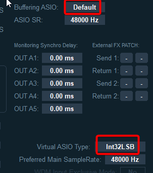

Postby oe3ide » Mon Dec 11, 2023 9:13 pm
For everyone who wants to use VM Asio drivers, the 2 settings on the screenshot are important (thanks to Richie for that information)
The driver names for Voicemeeter are:
B1: "Voicemeeter Virtual ASIO"
B2: "Voicemeeter AUX Virtual ASIO"
B3: "Voicemeeter VAIO3 Virtual ASIO"
73 de Ernst, OE3IDE

Postby G3ZQH » Mon Dec 11, 2023 11:26 pm
oe3ide wrote:For everyone who wants to use VM Asio drivers, the 2 settings on the screenshot are important (thanks to Richie for that information)
73 de Ernst, OE3IDE
Now I'm progressing (thanks to Ernst and Scott)! I have SSB PC audio (headset) using these cmASIO settings for Voicemeeter but I cannot connect to JTDX or WSJT-X for digimodes. Will explore further tomorrow.
I'll be very happy to have a more stable audio link since I have always had problems with running VAC in Thetis.
73 Dave
