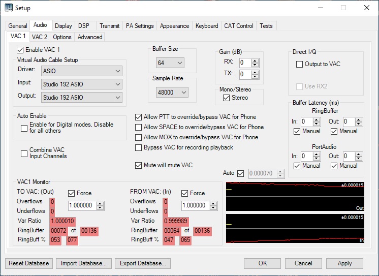

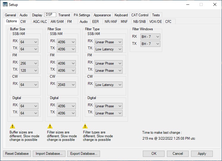

The attached audio .WAV file demonstrates Thetis' CW QSK ability when using low-latency ASIO audio drivers. The audio clip begins with my ID on the 80m band. Shortly thereafter, I inject a carrier to simulate another station on the band. Then, the keyer speed slowly increases from 15 WPM to 50 WPM. Notice that at all speed settings the carrier and band noise is easily heard in between keyed CW elements. Try that test at 50 WPM with any other transceiver including those made by Flex or Elecraft. What does this say about ANAN's "thick wire" disadvantage?
The .WAV file sounds noisy because it's digitally compressed. I didn't take the time to optimize it. The Apache message board wouldn't allow an upload of the original uncompressed file size. Nevertheless, the point is to demonstrate Thetis' fast QSK ability. Also attached are screen captures of the settings that produce this result.

Phil,
First, until you have ASIO audio capability, the settings shown will result in horrid CW performance whether in QSK or semi-break-in modes. If you've not read through the forum discussions, that would be a good place to start. In addition to the setup screens shown above, the CW settings under <General><Options><Options-1> also have an impact on CW performance. Since I only operate QSK, it would be worthwhile to ask for Thetis setup screen captures from other CW ops who are currently using Thetis and ANAN models with the Orion MKII board.
Another important caveat to the achieved result is that my ANAN 7000's T/R relay was replaced with a fast RF reed relay with make-break times of 1 ms. That, together with ASIO, a dual-port GPSDO, audio interface with Wordclock, and the Thetis settings shown all contribute to the overall QSK experience. Getting there was an incremental process.

w9ac wrote:The attached audio .WAV file demonstrates Thetis' CW QSK ability when using low-latency ASIO audio drivers.
Hi Paul,
Those are very low ring-buffer settings shown in your VAC1 screenshot above. Even with the Studio 192 wordclock synched coherently with the radio, that's a nice trick. How long can you run like that without accumulating ring-buffer events? If you are getting events, are they occurring as singletons or in clusters?
73, Bryan W4WMT
Re: QSK with Thetis
W4WMT wrote:Those are very low ring-buffer settings shown in your VAC1 screenshot above. Even with the Studio 192 wordclock synched coherently with the radio, that's a nice trick. How long can you run like that without accumulating ring-buffer events? If you are getting events, are they occurring as singletons or in clusters?
73, Bryan W4WMT
Typically, the over/underflow count is stable until some other PC application starts or terminates. The biggest offender is my web browser. When it opens, a cluster of perhaps 50 flow counts occur. Thereafter, its stable again. At most, I hear a short glitch.
Within Thetis, if the profile is changed on the fly with VAC enabled, several things require rebooting, sometimes the PC. No issues as long as the profile change occurs with VAC disabled, then reenabled. With the PC left running alone without application interrupts, the counters will stay near 0 for a long time.
