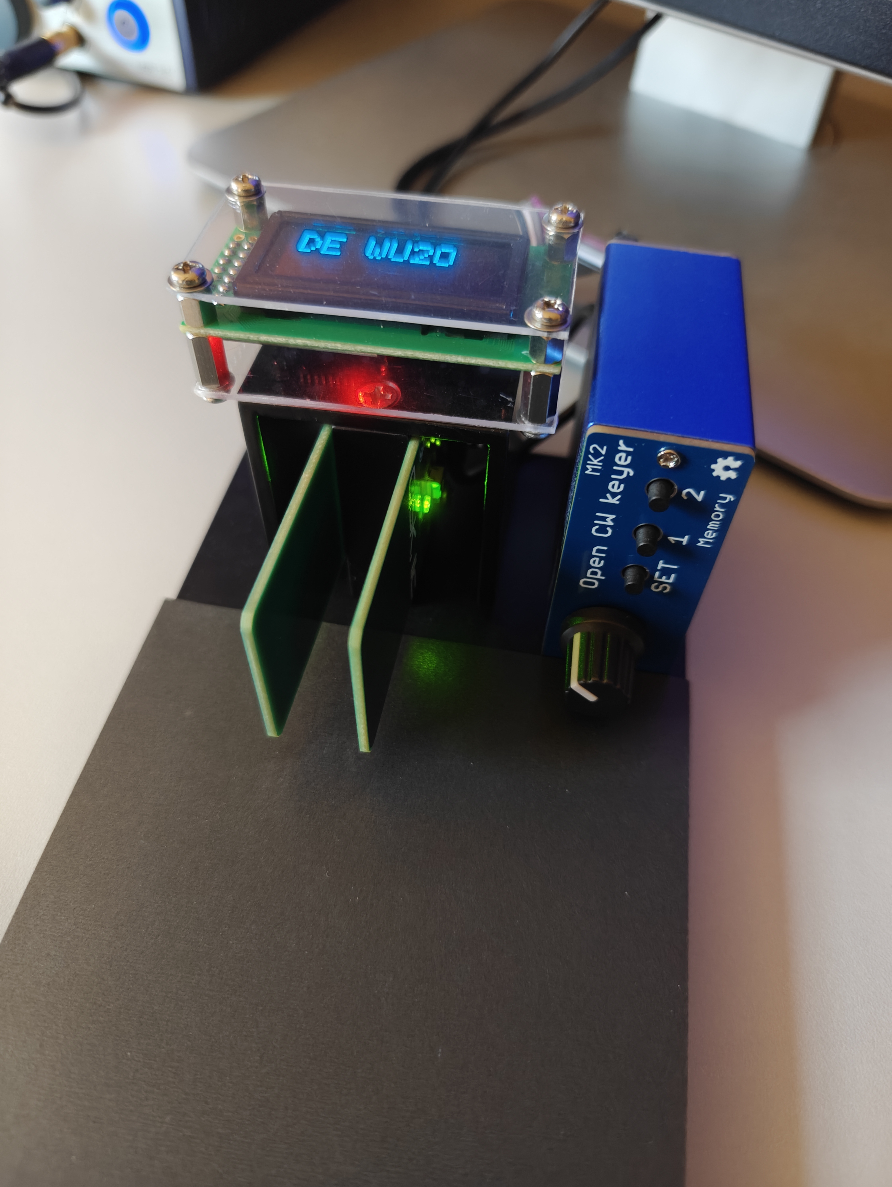

This topic is quite old. FWIW, now that I've started to dabble in CW myself, I've found the QSK sidetone mechanism to have too much latency. My solution is to use an external keyer with built-in sidetone generator. I bought an OpenCWKeyer MK2. It is possibly the perfect keyer for ANAN/Thetis users as, like our radios and software, it is completely open source. The hardware design is on Github, and it runs the impressive K3NG software, also on Git.
I quickly tricked out my keyer by upgrading the Arduino Nano it came with to the more powerful Arduino Nano Every. The Every has enough memory to add the display, USB serial control, and Winkeyer functions. I also added a cute little 8x2 OLED display.

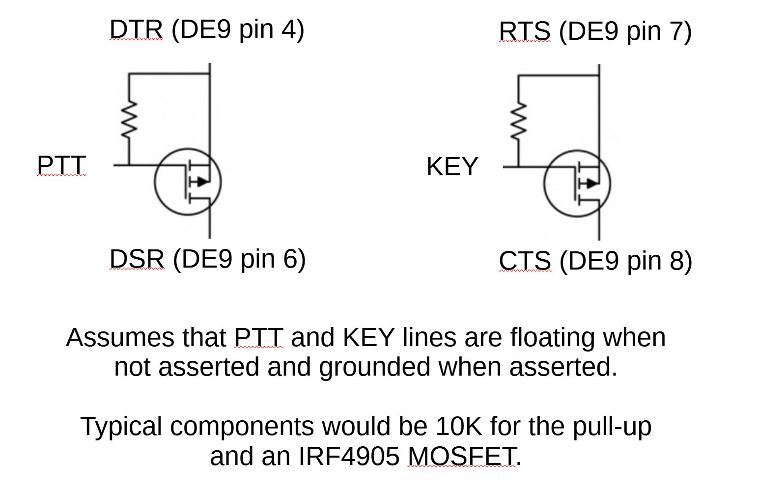

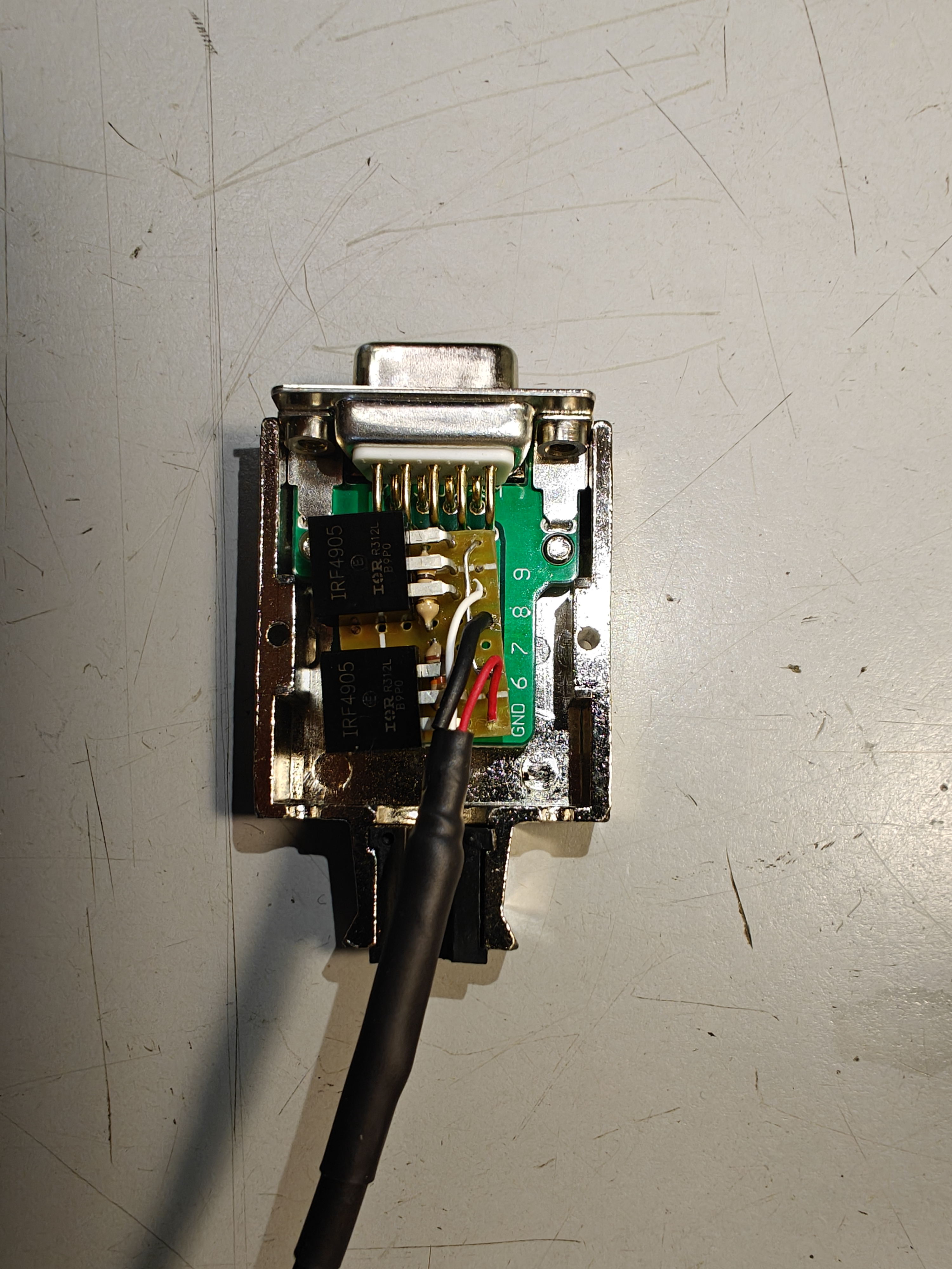

As described in the very first post in this topic (above), you want to take the key and PTT outputs of the Winkeyer and connect them to a serial port on the Thetis PC. Do not confuse this with the USB connection that already exists. And, as described above, go into Thetis > Setup > DSP > CW and setup that serial port.
However, I did run into one issue when I did this with the OpenCWKeyer. If you have a key or keyer that is literally just a dry switch or relay type contact then making simple connections to the Thetis remote key serial port is straightforward. However, it seems most keyers are using opto-isolated outputs that are floating when unkeyed and grounded when keyed. To solve this issue I built the following circuit:
I was able to build this into a DE9 breakout style connector housing by removing the screw terminals and adding a small stripboard assembly. I recommend using something with a metal backshell. The cable is simply a 3.5mm shielded stereo audio cable with one end cut off for the DE9 side.

Postby Michael » Tue Nov 12, 2024 8:58 am
Great, Scott - I overlooked this and it is exactly what I was looking for. I will build something similar.

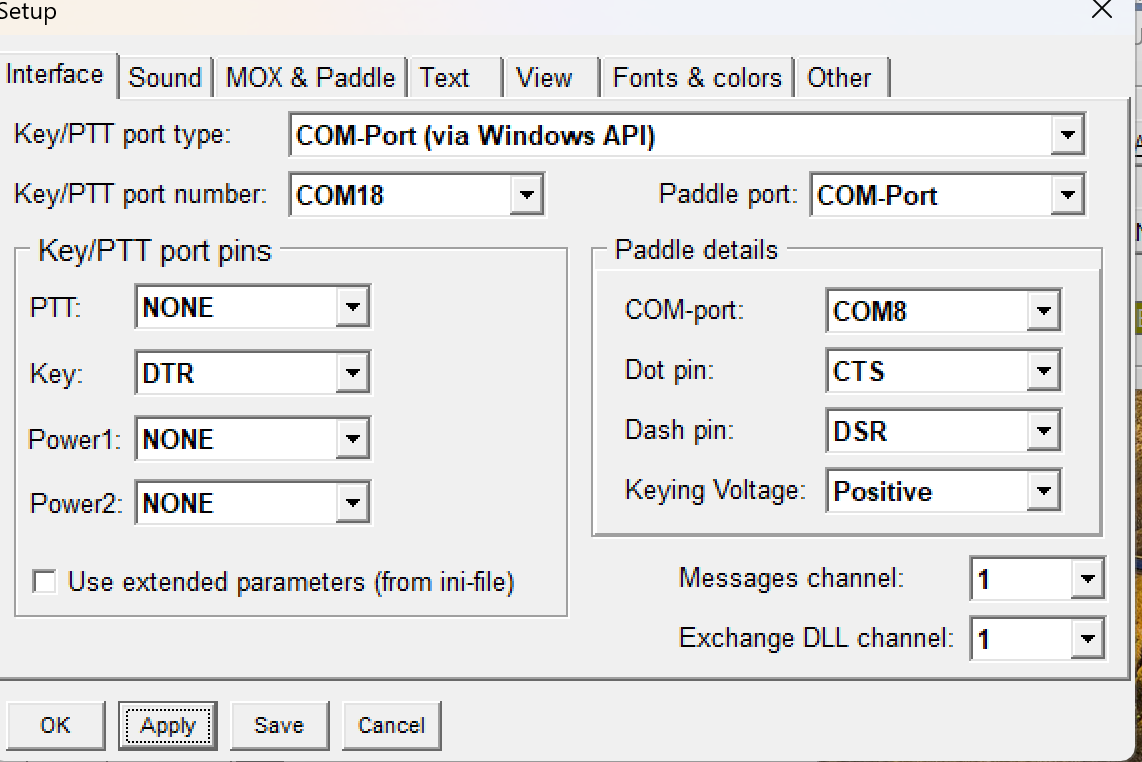

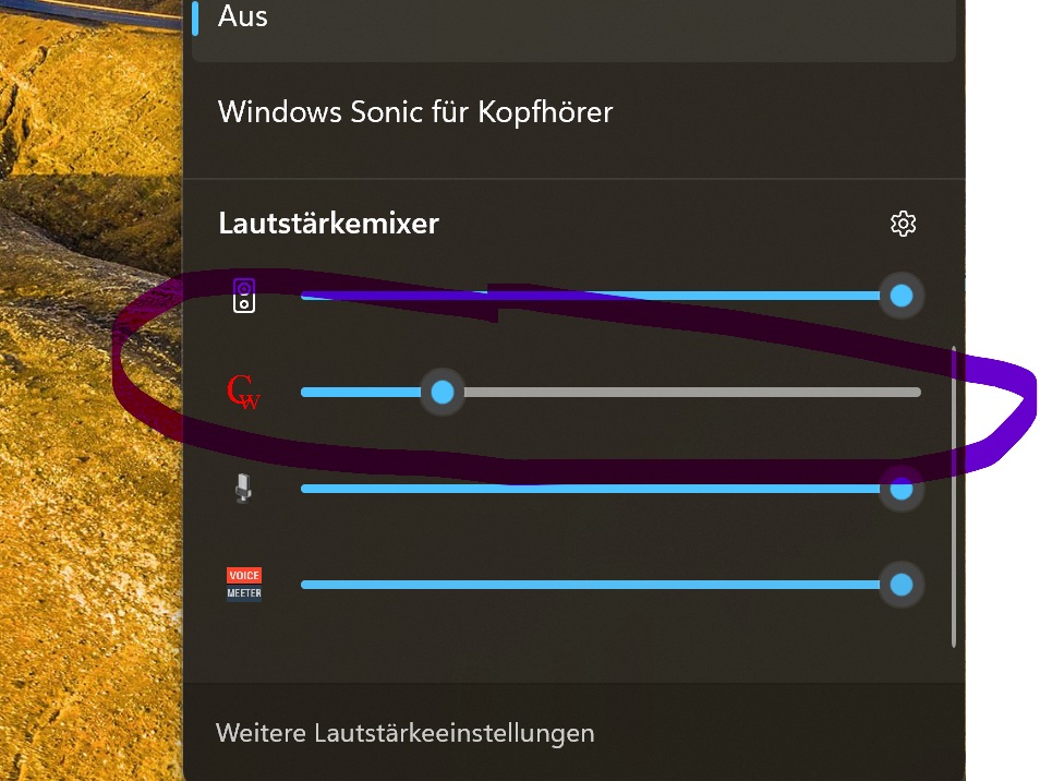

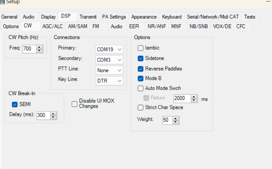

btw, Scott, I am not quite sure why but now I get a dedicated mixer for CWType which let me regulate separately the sidetone volume. Maybe related to the fact that I am not using cmASIO but only ASIO with Voicemeeter Virtual ASIO now.
Here screenshots of my setting:
Screenshot 2024-11-27 164307.png (773.5 KiB) Viewed 64546 times
Screenshot 2024-11-27 163535.png (111.56 KiB) Viewed 64546 times
Screenshot 2024-11-27 163343.png (55.18 KiB) Viewed 64546 times
- com18 and com19 is the virtual com pair.
- com8 is the usb/rs232 adapter with the paddles connected (pin 4,6,8)
- com3 is a virtual port which is used by N1MM+ (DTR=CW, RTS Always off)
73, Michael

cmASIO or ASIO should have no bearing on whether or not Windows mixer shows a control for CWType. I use cmASIO and run all my Windows sound through my Presonus ASIO interface and I get the control in Windows mixer, no fuss, no muss.
What you have done is exactly what I was trying to do. For reasons unknown I cannot get CWType to see the paddle, whereas Thetis sees it fine (albeit only one side at a time, or via Open CW Keyer hardware). For this reason I know the cable, interface circuit and serial port are good. It must be some sort of incompatible driver. CWType is a very old program that has never been updated.
