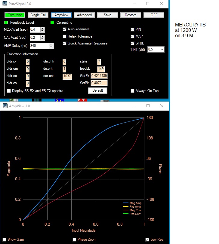

My experience with ANAN 7000 and Mercury IIIS (A factory built one) :
The Mercury won't turn on LDMOS bias until it sees RF and if pure signal doesn't have some delay before it starts working, it gets
confused over lack of RF out during the time that it knows it is transmitting. It seems to take about 5 msec of RF before bias comes on.
To keep PS off at initial key up, I added 0.4 sec of delay in the MOX Wait time in the Linearity window. However, unless your audio system has a bit of a click at PTT activation to put out a few watts during that MOX wait time, you do have to start talking right after keying to get the bias going, else the MOX delay won't help.

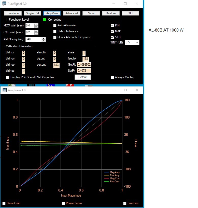

I also had to check the STBL box. Not sure what STBL does, but without it, the Amp view showed intermittent amp gain/phase that I never saw when using my AL-80B.
At full 1200W out, the Pure Signal is really working hard to fix distortion, you can see the "Baluga whale" pattern as compared to my AL-80B at its rated 1000W.

w4bf wrote:My experience with ANAN 7000 and Mercury IIIS (A factory built one) :
That's great info! I wonder if the Mercury LUX is the same way?
If you want to learn what STBL and the other options do, there is a lot of of good information here: https://community.apache-labs.com/viewtopic.php?f=20&t=3166
Wow, that's really pretty bad. It doesn't seem like the Mercury IIIS is truly a 1200W amplifier. One would expect that an amp, a linear amp, that is rated for X Watts ought to deliver that much power linearly. At 1200W that amp is well into compression, and seemingly well past even the 1dB compression point. You can tell because the amp (blue) curve bends over toward the horizontal right around the 0.7 input/0.9 output level. It's more like a 1000W linear amplifier.
Note that the scales on the AmpView plot are linear and not logarithmic, it is not displaying power in decibels.
