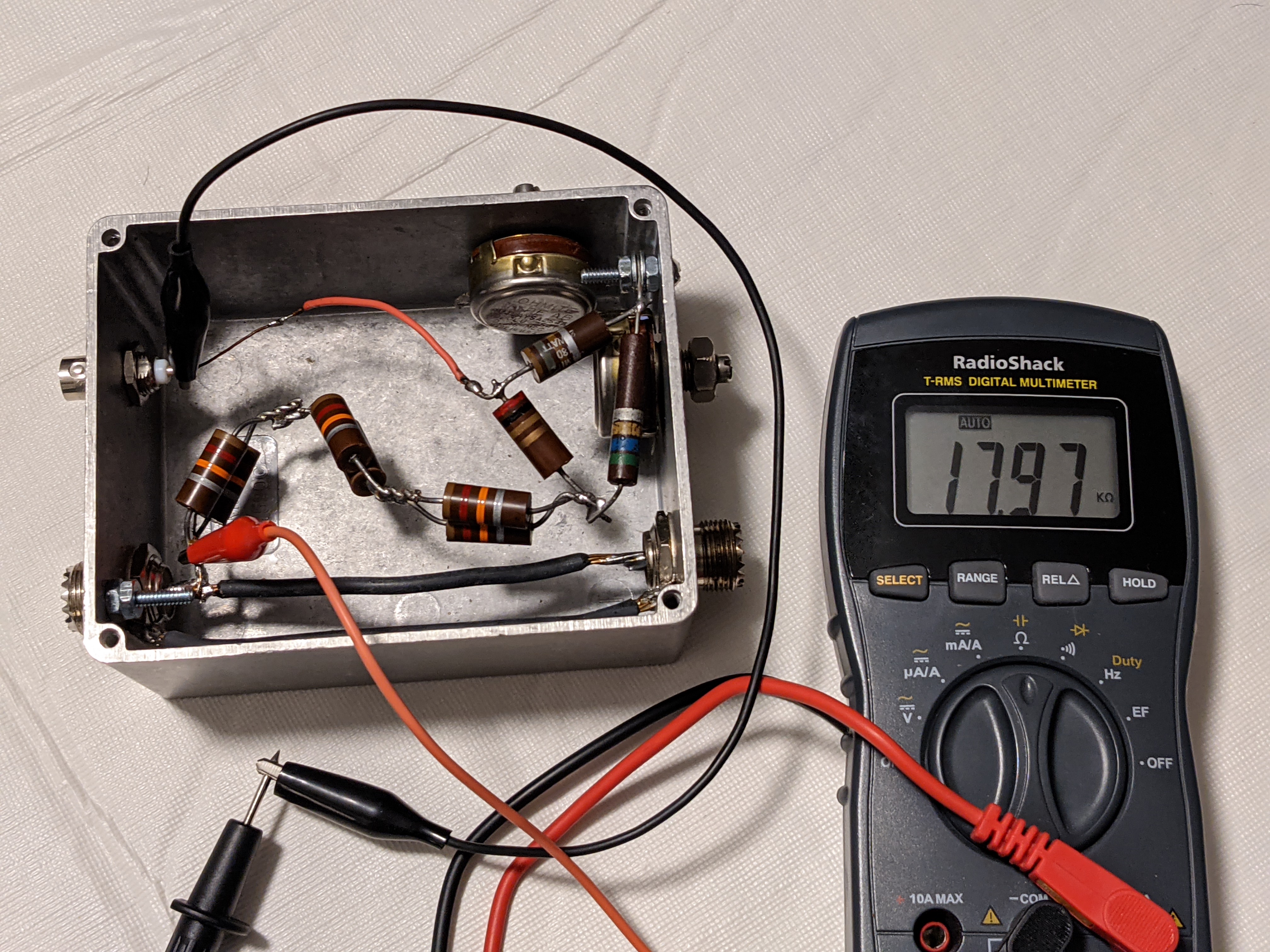

There are any number of market products available, none of which interested me so I built my own 18K-ohm pure resistive sampler that connects directly to the SO-239 jack on the back of my amp.
Disregard the jumble of ancillary resistors and variable pots in the picture, that box was a prototype. The final circuit consists of the six 2-watt Allen Bradley 12K-ohm carbon composition resistors in a series/parallel arrangement that provide 18K-ohm of measured resistance. That arrangement allows PureSignal to function correctly at any power level from a barefoot 25 watts to full legal maximum power.
