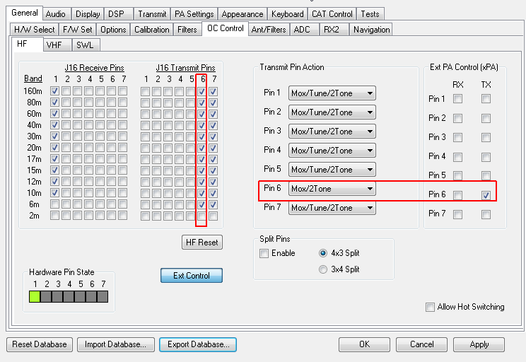

Just use an OC Pin for keying the AMP with this configuration:
Tune w.o. PA.png (27.35 KiB) Viewed 12618 times

Just wanted to let everyone know you can control the MFJ-998 from the OC outputs. The tuner side is an ethernet plug. If you put the tuner in Kenwood mode and pull the right 2 wires to ground, and send tuning power, the tuner will run a tune cycle. Easy peasy. I forgot to write down the pins, but it was the blue and brown wires.

rdwing wrote:Just wanted to let everyone know you can control the MFJ-998 from the OC outputs. The tuner side is an ethernet plug. If you put the tuner in Kenwood mode and pull the right 2 wires to ground, and send tuning power, the tuner will run a tune cycle. Easy peasy. I forgot to write down the pins, but it was the blue and brown wires.
My issue is that I am using OC pins 104 to send band data to an am, ALS-1306.
I don't think I can use the MOX/TUNE/2TONE transmit selections to pull pins 5,6 or 7 to ground and use the OC pins for band data to the amp at the same time, unless I am mistaken, and I very well might be, I am operating at or above my current understanding of how this stuff works and there is little to no documentation that I can find on how the OC pins work but obviously the band data pins 1-4 work, but the transmit pins are all the default value MOX/TUNe/2Tone and they do nothing at the moment. maybe I am missing something.
Nevermind, you answered in the other thread, thanks
