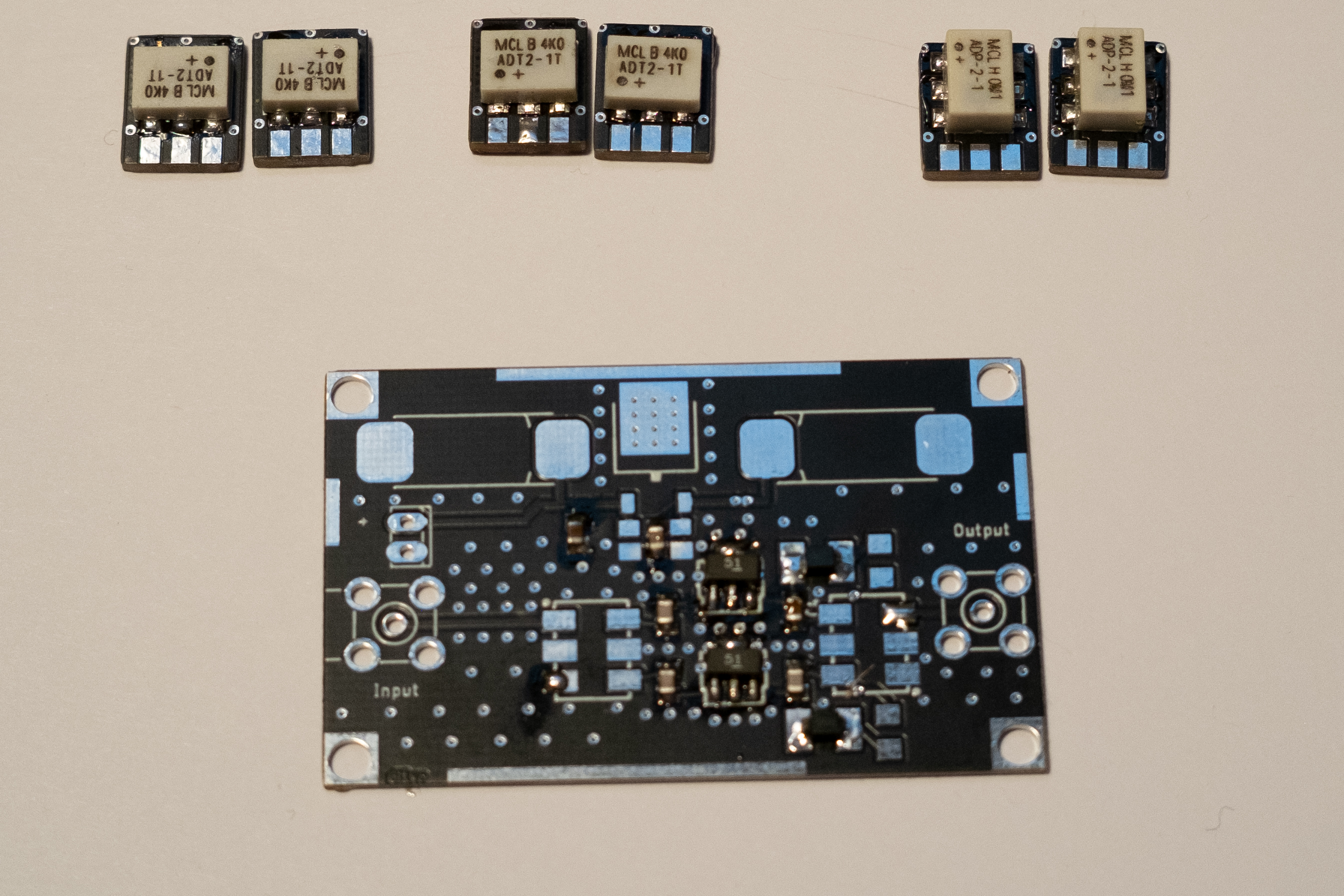

dj1yr
Posts: 63
Re: ORION MK2 IMD3/5
Postby dj1yr » Sat Apr 03, 2021 3:51 am
DL8LAQ wrote:Happy Easter!
Are there any news about this IMD thingy?
yes, I got my test boards, still waiting for some components, then I try to reproduce this behavior first.
If this succeeds reproducibly, I have made small adapter boards with which I can insert other transformers and attenuators.
These boards can then be used instead of the transformers.
I will also make a test with the MC Splitter/Combiner.
To the picture, left - correct mounting direction, center - as on Orion and right - splitter/combiner.
73' René

Postby w-u-2-o » Sat Apr 03, 2021 10:43 am
Eagerly awaiting your results, René!
