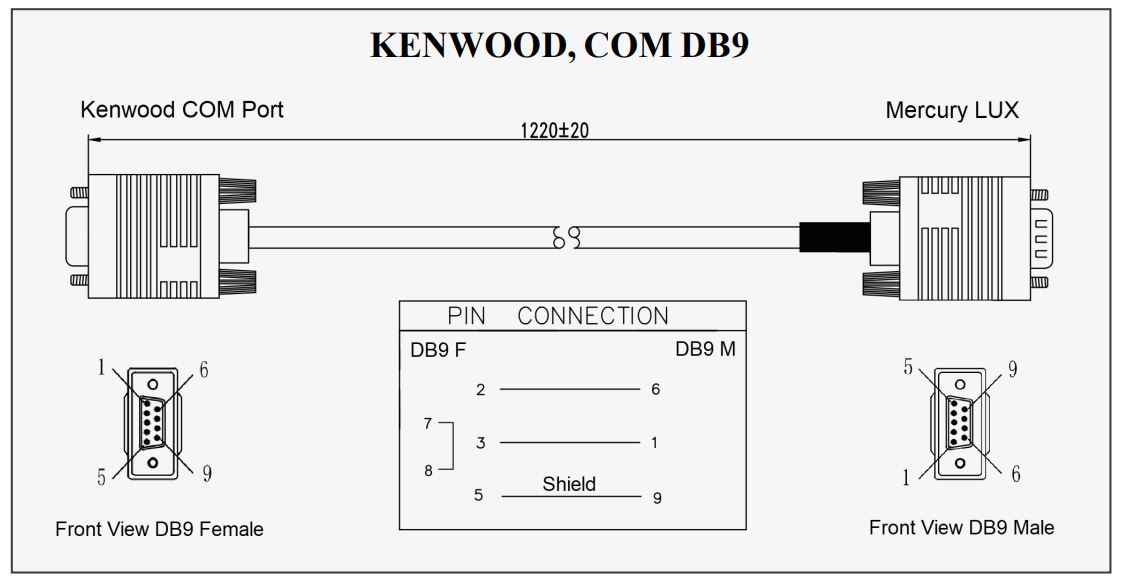

This is where things get a little fuzzy for me. Is the cable from the LUX Band Data connector to the serial port a straight through RS-232 cable or something else? My amp is remoted from the PC via gigE connections, with an Enet to RS-232 server at the amp end which has several available RS-232 ports which are available to Thetis.

Rick,
This will be a "real" port as far as Thetis is concerned. No virtual serial port cables instances required. The port number you specify in Thetis will be the port number associated with the port on the RS-232 device server (Moxa, right?) And of course you'll configure the device server and Thetis for 9600N81 operation.
I looked at both the Lux manual and some online data regarding Kenwood serial port connections. The results were unclear to me regarding the sense of the TXD and RXD connections. Referring to this figure out of the Lux manual:
If we believe that the Lux is defined as DCE, as the female DE9 on the rear panel would suggest, then RXD on pin 6 and TXD on pin 1, wired as they are in the figure, should allow the pictured Kenwood cable to plug directly into the DTE port of the device server, since a DTE DE9M port has RXD on pin 2 (an input on DTE) and TXD on pin 3 (an output on DTE).
However...people, and documentation, often gets so confused where DTE/DCE/RXD/TXD/M.O.U.S.E. is concerned that it's probably a 50/50 shot if this works ;) The good news is that just swapping pins 2 and 3 will solve the problem 99% of the time.
I almost always make my own cables or buy cables and connectors that can be re-pinned, so this is rarely an issue for me. I'd suggest posturing yourself to be able to use the cable as shown in the figure, or one like it but with pins 2 and 3 swapped on the PC (DTE) end. That way when you get the amp there's no drama. Just pick the cable that works.
If you want total flexibility, you can buy something like this. You don't even need to solder if you buy some jumper wires. Or go all in and make your own cable with just a screwdriver and some wire strippers with this kit.

Thanks, Scott! Yes, Moxa. I was zeroing in on this while you wre typing and now see what is needed (I think). I have used the "flexible" style DB9 connectors previously so this is familiar territory.
It is likely I will have some time to think this through more thoroughly as I may have several months left before my turn comes up to purchase a LUX. The other challenge will be getting the LUX Remote software working; right now I am thinking an FTDI USB to RS-232 cable from the amp to another Moxa port. Or, alternatively, using my Silex USB to Enet server.
