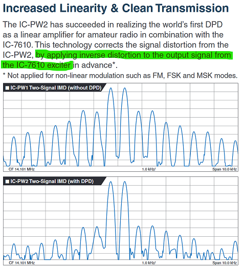

Consider the following wild conjecture, after looking at the link and watching the Youtube video (linked below).
First and foremost, since the linearity measurements are most likely being made internal to the amplifier, only the PW2 can be linearized and not any part of the 7610 signal chain.
One might guess that predistortion data could be sent in an analog fashion back to the 7610 via the ALC connection. Or, perhaps the amp transmits some sort of correction table back to the 7610 over Ethernet.
The amount of improvement shown in the brochure is a bit odd. If one assumes that the graph scales are the quite common 10dB/division, then in the un-linearized state the amp would not meet USC 47CFR97.317(a)(1), which requires spurious to be -43dBc. Of course most amp's don't meet that, so I don't know how any of them are actually sold in the US but, still, it's a concern. In the linearized state it shows a quite respectable performance of -50dBc. Perhaps the performance graph for un-linearized has been "adjusted" by the marketing team. If it was closer to the -35dBc we normally see from these things, or even a legit -43dBc, the additional 7 or 15dB of performance achieved is within reason for only linearizing the amp and not the transceiver.
It seems unlikely Icom sees Apache or the openHPSDR community as any sort of competitor, at least I don't think that's what is driving them to add linearization. This whole thing is really a huge shot across Flex's bow. They did a fine job of toppling the entire market where entry level, direct-sampling SDR is concerned. Now they probably want to topple Flex's dominance in the contester market, and the features of this new amplifier go a long way towards doing exactly that. The linearization is just the cherry on top, Icom's way of thumbing their nose at their competitors. Icom was first with a direct sampling SDR among the Big Three and, surprisingly, Elecraft. Now they are first again and add Flex to that list. They know nobody else except Elecraft has a prayer of adding linearization without producing a whole new radio, so they will be enjoying that cherry for a long time.
At any rate it will sure be interesting to find out how it really works, and how well it really works. Now if Icom would only get off their high horse and allow a transmit passband greater than 3KHz they'd own the ESSB market, too.

Postby K1LSB » Tue Aug 23, 2022 6:11 pm
Flex has been dangling the pre-distortion carrot for over eight years:
https://community.flexradio.com/discuss ... distortion
They said at that time they already had the requisite feedback loop implemented internally in their 6000-series radios. I saw that conversation and decided to take the plunge and purchase a Flex based at least partly on that premise/promise. Sadly, eight years later the dream of Flex pre-distortion is still only a pipe-dream. For that and other reasons I've long since divested myself of anything connected with the name "Flex".
The blurb in Icom's pdf states that "the technology corrects the signal distortion from the IC-PW2, by applying inverse distortion to the output signal [emphasis mine] from the IC-7610 exciter in advance", implying there's no correction applied by the amp to the 7610's signal prior to delivery to the amp.
With that said, I've observed that the Icom 7300 and 7610 have the cleanest and sharpest-shouldered transmitted SSB signals I've ever observed on my panafall (with the exception of another Anan). I've even remarked on that fact over the air and was told (though I haven't verified the accuracy of the claim) that Icom does in fact employ a firmware based distortion-correction curve in those radios. Icom's curve isn't real-time dynamic as in an Anan, rather it's a one-time correction curve burned in at the factory so it's not going to be as effective as the constantly adjusting correction employed by Thetis in an Anan. But it clearly does improve the IMD in the 7300 and 7610, at least per my own observations.

Postby K1LSB » Sat Jun 03, 2023 3:04 pm
w9mdb wrote:They qualified their statement -- "the world's first DPD as a linear amplifier for amateur radio".
And even that is not entirely the correct claim.
Specifically, the claim is "This technology corrects the signal distortion from the IC-PW2, by applying inverse distortion to the output signal from the IC-7610 exciter in advance". (emphasis added)
That statement does not claim that the IC-PW2 is able to correct for any signal distortion originating in the IC-7610 exciter. The IC-PW2 is only aware of the output signal coming from the IC-7610, not the input signal going into the IC-7610. So the IC-PW2 can only correct for distortion generated internally in the IC-PW2. It does not, and cannot, correct for any distortion generated in the exciter.
