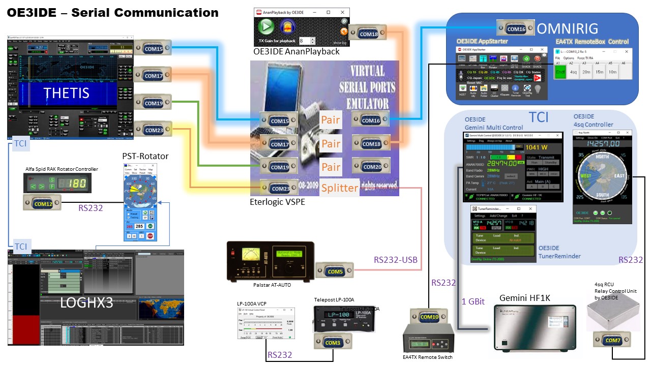

Postby oe3ide » Wed Mar 22, 2023 5:32 pm
I am using an Palstar AT-Auto (Kessler). This tuner is connected via RS-232 to a virtual serial port (Thetis) using the Kenwood protocol. Frequency change is immediate and fully automatic.
But the rest has to be done manually: Tune, switching from bypass to auto or manual.

oe3ide wrote:I am using an Palstar AT-Auto (Kessler). This tuner is connected via RS-232 to a virtual serial port (Thetis) using the Kenwood protocol. Frequency change is immediate and fully automatic.
https://kesslerengineeringllc.com/tuners.html
Schematics:
73 de Ernst
Than you ernst for the informative solution.
I don't know if I will go with the Palstar, as is expensive for me.
I may think to go with the Elecraft KAT500. The schematic that you sent, is very helpful. I hope that It will match + - The KAT-500 with the kenwood cat.
73;s
Nir 4X1FK
