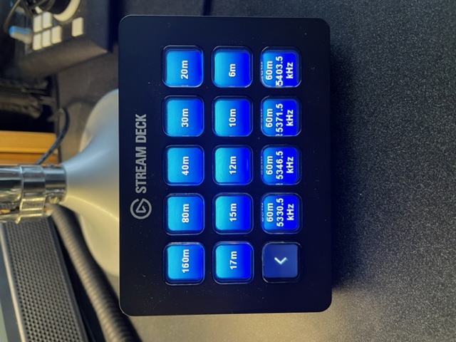

I'm looking for a ZZxx CAT command that will activate a given band from a StreamDeck button - - one button for each band and each button press would cycle through the band-stack memories.
In referring to the latest Thetis and PowerSDR™ 3.x CAT Command Reference Guide, I see the ZZBG command as well as commands to increment the band up and down but that won't achieve the objective.
It's also possible to set a band but requires setting the VFO frequency. However, the point is to cycle through the existing band stacks and NOT set the VFO frequency.
Thoughts?
Thoughts?
Re: CAT command reference and list
Got my answer from a list member. The ZZBS command works (e.g., ZZBS160, ZZBS080, etc.)
