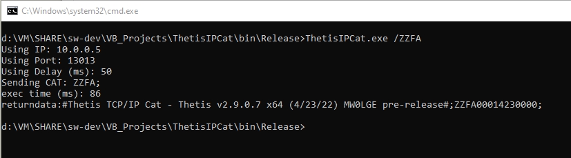

Postby oe3ide » Wed May 18, 2022 4:28 pm
just made a commandline tool for sending CAT-Commands via TCP/IP to Thetis:
https://www.oe3ide.com/sdm_downloads/thetisipcat/
Usage:
Just call the program. The ini-file (thetisipcat.ini) will be auto-generated in the same directory as the exe. Adjust IP & Port.
Examples:
Code: Select all
thetisipcat.exe /ZZFA00014250000 /ZZSP1 /ZZFB00014260
cmd interface.jpg (81.7 KiB) Viewed 9126 times
You can parse the output ("returndata:") for reading the returned data from Thetis
Have fun :-)

Re: Release: ThetisIPCat
Postby oe3ide » Wed May 18, 2022 4:48 pm
make a cmd-file, like:
ptton.cmd
c:\yourpath\thetisipcat.exe /ZZTX1
pttoff.cmd
c:\yourpath\thetisipcat.exe /ZZTX0
Postby oe3ide » Wed May 18, 2022 5:01 pm
w-u-2-o wrote:Very handy, Ernst!
Would the source code be available for download?
Sure ;-)
https://github.com/oe3ide/ThetisIPCat
Postby oe3ide » Wed May 18, 2022 6:13 pm
ea3aqr wrote:
oe3ide wrote:Hi,
ptton.cmd
pttoff.cmd
Looks like I'm not explaining myself well enough...
I would like to know if we can have a batch file assigned to a keystroke than can acts exactly like "space" bar on Thetis that togles ON/OFF my PTT.
I know I can use 2 .bat files but this is not what I'm looking for...
Can you explain in depth how to parse the output ("returndata:") for reading the returned data from Thetis
You could place a shortcut on the desktop and assign a keystroke.
Parsing: Could be done via PowerShell (never tried it):
https://stackoverflow.com/questions/205 ... and-output
