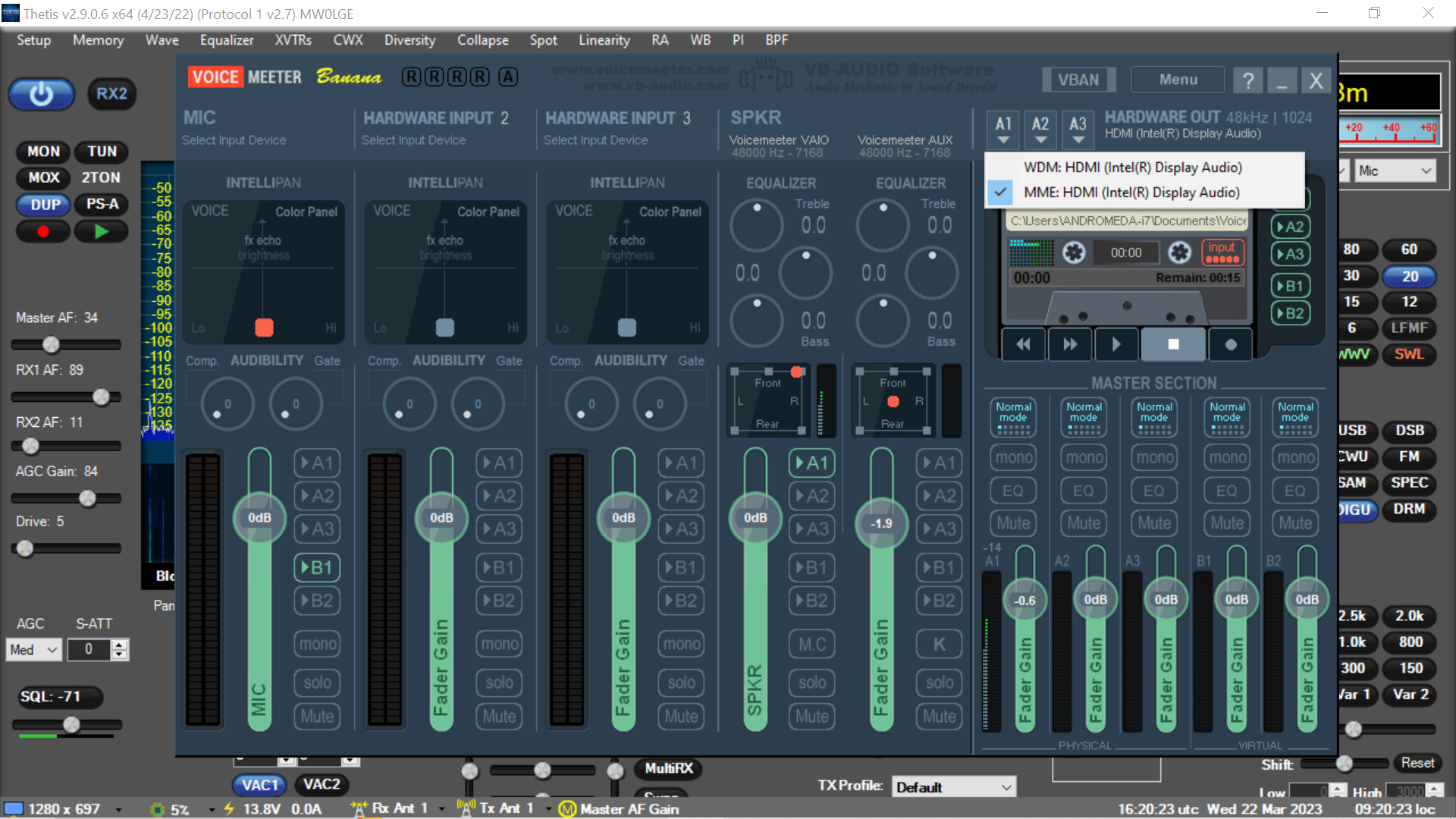

Scott and Tony, thanks for the replies. Here is the screenshot requested. Scott, I had already tried your suggestion with no luck.
i'll try to send a screenshot of the VM showing the options I have to choose from there. First is the Setup>Audio
download/file.php?mode=view&id=3442
Second for Scott, the VM. if that is not what you need, I have others.
download/file.php?mode=view&id=3443

Oops, I should have picked up on your problem in the first post. Thetis must be assigned to one of the virtual input channels, B1 or B2. The same for Fldigi. You can't assign software to one of the hardware channels, only real hardware.
Then enable the B2 send on channel B1 and the B1 send on channel B2 so they send audio back and forth to each other.

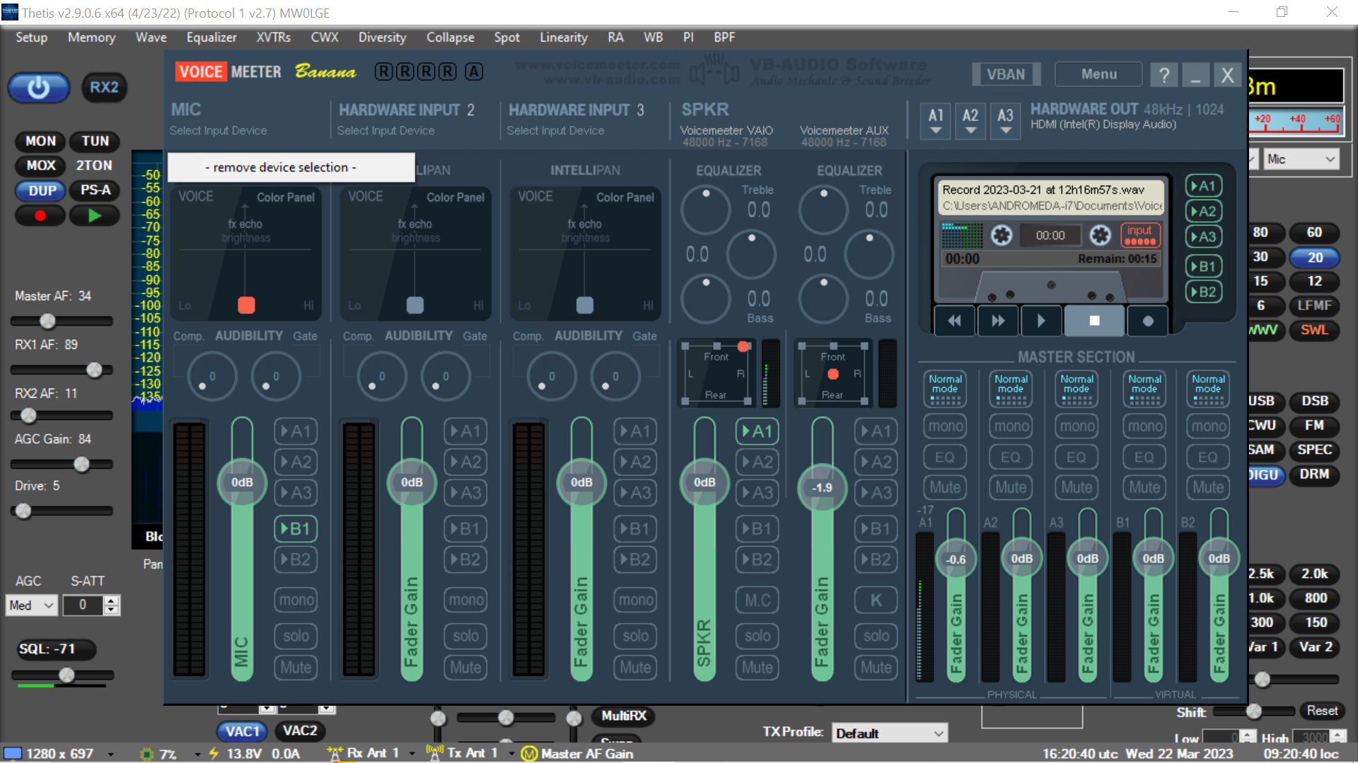

I'm not following you.....here is another screenshot showing the result when I click the MIC tab to get a dropdown list....."Remove device selection"
What do I need to do in order to produce a dropdown list instead of the "Remove....." popup? Where does the microphone list come from...how do I find the microphone. The only thing I have in the way of microphone hardware is a headset plugged into the front of the Andromeda.
I guess I don't understand the audio input/output flow (path) before it gets to VM.

- VM_Select Input Device 1.png (698.51 KiB) Viewed 19325 times

OK, my bad, based on your previous posts I thought this was a digi mode problem (maybe it will be in the future
The problem you may be having is that perhaps you don't understand that software can only see audio devices plugged into the PC. Anything you have plugged into the Andromeda is only visible to Thetis.
Now I'm assuming you want to use a mic plugged into the PC. So plug one in and then it will become visible to Voicemeeter. You may have to restart Voicemeeter in order for it to detect any hardware changes.
You can use any USB microphone you might have.
And if that is still leaving you lost, then you need to explain exactly what it is you hope to achieve, and how you think it should be achieved.

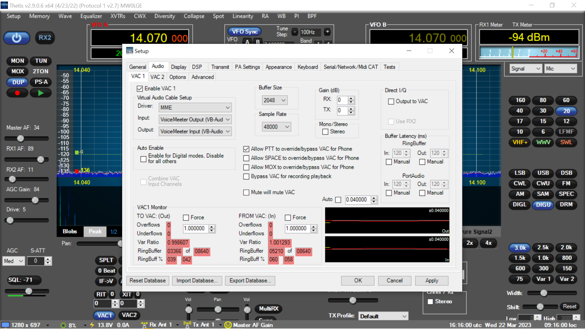

For digital mode operations Voicemeeter will ONLY come into play as a means to connect Thetis and Fldigi (see my previous post above about how to do this). It will have absolutely NO bearing on the mic you have plugged directly into the Andromeda. There is NO reason in your case to set up any microphone on a Voicemeeter hardware input, NONE.
When you want to run digital modes select VAC1 in Thetis. This will completely bypass the microphone plugged into Andromeda (as long as none of the "override/bypass" options are checked in VAC1 setup).
When you want to run phone (SSB, FM or AM) using the mic plugged into the Andromeda, disable VAC1 in Thetis.

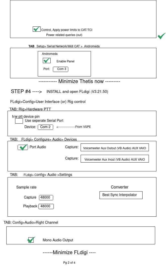

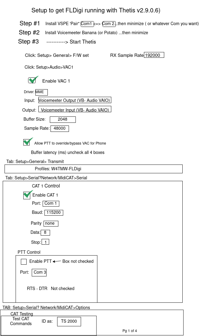

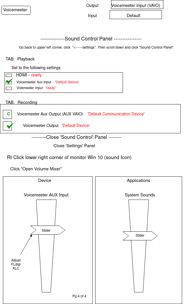

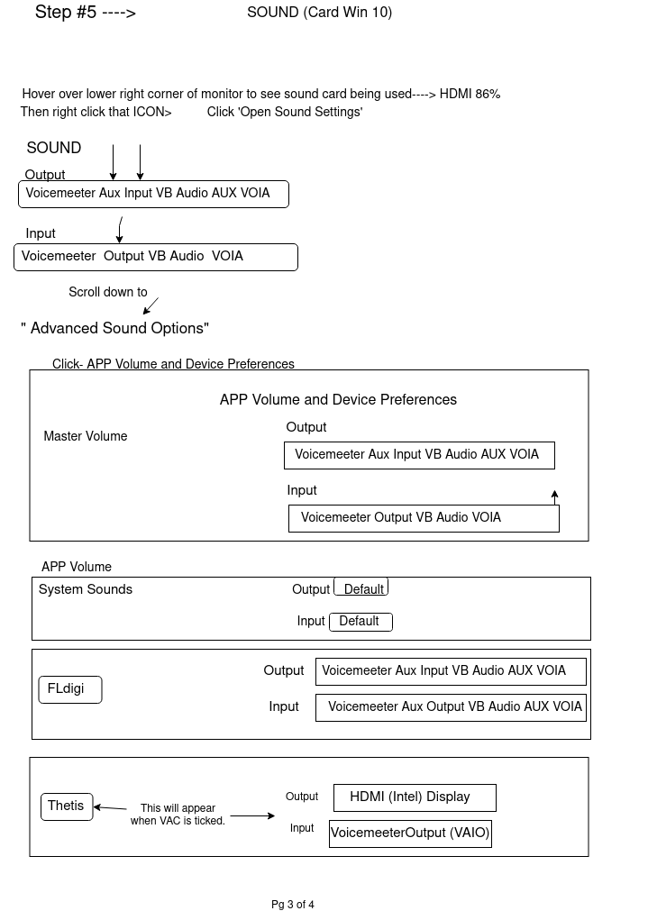

Re: Voicemeeter Hardware Input- won't populate (SOLVED)
Herewith are my instructions for interfacing Thetis to FLdigi using Voicemeeter (VM) and Virtual Serial Ports Emulator (VSPE). These instructions are being used with an Andromeda/Thetis 2.9.0.6 ......Protocal 1 .......Win 10. I'm not a guru on this stuff so I cannot vouch for any other radio configuration, however, any feedback would be appreciated.
God bless
73, Tom W4TMW
I used "Draw.io" software to compose the pages.
God bless
73, Tom W4TMW
