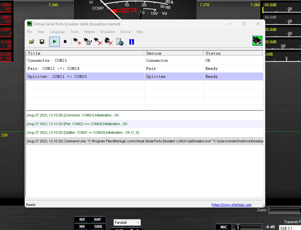

Setting up Cat control for Ham Radio Deluxe (HRD) using VSPE I have to ensure that VSPE is open and configuration loaded then start Thetis and then have to close VSPE to open HRD, if VSPE is open HRD wont see the DLE 7000 III. Adding VSPE to Windows 11 start up is no problem but when I do this HRD will not connect to DLE 7000. Anyone care to help me this odd problem.

can u share the VSPE configuration? Maybe a screenshot.
I am using a "Pair" in VSPE (ie. COM15, COM16).

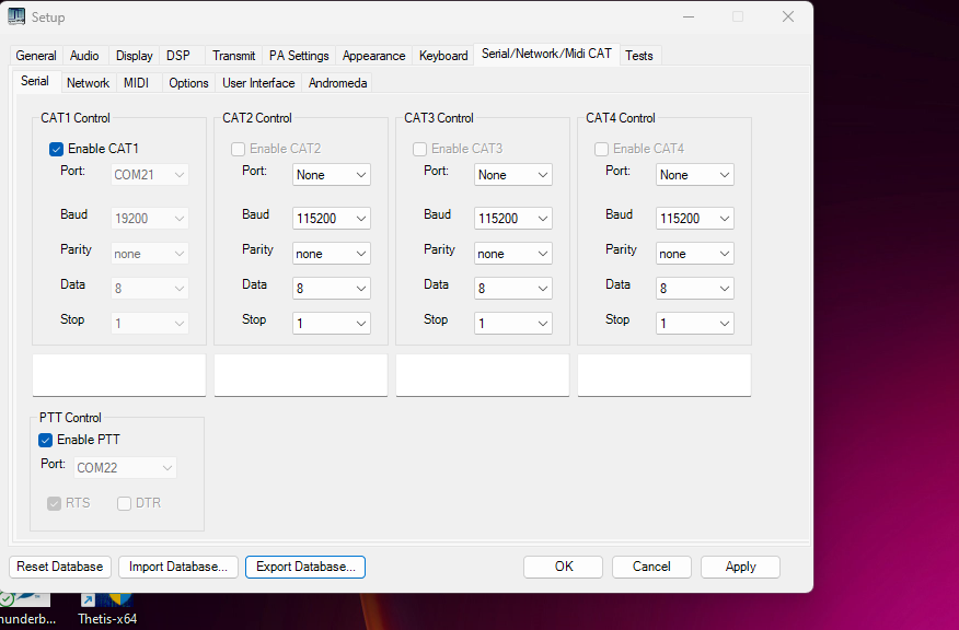

Postby KD1GA » Mon Aug 28, 2023 7:24 pm
oe3ide wrote:Hi,
In Thetis I have set COM15 and in the logger COM16 (but its not HRD)
Sorry for the late response and thanks in advance for the help KD1GA
Here are a few screen shots of configuration.
Screenshot 2023-08-27 121128.png (85.69 KiB) Viewed 28427 times
Screenshot 2023-08-27 121048.png (107.23 KiB) Viewed 28427 times
Vin KD1GA

Postby w-u-2-o » Mon Aug 28, 2023 8:14 pm
You didn't show the HRD settings.
Assuming HRD and Thetis are running on the same computer you don't want to use a splitter, you want to use a pair, and you don't need the connector either.
Delete the connector. Change the splitter to a pair. Put COM20 into HRD and COM21 into Thetis and you should be good.

Postby KD1GA » Tue Aug 29, 2023 5:33 pm
w-u-2-o wrote:You didn't show the HRD settings.
Thanks Scott, wow I wasn't even close. Yes they are both running on the same computer. Thanks for all the great help you always provide. What kind of Scotch do you like :).
