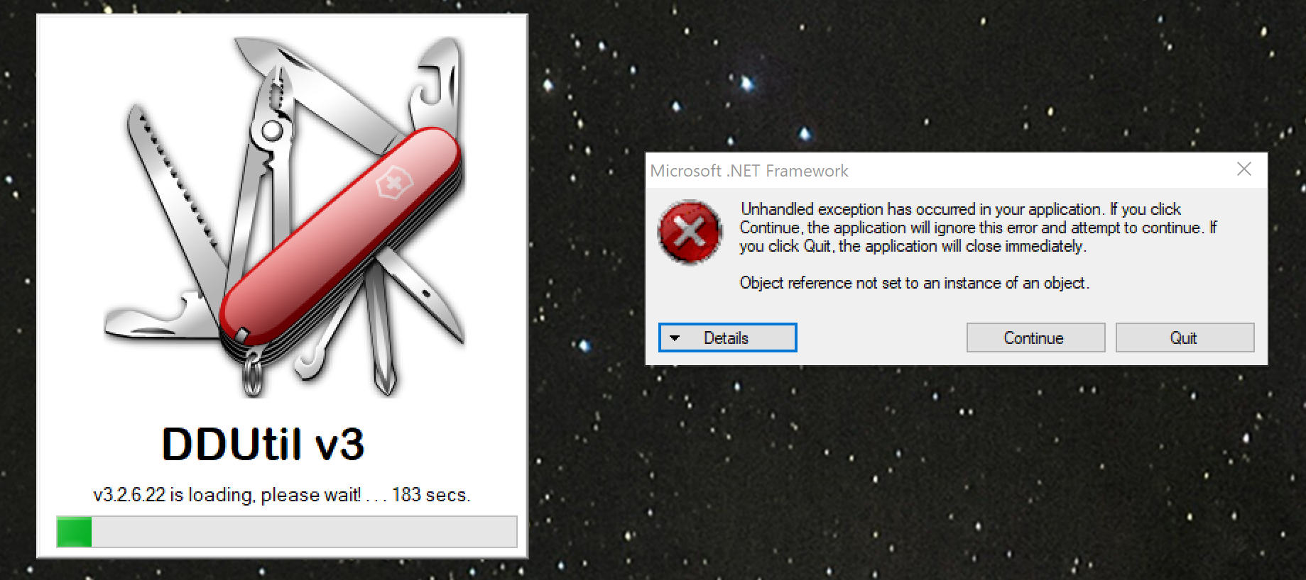

So, I tried one last time with 3.2.6.22. And no go. This is running on Windows 10 Pro-64 in Bootcamp on a high end iMAC core i7. Which runs all of my PowerSDR and VSP and VAC softwares.

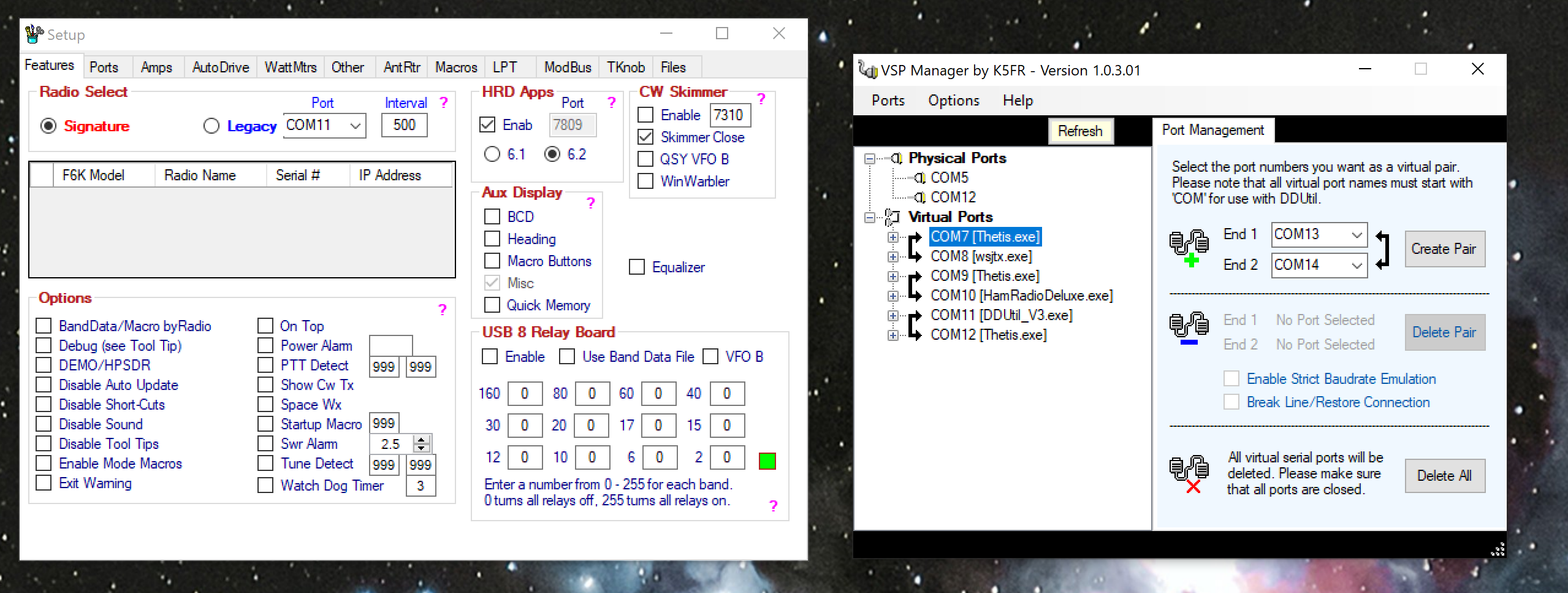

Here is what happens. I load a fresh install of DDutil. And I make sure I have deleted the config file first, or it will just crash.
Start the program and get it talking to Thetis. Thetis CAT port Comm 12 and DDutil Com11. You can see in VSP that it knows Thetis is there and and is attached to Com12 . However, NO Radio shows up in the DDutil panel. OK fine... the server starts in DDutil and it looks ok.
Then I go through the motions of installing the CIV-Comm adapter ( I know works as it did on the Flex3000 with no issues) and then resetting the PW-1 and put it in LEARN mode and NADA... Changing the VFO does nothing there is no traffic to the CIV set up for the PW-1 on the Port I have dedicated in DDutil. Even though the server is running in DDutuil it echoes "no connection to server"
To add insult. When I close DDutil. And re-start. It just crashes with a .Net Framework error, and I have to delete the config file again to start all over and end in the same loop.
I guess this is just not going to work Scott. Unless you have some words of wisdom here.????
Some screen snaps attached.
Ronnie

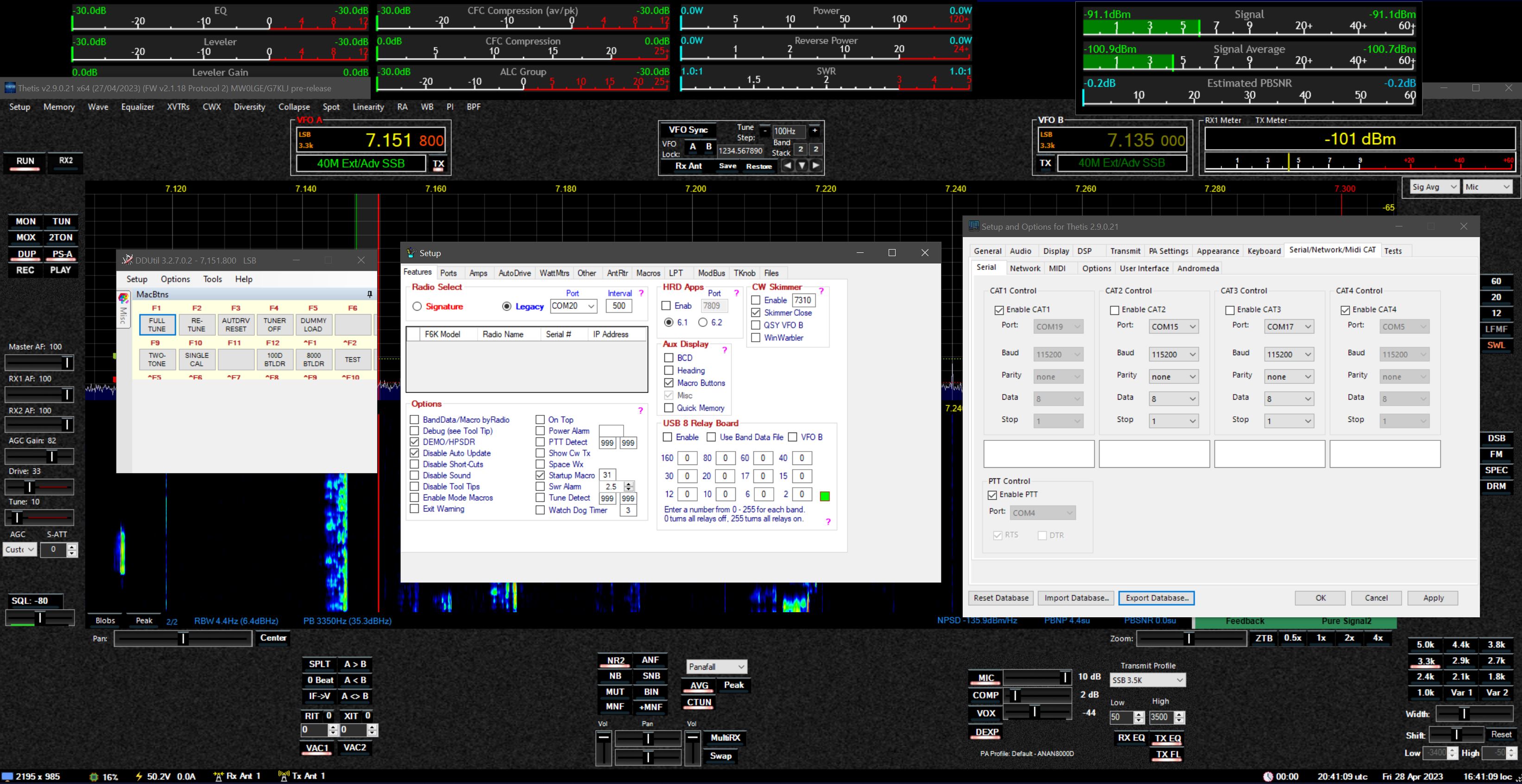

electronics-tech wrote:First off, Scott, I do have lots of experience with DDutil. The problem I am having is that SmartSDR is supported BUT PowerSDR of any kind is not by Steve. He even told me so. So Thetis is also not supported. Well, at least to my knowledge.
That's just Steve's way of saying "I have no idea if any of this works with Thetis (it does) and I don't want to expend any effort to support my old work, I have moved on." Which is totally fair. But the old stuff does work with Thetis. Remember, it's all just CAT commands and the commands DDUtil supports for PowerSDR are the exactly the same in Thetis.
With Bootcamp all bets are off. Steve did some weird stuff on the serial port IO and I've even had trouble with it on Windows from time to time. Whether or not it would work in Bootcamp is more than I can say. The classic serial comm's symptom with DDUtil is no connection to the radio.
And there you go: serial comm's problems with DDUtil. This has been an issue since DDUtil V3 was a baby, with PowerSDR, and when Steve did support it. I complained and he told me in no uncertain terms there was nothing wrong with it.
I've had much better luck using VSPE from Eterlogic because I found VSPM to be unstable. Again, something weird about how the serial comm's are implemented. I'm no developer, and nobody has access to the source for VSPM or DDUtil, so who can say exactly what might be wrong with it?
Then I go through the motions of installing the CIV-Comm adapter...
There's no point in that until you solve the radio connection problem.
I'm going to blame Bootcamp ;)
Beg, borrow or steal a real Windows 10 machine. Make sure it is 100% up to date. Install VSPE. If you are super paranoid, install PowerSDR, but I'd just go with Thetis. You can also try going back in time a little further. Just grab an even older version than 3.2.6.22 from the directory I linked in the first post above.
But 3.2.6.22 should work. It works for me, I'm running it right now with Thetis.

electronics-tech wrote:But it Thetis will not talk to DDutil.
It works perfectly fine here.

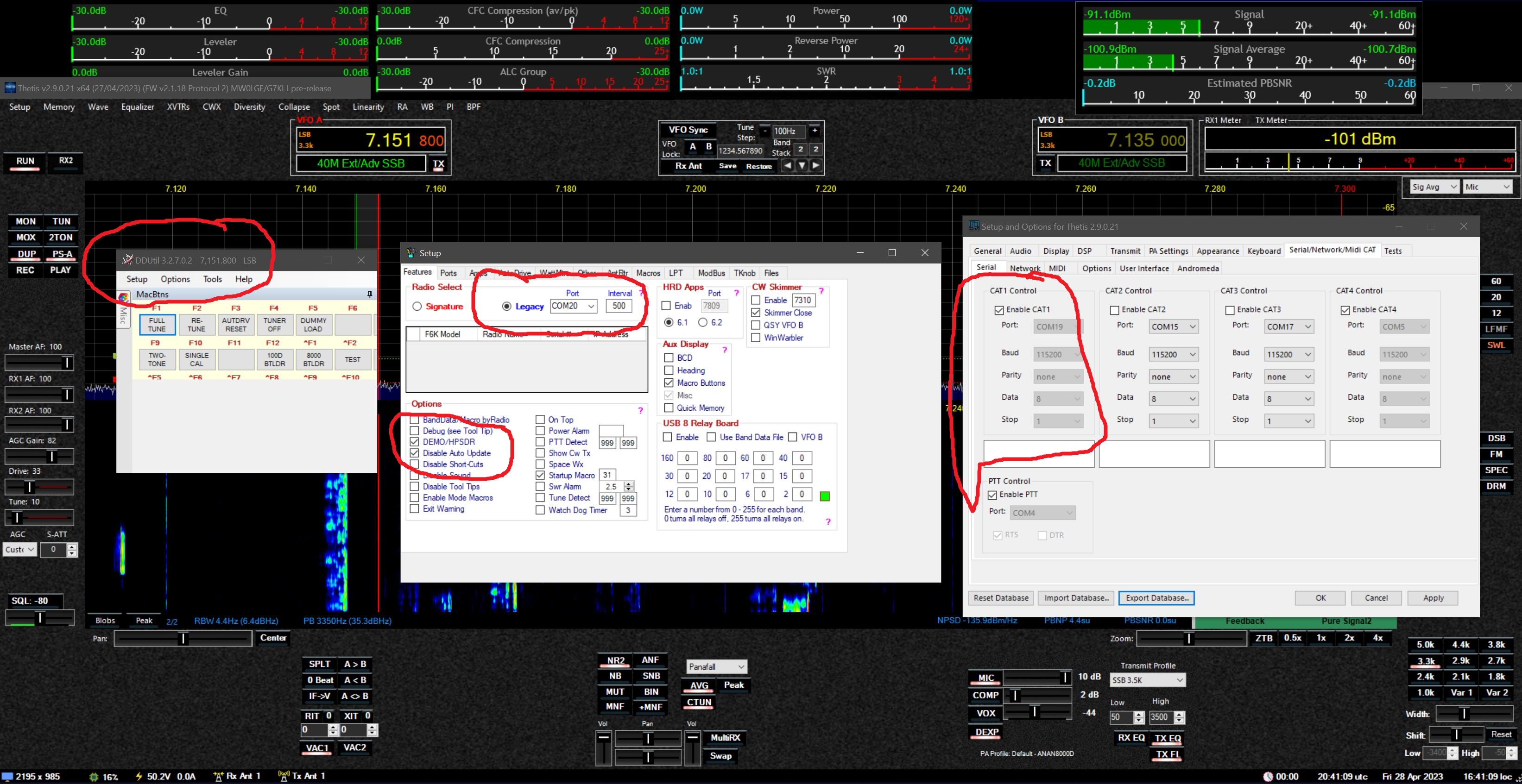

Why when I look at your picture posted does DDutil NOT show a radio>? And are you using LEGACY mode?
Look at the picture again. And you MUST have DEMO/HPSDR mode checked.
I will assume you can tell it is connected because the server in DDutil says " 1 connection to server".
There is no such indication that I know of in DDUtil. I have no idea what you are talking about.
You can tell it is connected because in the title bar of DDUtil is shows the frequency and mode, and the frequency and mode will track whatever Thetis is set to.
Are you running in 32 Bit Mode Windows 10 Pro or 64 Bit Mode? With Thetis in 64 Bit Mode?
Everything is 64 bit on my machine. 64 bit OS, 64 bit Thetis.
DDutil cannot stand being launched in a 64 bit platform in legacy.
Obviously incorrect, since my systems have all been 64 bit for as long as I can remember. Certainly going all the way back to my Flex 3000 days 15 years ago.
I give up on this. DDutil is never going to work, and I am NOT wiping my iMac to install a 32 bit version of WinBlows.
Nobody should be running a 32 bit version of anything anymore. Hell, I run 64 bit Raspian on my Pi's.
However, you should use the right tools for the job. Using Windows-centric software should be done on a real Windows machine.
I have Linux, Windows and Android platforms here and I use them as required. If I had a need for iOS or MacOS I'd use them, too. This whole religious thing about not running this or not running that is silly.

My apologies Scott. Frustration did get the better of me. Sorry about that. I have been supporting Windows as a Tech for 25+ years and am getting a bit too cozy with Mac OS.
Your JPG was pretty small. I did miss some of the checkmarks and I will have another look. But you are probably right about the VM part with BootCamp. There are so many variables with what I am trying.
One thing I have learned is the order in which you start this stuff up is very important. VSP's load, VAC loads. Then DDutil. loaded in my case previous, and then the SDR software. Add CAT devices afterwards for what you want.

Re: DDUtil support for PowerSDR and Thetis has ended (but 3.2.6.22 works OK)
Postby w-u-2-o » Sat Apr 29, 2023 10:51 am
You can view the image full size by either downloading it or doing the right click open in new tab thing if your browser supports that.
That is the same startup order I use.

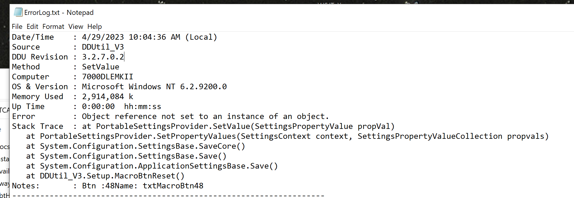

Some new clues this morning. I removed DDutil, and downloaded the V3.2.7.02 you had. Installed again. Setup again. No connection to Thetis.
This is really simple as you have shown, and I know that. But it will not talk. All my setting replicate yours.
This time, I used another different VSP, and was able to see the traffic through the comms. They see each other for sure. I also took a look at the DDutil Logfile this time. Attached.
At install, it is still complaining about a .NET Framework problem. I am now wondering if perhaps you have installed along the way some older version of Microsofts .NET Framework?
I currently only have .NET SDK 6.0.405 installed.
Would you be kind enough to check that for me. It all seems to be something to do with this "object not set reference"

Postby w-u-2-o » Sat Apr 29, 2023 2:57 pm
Ha! I totally forgot I was living on the bleeding edge with 3.2.7.02 :D
I can't recommend using 3.2.7.02 unless you absolutely need a feature it has. Use 3.2.6.22 or even something older.
I strongly recommend using Eterlogic VSPE. Failing that, use com0com. I strongly dis-recommend Steve's VSPM.
In VSPE use a port pair. Can't speak to com0com, I haven't used it in over ten years.
You may be onto something with the .net stuff.
Here is my .net report:

Scott trying to install and get DDUtil V3 working on my Anan 7000 to interface my Yaesu rotor utilizing the ERC-Mini rotor interface.
Can you help with basic set up to get the DDUtil to connect to my PC ?

On DDUtil I used tools and error log says Object reference not set to an instance of an object.
I tried resetting everything and also turning off firewall. When I checked log it did not show that program was blocked.

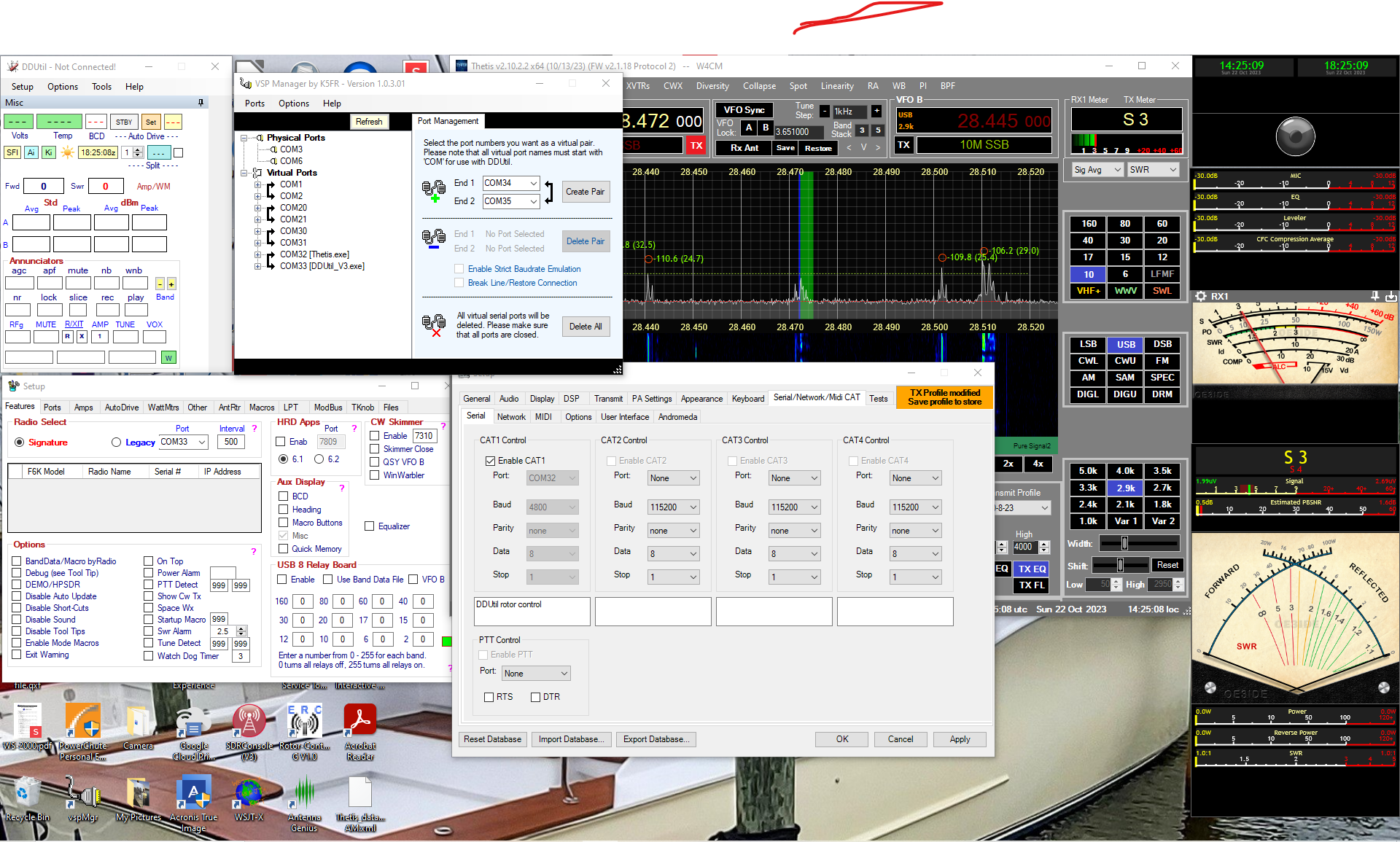

Post screen shots of your Thetis CAT setup page, DDUtil setup page and VSPM virtual port pair setup page.
w4cm
Posts: 66
Postby w4cm » Sun Oct 22, 2023 6:34 pm
Screenshot 2023-10-22 142553.png (1.02 MiB) Viewed 45946 times
Postby w-u-2-o » Sun Oct 22, 2023 8:07 pm
That all looks fine with one exception: in DDUtil "DEMO/HPSDR" needs to be checked.
