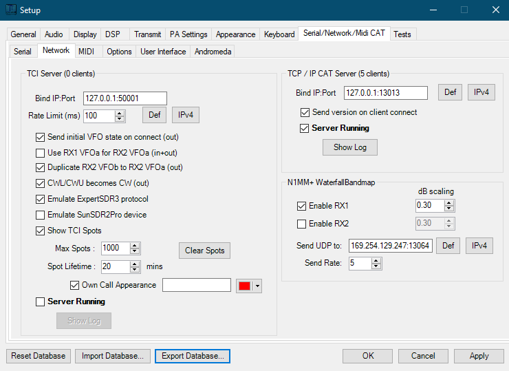

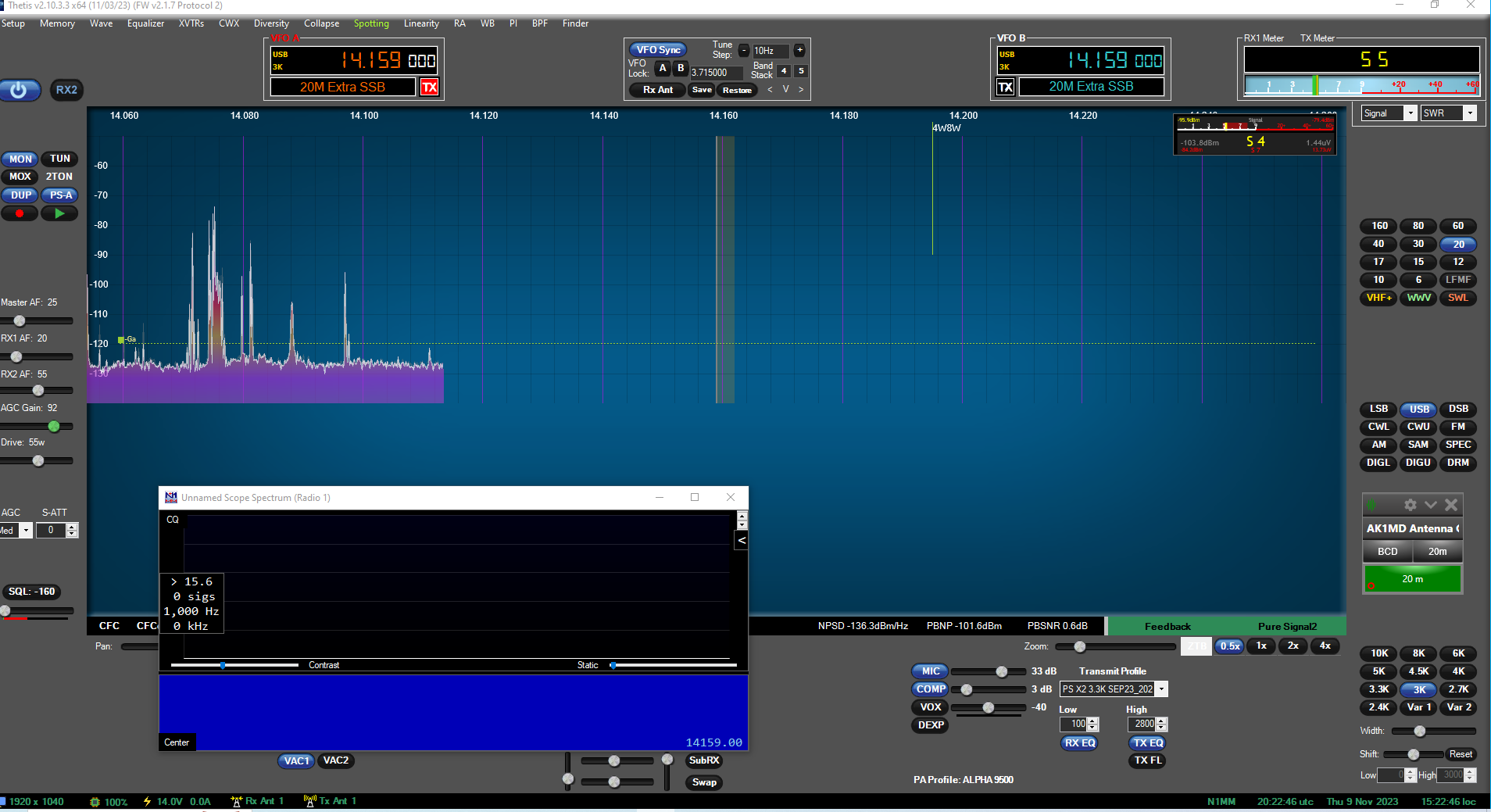

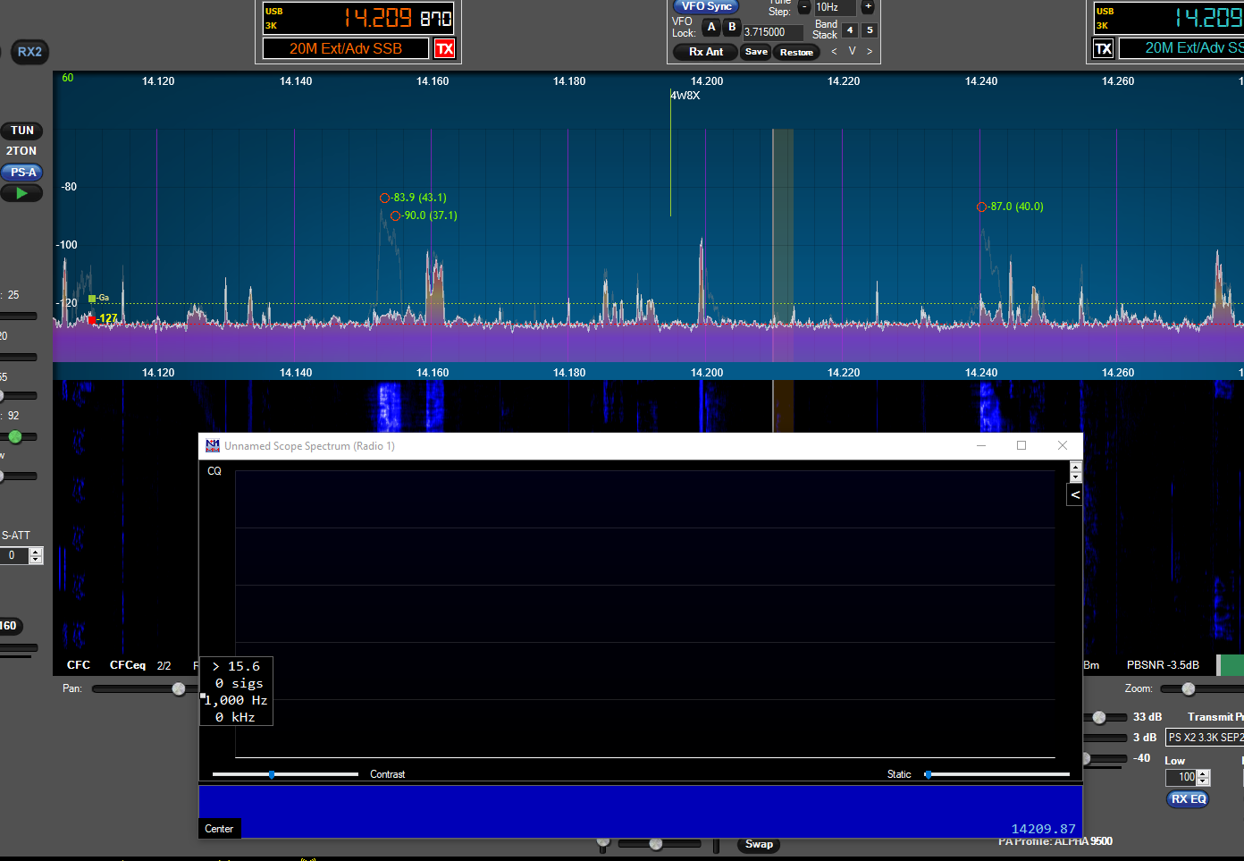

Postby AK1MD » Thu Nov 09, 2023 10:02 pm

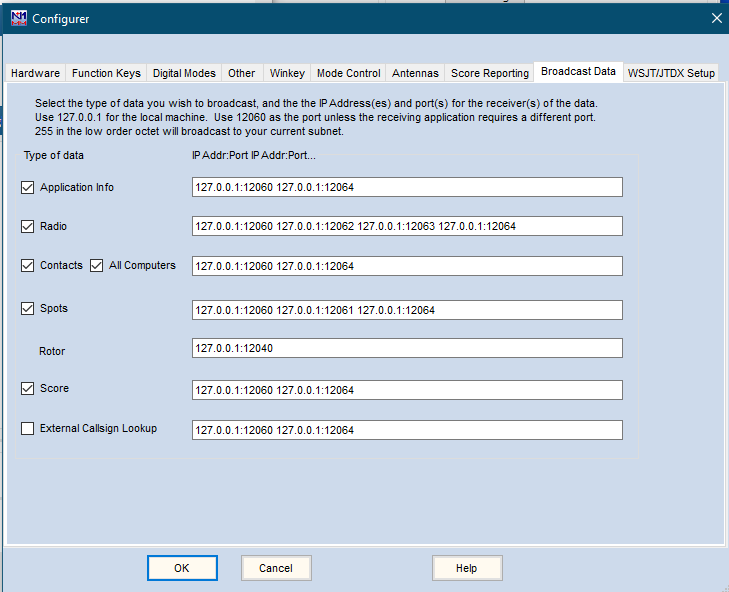

I am using the latest version of N1MM 1.0.10077.0 and Thetis v2.10.3.3x64 FW v2.1.7 Protocol 2.
I tried turning off Windows Firewall, however no success.
Thank you for your help.
Please see attachments.
73, Alex AK1MD

Assuming everything is running on the same computer, change that 169... address to 127.0.0.1.

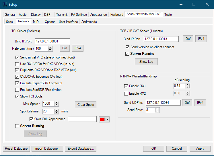

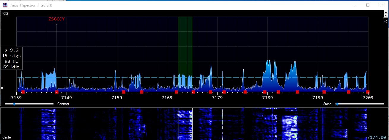

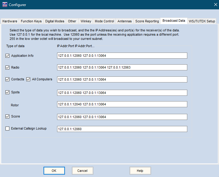

Okay I was able to resolve the issue. Thank you for your help.
It seems UDP ports have to be unique in N1MM.
I changed IP addresses and ports in N1MM Broadcast Data settings.
In Thetis Setup it required 127.0.0..1:13064
Thank you and 73, Alex AK1MD
Spectrum display N1MM-Thetis 11092023.PNG (124.43 KiB) Viewed 12170 times
Thetis settings 11092023.PNG (31.96 KiB) Viewed 12170 times
