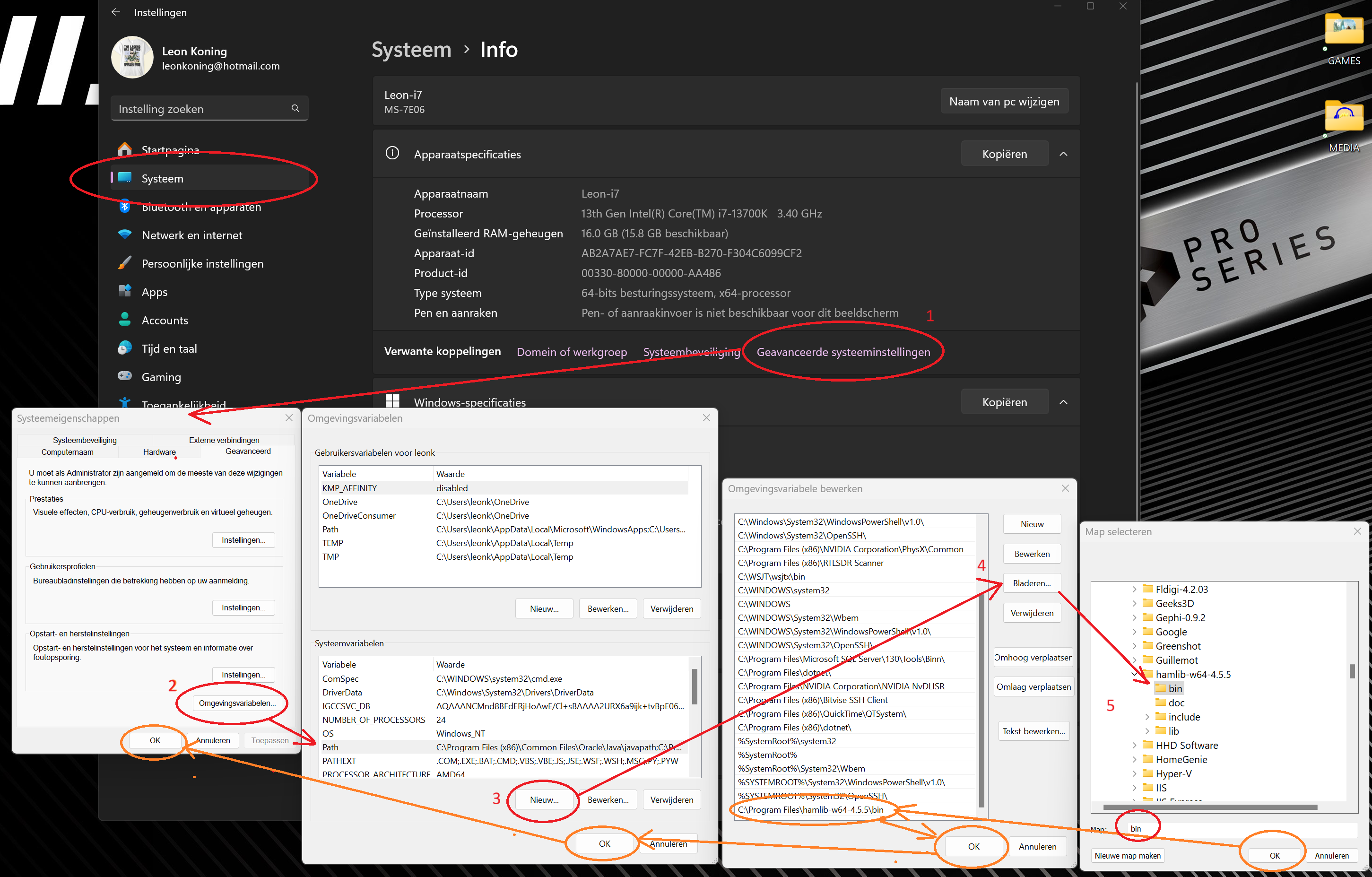

Hi, no, HamLib has to be installed once.
If you can control Thetis (freq, mode) from within FLdigi than it's working fine already.
If it doesn't do that, than add the directory "C:\Program Files\hamlib-w64-4.5.5\bin" to your Windows PATH
The path (hamlib-w64-4.5.5/bin) depends on the version ofcource.
Look at attached picture, it's from my Dutch Win11 but i think it's usable, just follow the steps.
Doing this allows other programs - that are able to use HamLib - to find HamLib's DLL's.
Regards, Leon
Regards, Leon
