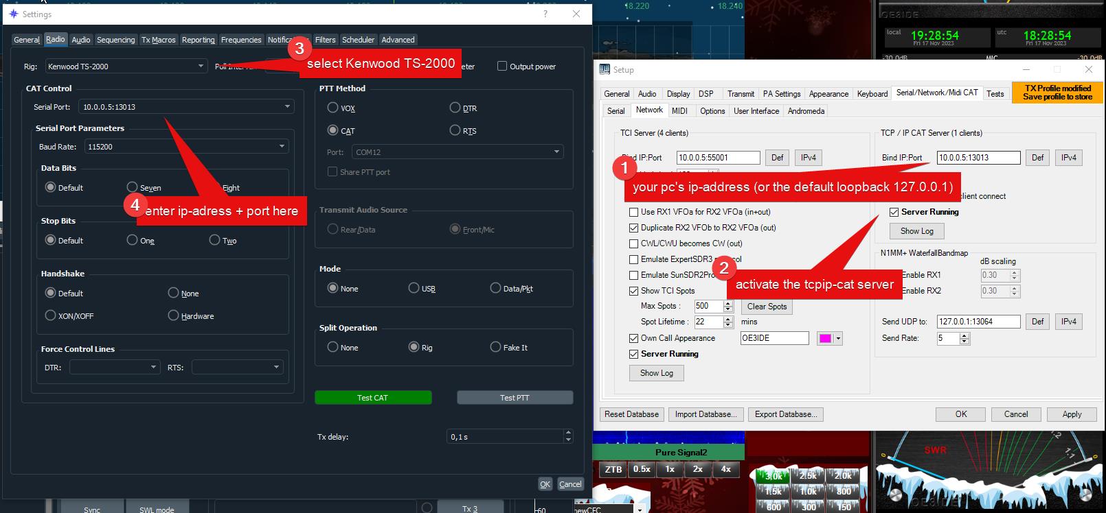

For WSJT-X you don't need any virtual serial ports. Activate TCPIP-Cat in Thetis and use the IP-address + port in WSJT-X.
