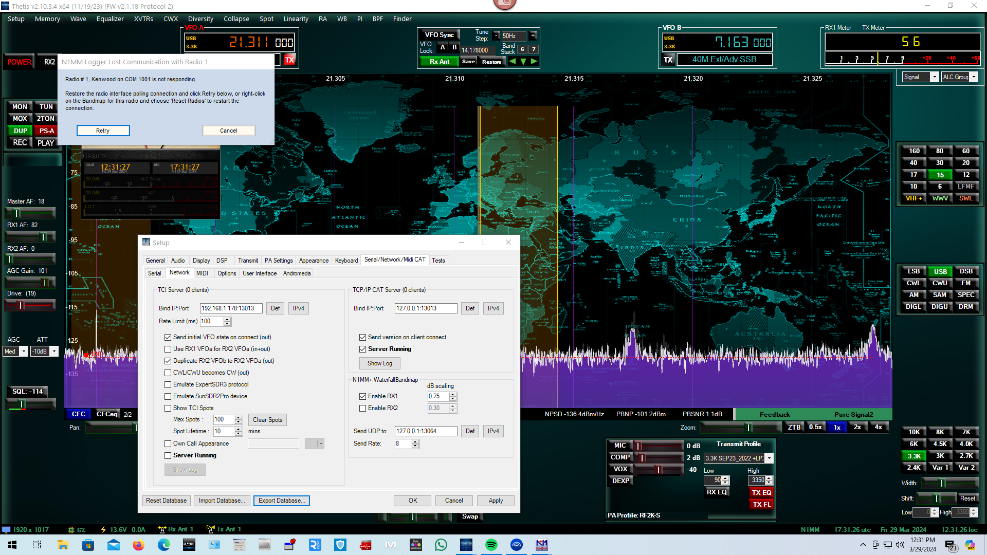

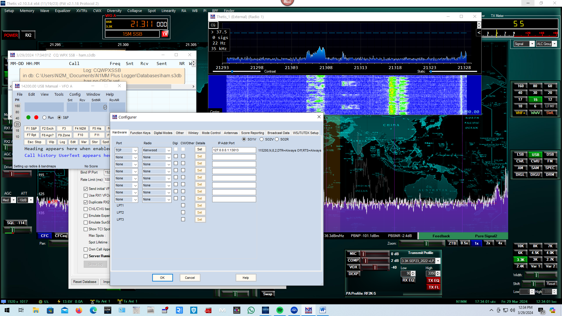

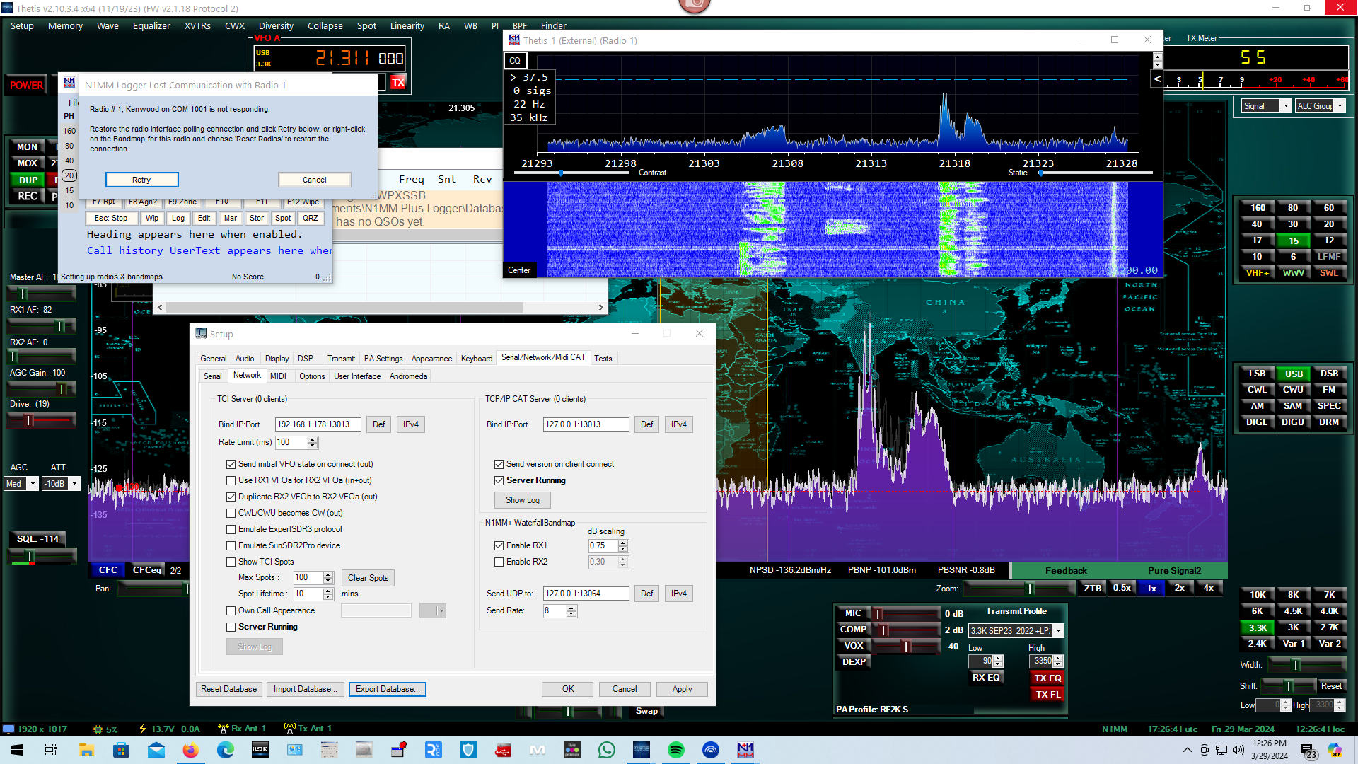

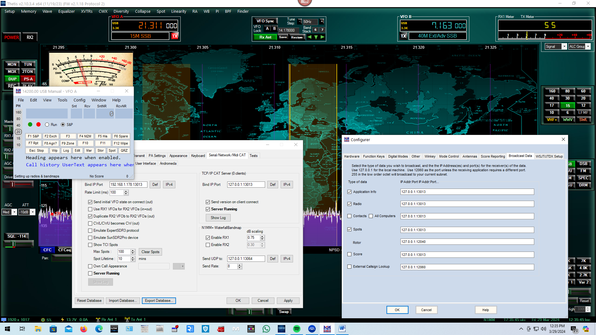

My screen-capture SW failed so I am inserting images using capture feature of Windows which explains partial redundancy. I believe that the IP addresses on the N1MM "Broadcasting" aren't correct at all which is caused by my lack of understanding of IP/Ports. :( The error message clearly says that Thetis and N1MM+ aren't communicating.

You've got quite a train wreck going on there! Everything is interfering with everything else because you are using the same ports everywhere.
You can't use the same port for both TCI and TCP. Make them different in Thetis. Adjust your other software and hardware as necessary to match your selections. TCI clients go to the TCI port, TCP (CAT) clients go to the TCP port.
You did a good job in choosing the external IP address binding for TCI since the amp is connecting to that from it's own IP. Similarly you did a good job of selecting the localhost IP address binding for TCP because N1MM and Thetis are running on the same PC. But the ports need to be different.
The broadcast tab in N1MM offers no functionality that Thetis can exploit and that should be put back to the default of 12060.
TCI has nothing to do with VNC. They can be used separately or together to control the amp however you wish, but they are not interdependent.

Juha has an extra zero in the N1MM configuration window.
Should be 127.0.0.1:13013 not 127.0.0.0.1:13013
