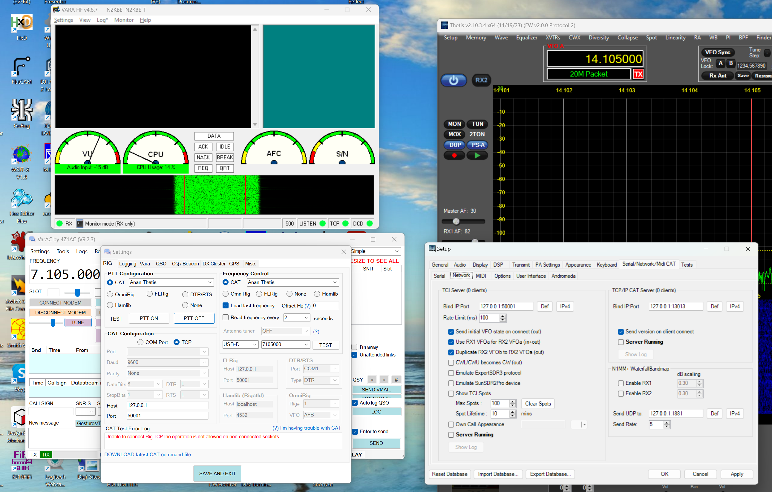

I am trying to get the Vara HF program configured on my Anan-G2. The input/output audio is working with Thetis, just not the rig control (PTT and Frequency control). Please take a look at my screen grab, and try to see what I am doing wrong, or if I am totally not even close to getting it working.
John

YOu have the port for TCI configured in the VARA software. VARA is using TCP NOT TCI for comms.
According to your Thetis set up the port in the VARA SW should be 13013.
And you should select "Server Running" in Thetis under TCI/IP CAT server.
Give that a try.

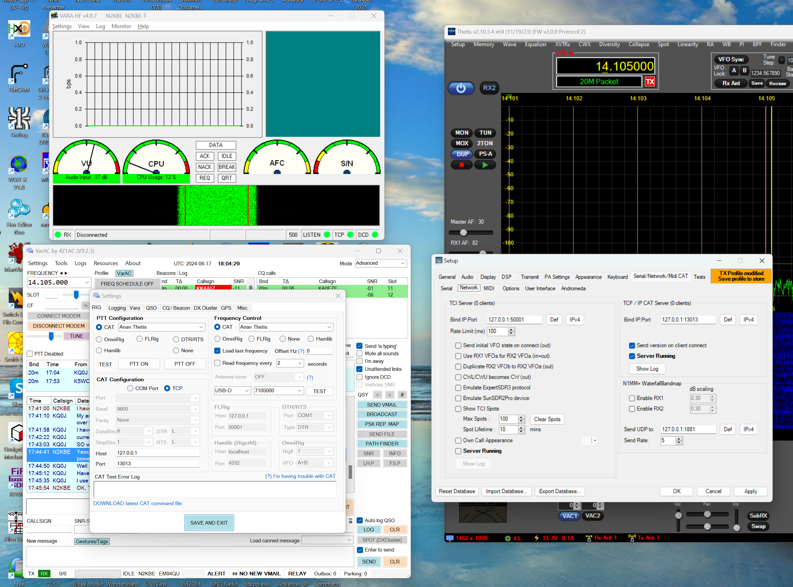

Hello Nigel,
Thanks for the advice, Thetis with Vara HF Modem/AC is now working! I have attached a screen grab with corrections, in case anyone else is interested.
John
Vara HF Config.png (1.57 MiB) Viewed 7537 times
