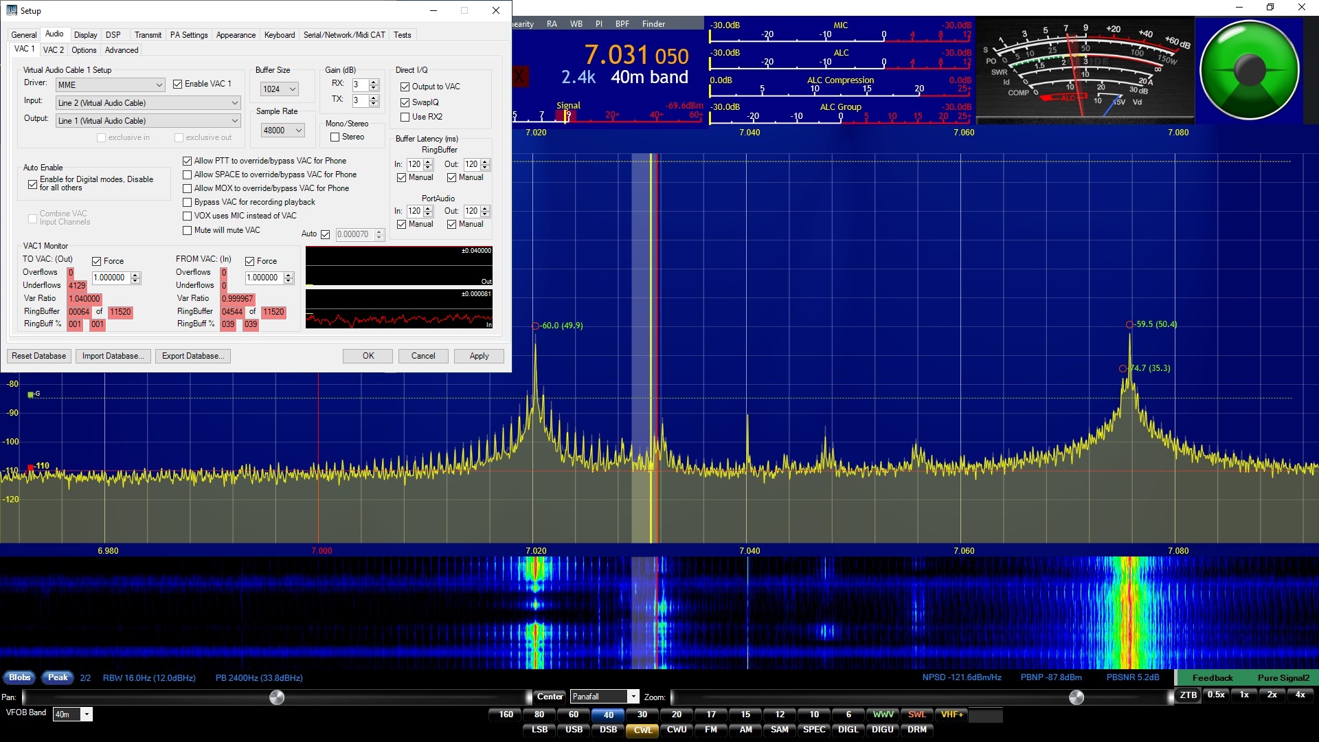

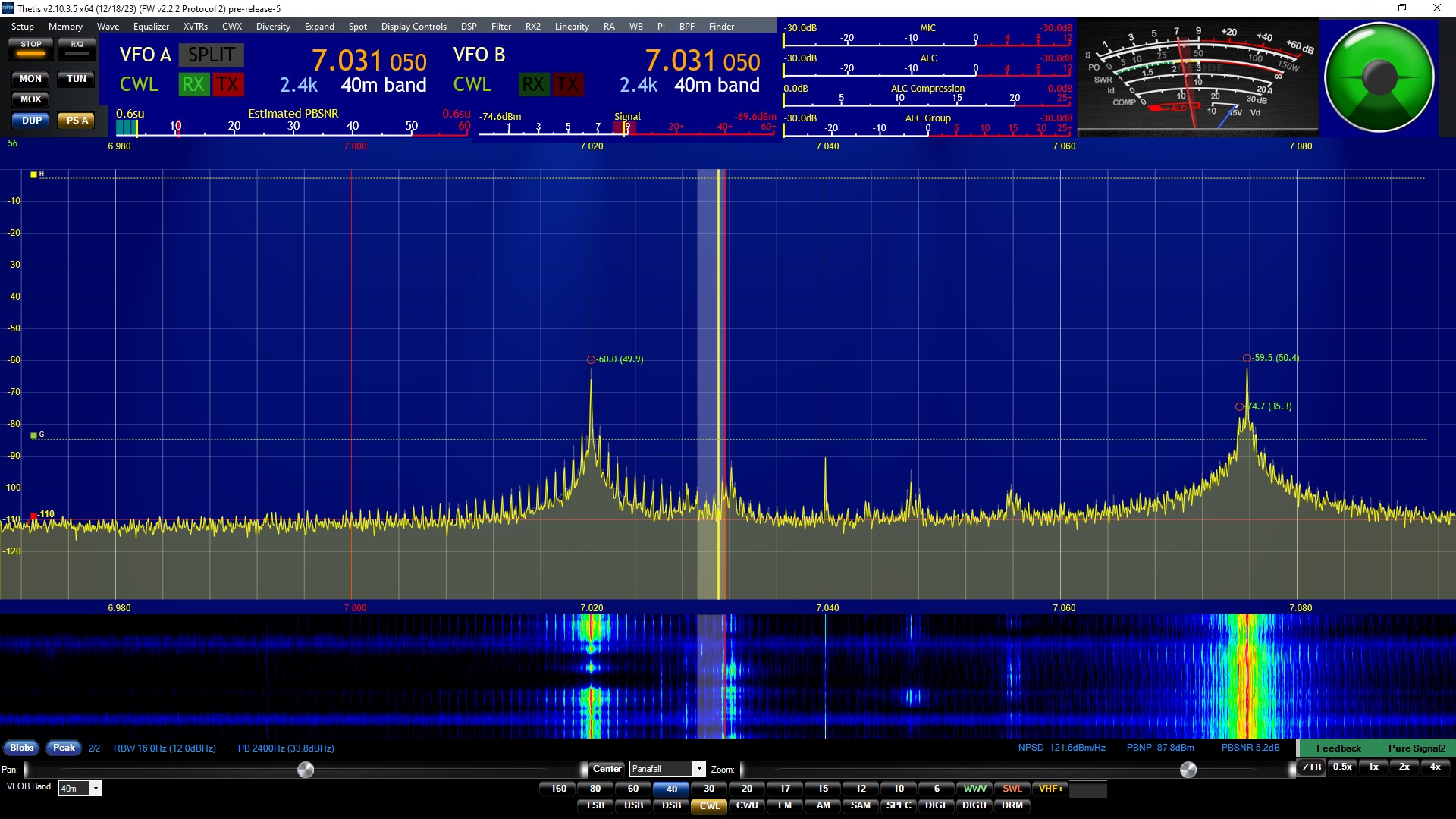

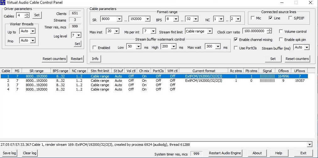

When activating IQ in the Audio Setup window, spurs are observed on the panoramic display and no CW decoding occurs in Skimmer (see images below). I have also included my Audio setup screen captures.
Anything obvious that would contaminate the IQ stream?

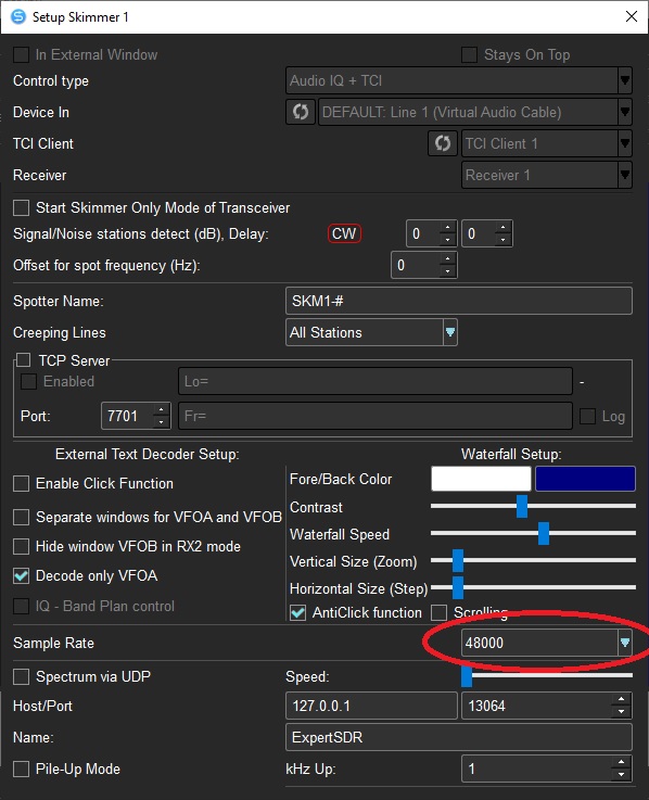

You didn't post a screen shot of the Skimmer side setup. The VAC cables are setting themselves to 192KHz, not 48KHz, and the under and overflow counters are running wild. Check your sample rate in Skimmer and ensure it matches with Thetis.
You might also leave all the buffer controls in Thetis set to automatic unless there is some compelling reason not to.

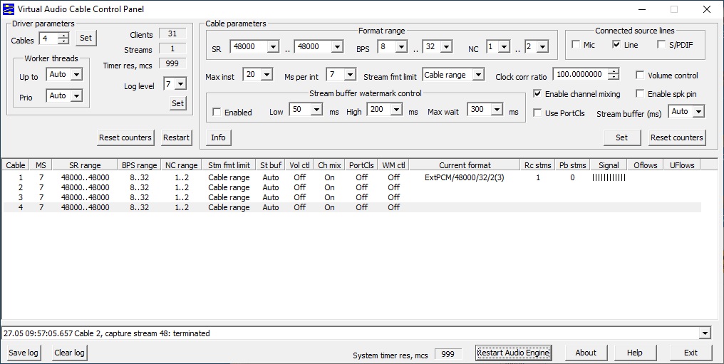

The VAC range was set early on to accept 8 kHz to 196K sample rates. That was from Nigel, a long time ago. However, I just forced all VAC cables to a 48 kHz SR and the overflows stopped. That corrects the spur problem but there's still no decode.
CW Skimmer is integrated with SDC software. Setup images attached.

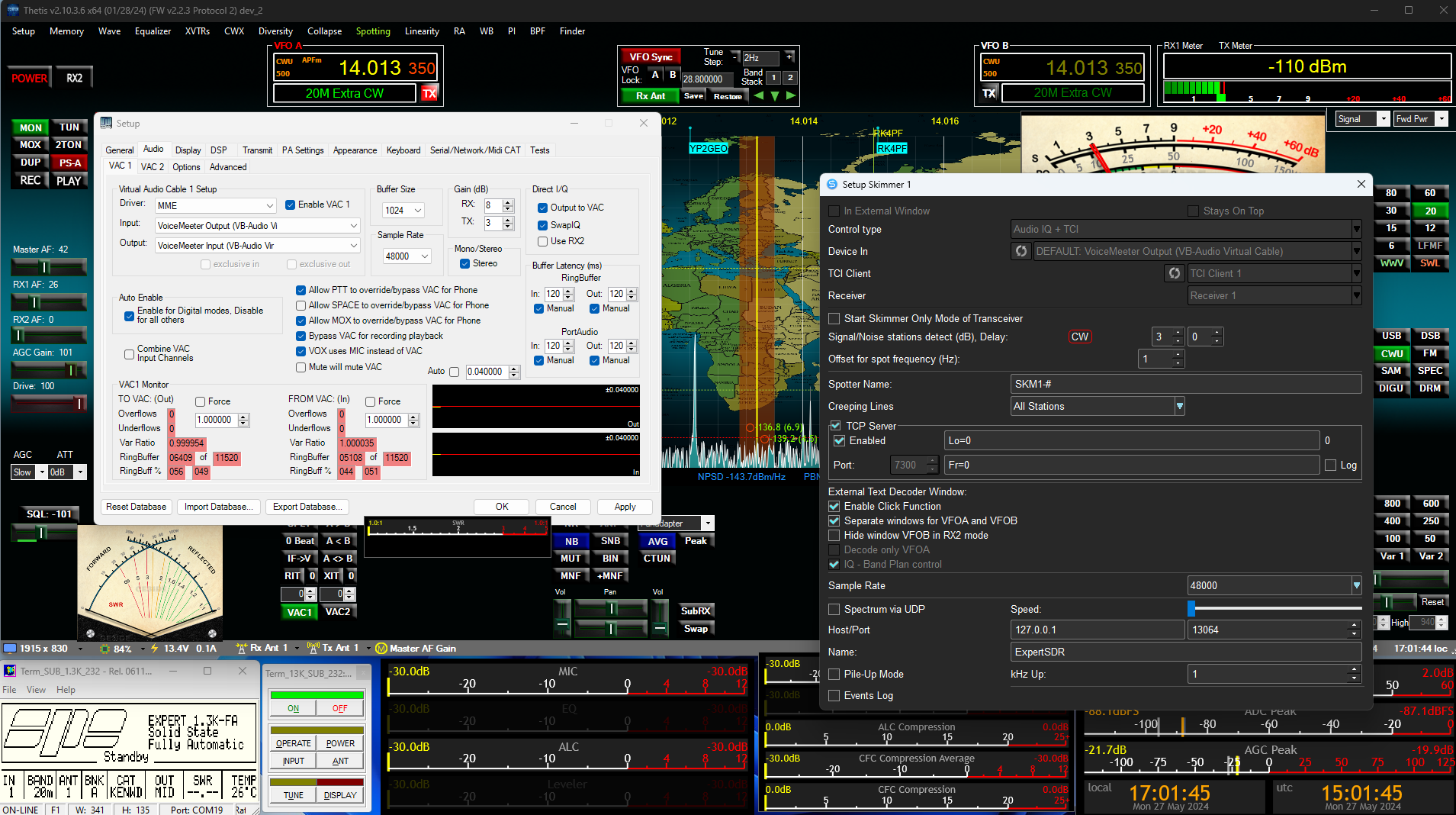

Here are my settings. Using VoiceMeeter VAC. Works great.
Thetis SDC.png (679.48 KiB) Viewed 15293 times

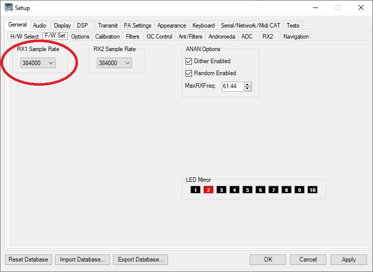

I finally solved the IQ output problem by reducing the Rx1 sample rate from 1.536 Mbps to 384 kbps. Until then, no real progress was being made.
Thetis version: 2.10.3.5
P2 FW: 2.2.2
Thetis FW Set.jpg (67.94 KiB) Viewed 15189 times

I had same issue and reducing sample rate solved it.
Probably protocol 2 is not so stable on my 7000 DLE Mk II.
