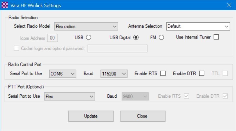

These are the settings I use. Obviously your COM port setting may vary...

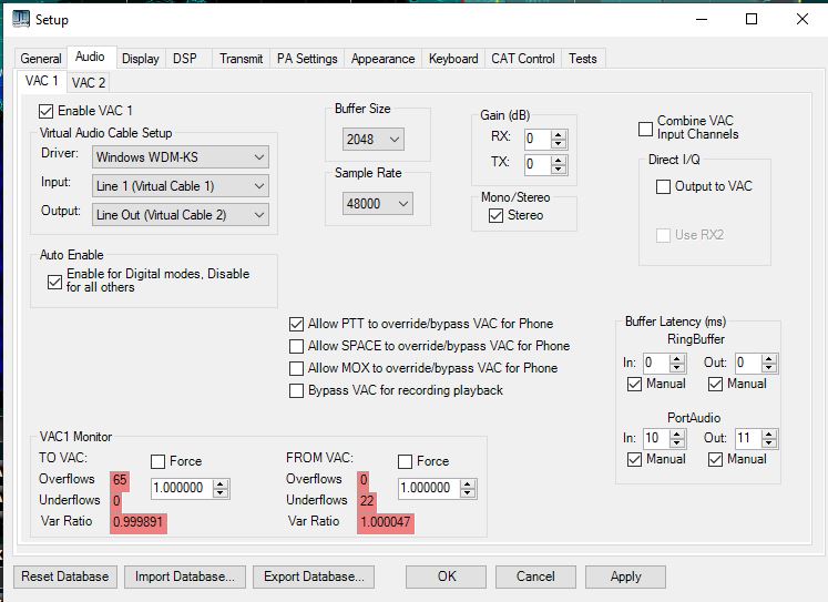

Many thanks for the settings. PTT is working now and with some info from the thread here I managed that WinLink and Vara are working :) I attached my VAC settings and WSJT-X is still working without reconfiguration.
