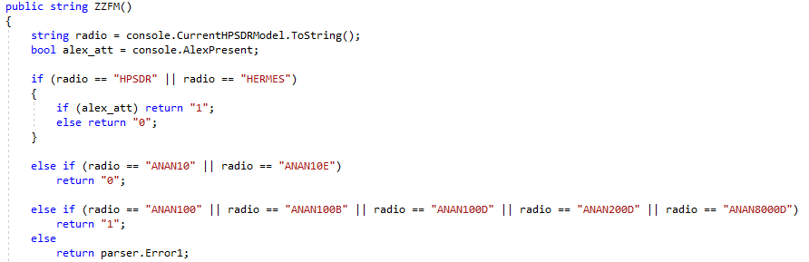

Zigi, that confirms that FxPad is also "looking" for the radio type but i wonder how you get a 0 or 1 on a ZZFM request?
When i use the CAT command tester build in Thetis it returns a "?" ZZSN works fine.
Re: Bob S Meter
ZZFM works in my case like it is in the code snippet. Except the "alex_att" portion if Hermes is choosen. No matter Alex is active or not, Thetis returns ZZFM1. If Anan-10 or -10E is choosen ZZFM returns 0, all other Models (except Anan-7000DLE) returns 1. Only Anan-7000DLE returns ?.
Not surprising, the Anan-7000DLE is not included in the code snippet. That should be changed.
So it looks like you are using a 7000DLE.
Btw. In PowerSDR it works (alex_att) as it should. Anan-7000DLE not confirmed/tested.

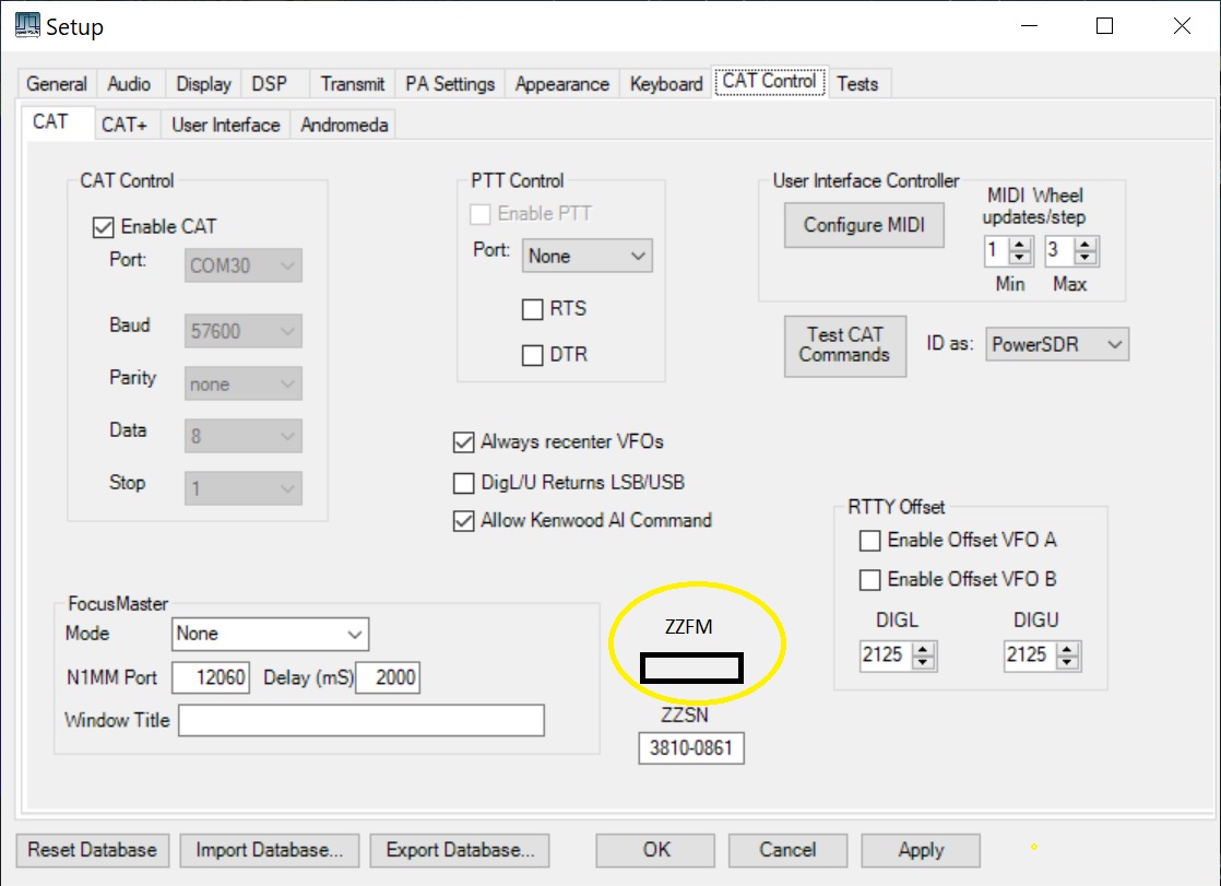

Hopefully there's a developer following this tread who's willing to make a little change in Thetis so ZZFM returns a "1" for 7k's. Or better, for future use, see pict
Thanks again Sigi!

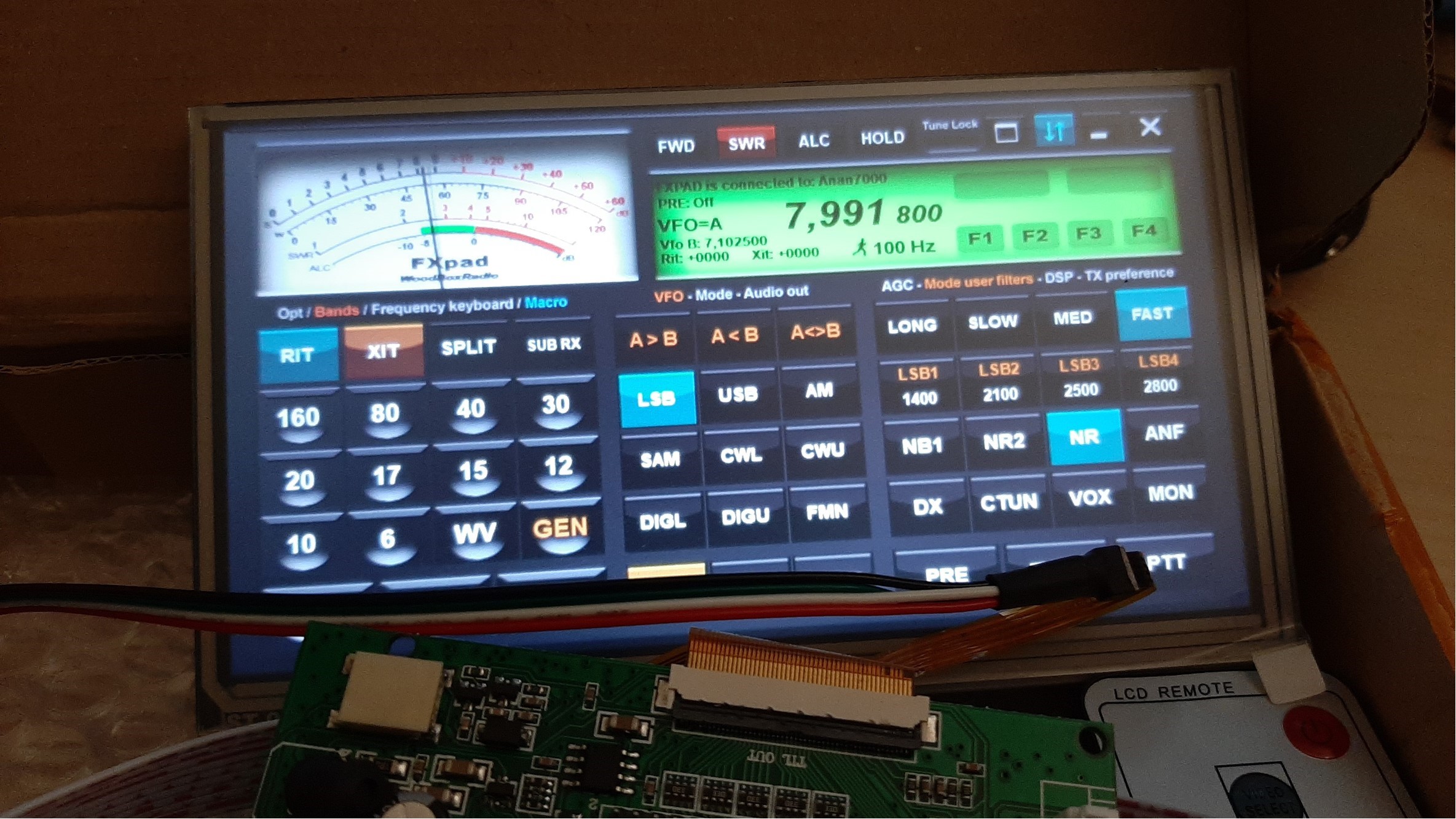

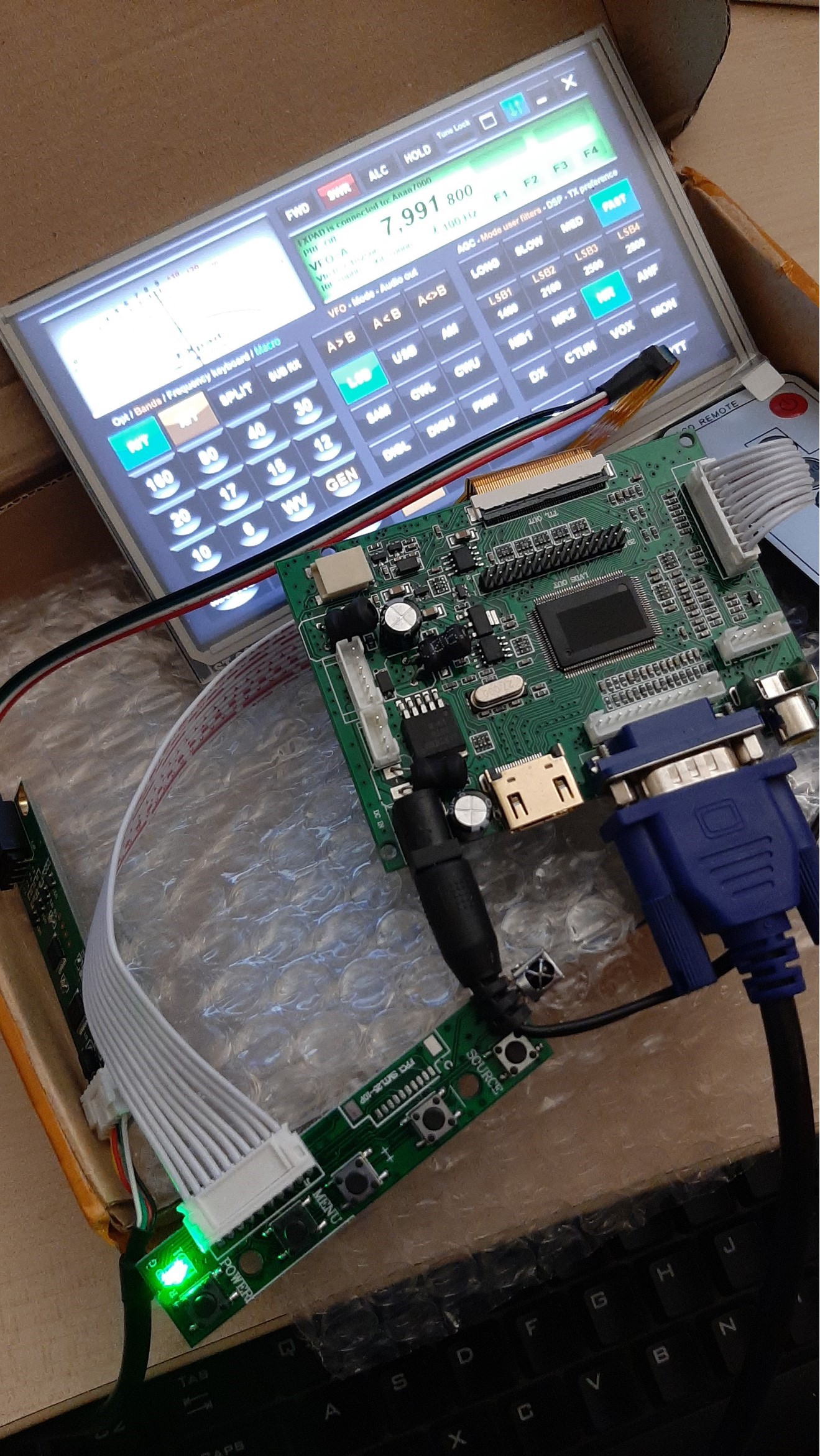

FXpad working!
Got FXpad working on a small touchscreen, together with Thetis
Connected to the VGA port on the motherboard and works nicely alongside two HDMI monitors connected to the graphic card.
The size of the visual screen is 16 cm, the outside measurement is 17,5 cm (6,9”) both diagonal. The sharpness is surprising good for such a little 800x480 screen. Next ... finding a housing that can hold the pcb's too. 73's PD3LK
