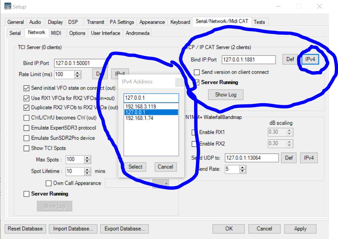

Step 1: set the Andromeda PC to static IP addressing if it is not already. DHCP addressing will allow that IP to change and that can't be allowed. There are a million web articles on how to do this in Windows, just Google it if you don't know how.
Step 2: restart Thetis on Andromeda (or just reboot the entire machine).
Step 3: in Thetis go to the pictured setup screen, hit the IPv4 button, select the IP that looks like it goes with your network (not the 127.0.0.1 address). That should go into the "Bind IP:Port" box. Make note of that address and the port (it won't be the same as mine).
Step 4: in the same setup screen, enable the Server Running checkbox.
Step 5: in the pictured N1MM setup screen make the selections as depicted, but use the IP:Port address from Step 3 above (again, don't use my address, it won't be the same).

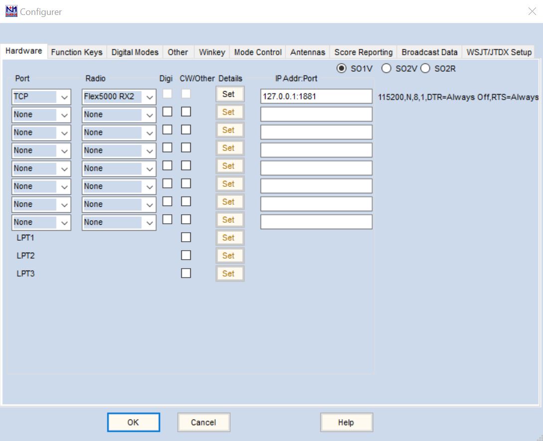

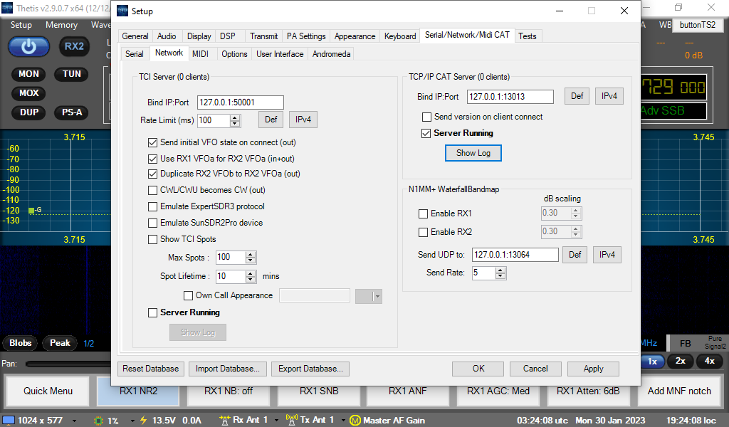

Firewall has been disabled on both machines and I even tried to reset the database. I can ping Andromeda from my N1MM machine and also tried a few different port numbers.
Here are the screen shots.
73 de va7qi, ....Erik.
Re: Interfacing Thetis to N1MM?
Yes, sir, a picture is worth a thousand words!
It seems you missed, or misunderstood, "Step 3" from my post above. I'll repeat it here with some bolding for emphasis...
That address should be the one you've got in N1MM. And port, too, of course.
You'll need to unclick and reclick the Server Running checkbox to make the new address setting active, I think. Or just quit and restart Thetis.

Well, some progress. After changing the IP address to Andromeda's WiFi interface, I saw that RX2 got turned off by N1MM. It - once - set the frequency to the default for 80 m (3600), but never read the frequency from the radio when I changed it - and I still get the same error on N1MM.
It is almost as if packets are lost, but I never see any other network issue and I can ping the radio from the computer that hosts N1MM with return time 1 mS.
I just looked at the N1MM server log on Thetis. It shows interrogation by N1MM, but it responds with the frequency of RX2 although N1MM has turned RX2 off. It looks like N1MM is not getting this data. I'll have to play with port numbers and review the firewall settings as well as my LAN switches. The radio and computer are on different switches, but the switches are connected.
