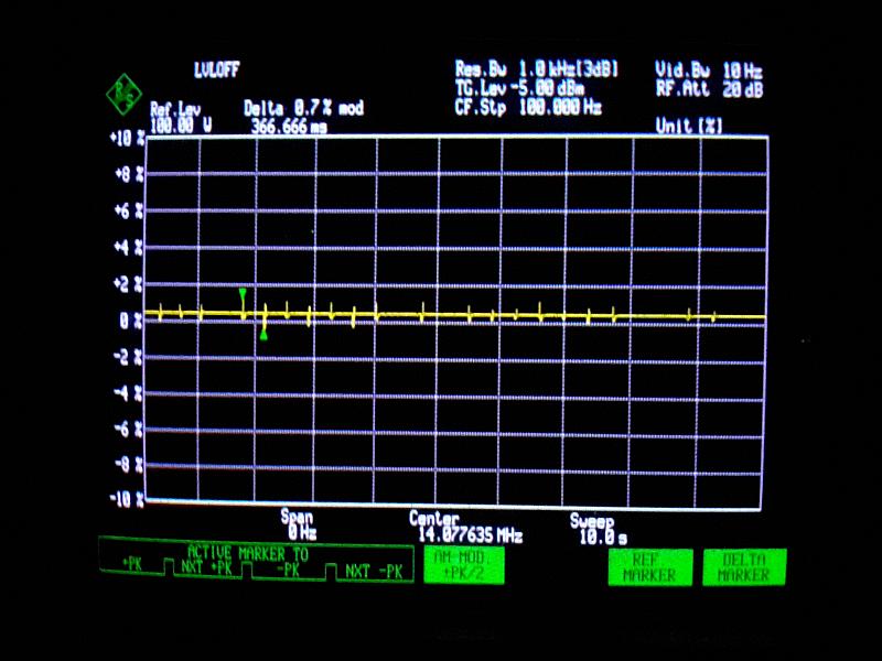

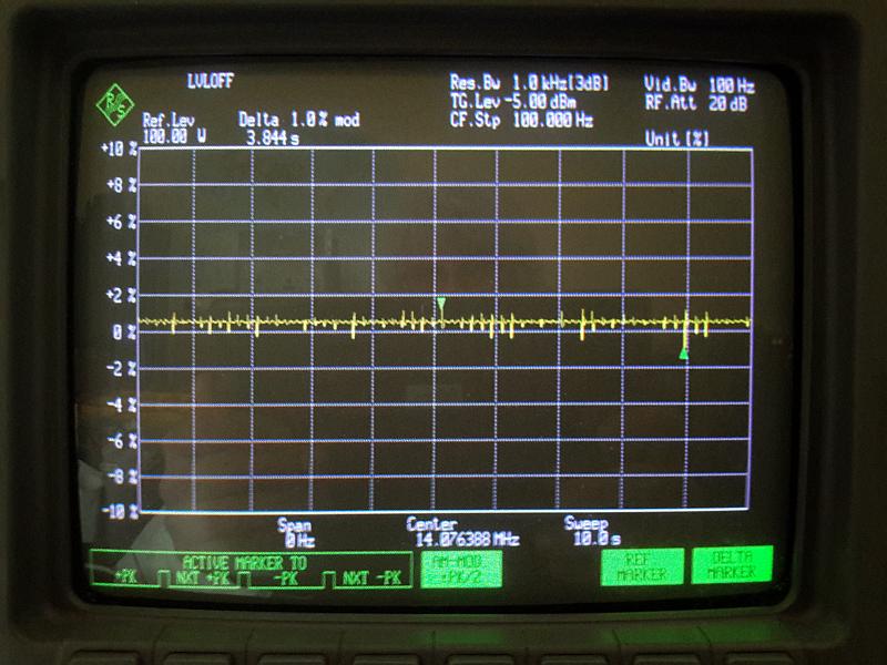

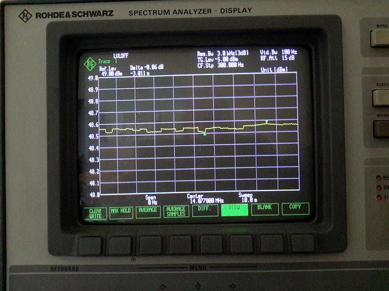

Here are the results of the requested measurements.
Analyser is Rohde&Schwarz FSAS in Receiver-Mode (AM-Demodulation).
JT65 shows the usual phase jumps at frequency transitions but a straight line between them:

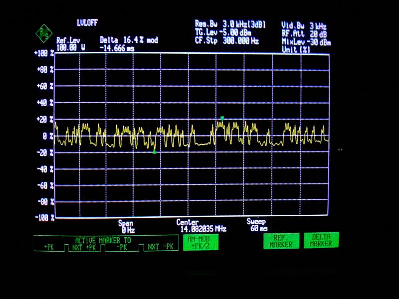

MSK144 has AM components of about 16% as expected.
Note the changed scaling and timebase.

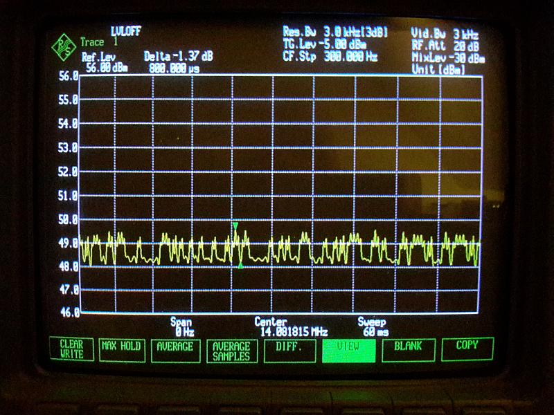

MSK144 on logaritmic scale, this is only 1.4 dB peak.

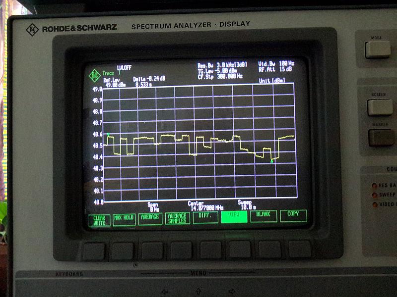

there is virtually no difference in PAPR of MSK144 between WSJT-X and MSHV.
But there are much differences in signal quality.
Second harmonic of 1kHz Tone (Tune Mode) @ -1dBfs:
WSJTX: -98 dBc
MSHV: -45 dBc
Frequency response (JT65 @ 1kHz AF) is worse too.
WSJT-X: 0.06 dB peak
MSHV: 0.24 dB peak
Below zero spans (JT65) over 10s with high amplitude resolution:
