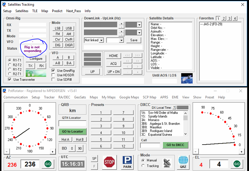

I have try to use Omnirig to controll my PSTrotator software, I have setup a virituel com 7 and made in HPSDR CAT 7 I turn on and name it Kenwood-2000.... then I turn on PSTrotator and it this I set it to use Omnirig in the setup (when I wil use Sattelite tracking) but it say that the transiver is connected.......
Any help here ????

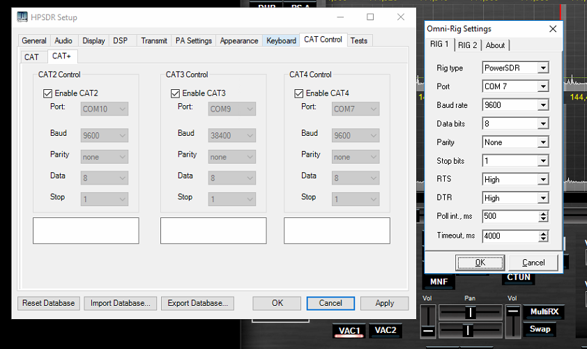

Ben--there's not enough information in your post to identify the problem. There could literally be twenty different possible answers.
Does Omnirig connect to PowerSDR?
Please post screen shots of your Omnirig setup screen, your PowerSDR CAT setup screen, and the setup screen of the virtual serial port software you are using. Then we can see what you did right, and what you did wrong.

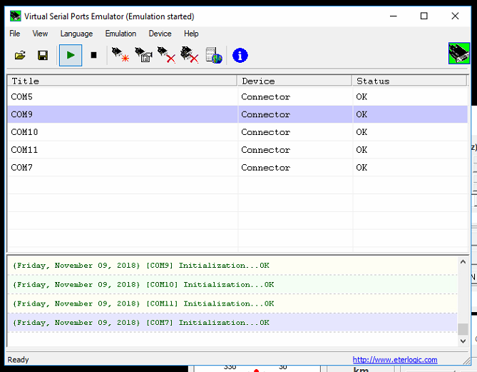

Here is 3 photo of my setup ...and in the PSTrotator-sat-setup.png file you can see that it wil not connect to HPSDR via omnirig :oops:

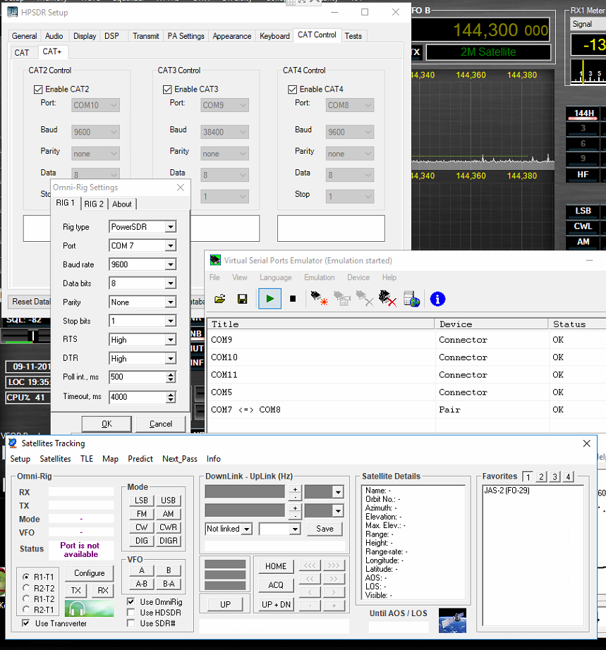

Your VSPE setup is wrong. You need to use a "pair", not a "connector".
Set up a pair of ports. Assign one port of the pair to PowerSDR, the other to Omnirig.

I made the port as you write....but still not working...look at picture Omnirig-2error.PNG

When you get a "port is not available" error, that means that piece of software has not given up the port properly. You can restart the suspect software, or sometimes it is just simpler and better to reboot and start from scratch.

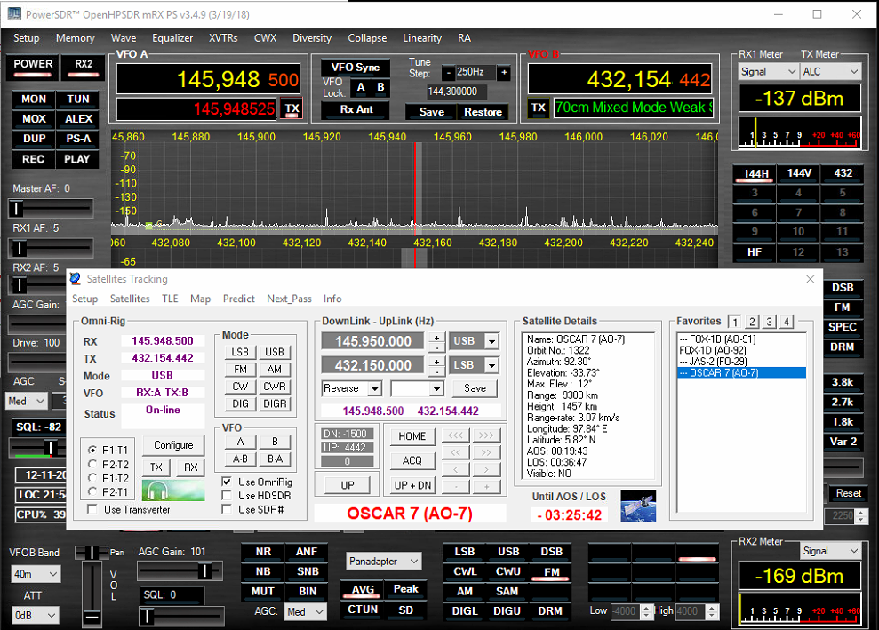

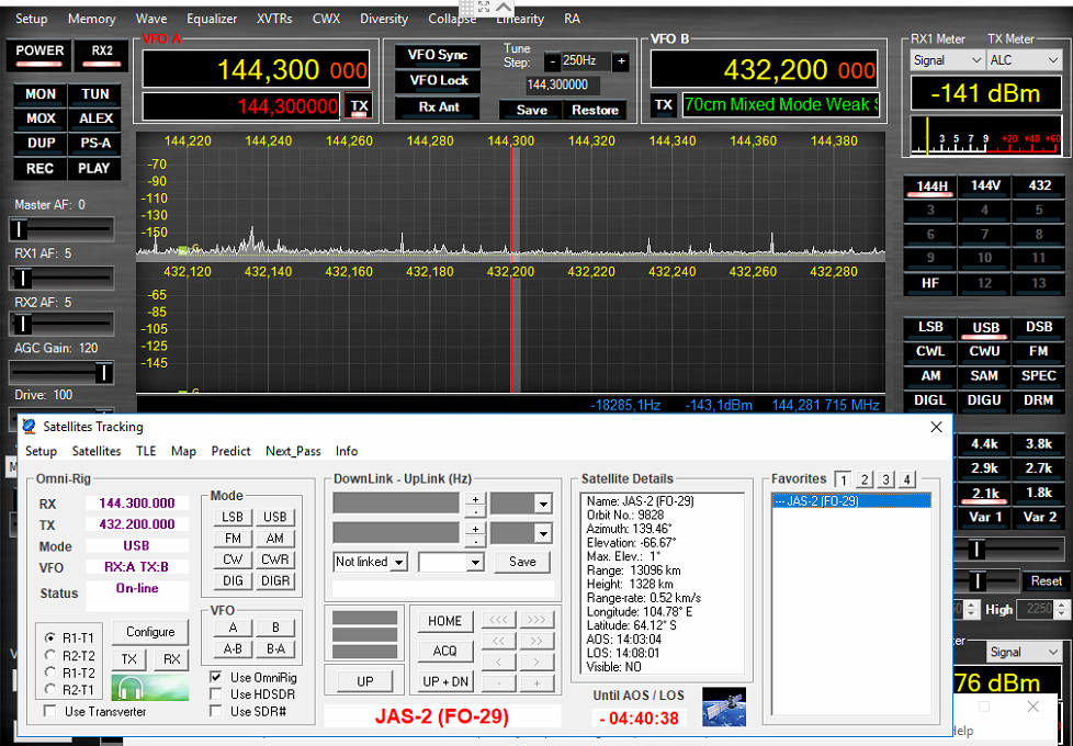

IT WORKS NOW :-)
I have downgrad HPSDR from 3.4.9 to 3.4.7 and then I start first PSTrotator and then HPSDR then it works :-)

I have now install HPSDR 3.4.9 and you have to as this to get it to work:
1. Start your vituell comport and staus in monitor has to be "Ready" ( I use http://www.eterlogic.com/ )
2. then start PSTrotator whit Satellite tracking on, and config it to "PowerSDR" and Com:7 9600 Baud
3. then start HPSDR whit CAT interface as PowerSDR at Com:8 9600 Baud
then you wil get it to work :D :D :D
if you stop the tracking and wanted to start agn....you have to do step 1 to 3.....
73" Ben
