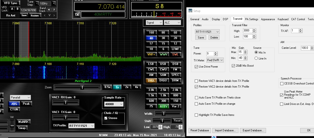

I am looking for assistance with Thetis (v2.8.11 x64 protocol 2 v2.1.18 / 21k7) settings for N1MM / RTTY usage. I am interested in receiving information about Transmit Filter and Width/Shift.
Currently, I am using IC7610 for RTTY. Any recommendation / suggestion is appreciated.

I've only been on RTTY with the 7000DLE MKII "Black" rig for a few months.
I use N1MM with 2Tone as my main encoder / decoder and MMTTY as a secondary decoder.
With 2Tone I use DOOK as the transmit AFSK generator as the 2Tone author says it's narrow bandwidth and friendlier to nearby hams.
Right now I have my transmit filters set to 2600 and 770 according to my notes. I'm not in my shack to know for sure!
Maybe we can make a sched and compare how the signals decode / look on the bandscope.
