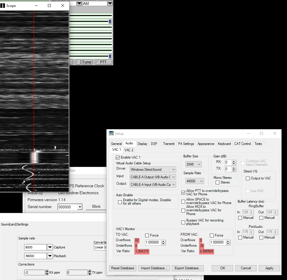

I fired up the other day and saw the signals on the waterfall wobbling all over, so I ran the WWV cal in fldigi again and it looks like a squiggly s-curve down the display.
I'm familiar with it being on an angle either way and shifting ppm to calibrate, but I've never seen it as a squiggly varying line before on any rig.

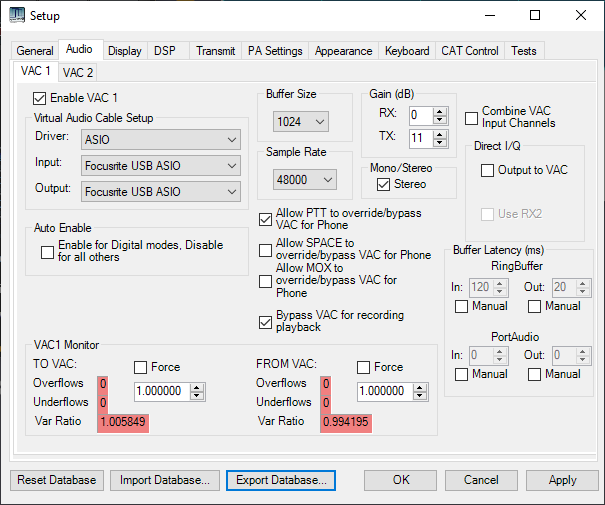

Please post a screen shot of your Thetis VAC setup window. It may be that the resampler is running in an unstable fashion for you. Do you see increasing under or overrun counters when this is occurring?

I get the same behavior if I don't force the VAC1 Monitor "TO VAC:"
I'm using Eltima VBCable. Is there some other setting to change?

w-u-2-o wrote:Please post a screen shot of your Thetis VAC setup window. It may be that the resampler is running in an unstable fashion for you. Do you see increasing under or overrun counters when this is occurring?
No, I'm familiar with that. I tried shifting sample rate and buffers around even.
I have the issue whether buffer is in manual or unchecked and the VAC1 Monitor To and From are both unchecked for the force boxes.
The setup tab shot is with me operating SSB at this moment, the only change to it is instead of the ASIO, it would have MME or Direct Sound with a virtual audio cable selected.
No underrun or overflow issues.

I had this instability problem poke its head up again and I think I finally have it nailed.
I toggled the buffer latency to manual and dialed them in and I also toggled both Force options in VAC1 Monitor section, checking the Force box.
It's dead stable.
I think due to vagaries of other apps running on the PC that having the resampler enabled fouls it up.
This drove me crazy for a long time, hope it helps someone else.
