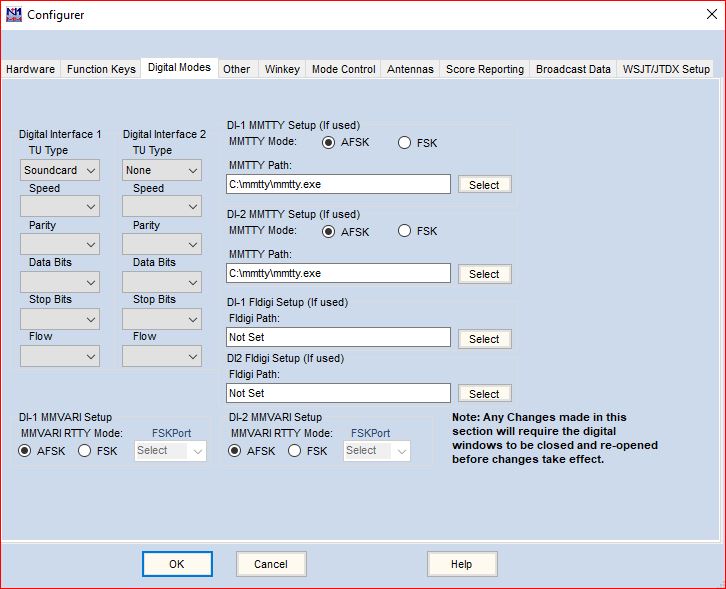

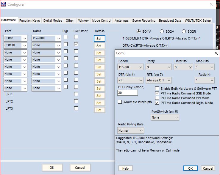

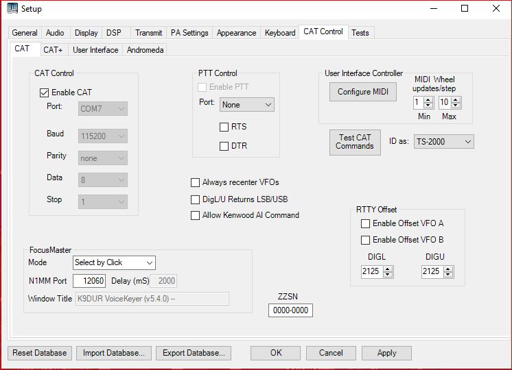

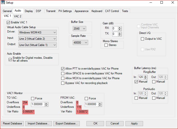

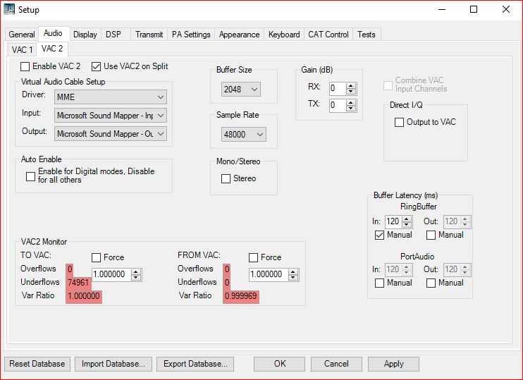

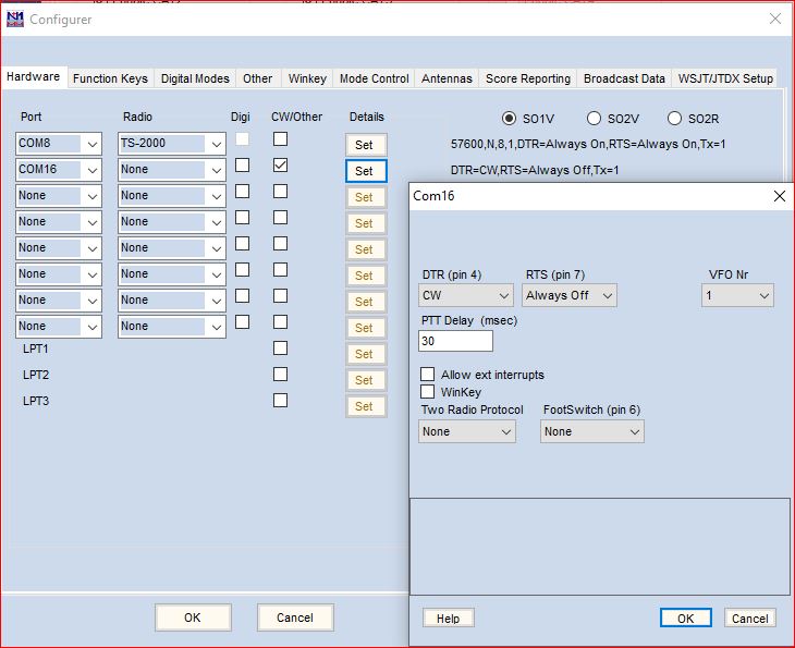

I have decided to use DVK function of N1MM+ and I am stuck with how to setup CAT / VAC so that .wav files can be transmitted using associated F keys Attached, Please find the screenshots of Thetis and N1MM.
I am using all virtual com ports as Pairs and have read elsewhere that setup as connector and splitter may help should I decided to use other software's without stopping CAT in one of the program or closing them before using the other program.
DVK is setup and all .wav files have been created and working when clicking F keys (Playing on PC's speaker) PTT of the radio is being triggered but no power is going out. Please see the screen shots of my setup and suggest what change do I need to do to make it work?

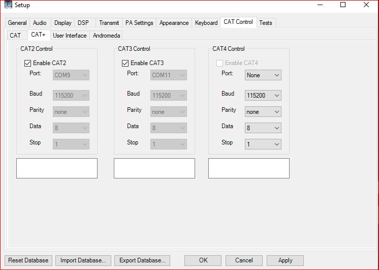

- Thetis CAT 1 settings.JPG (67.53 KiB) Viewed 5351 times
- Thetis CAT+ settings.JPG (53.93 KiB) Viewed 5351 times

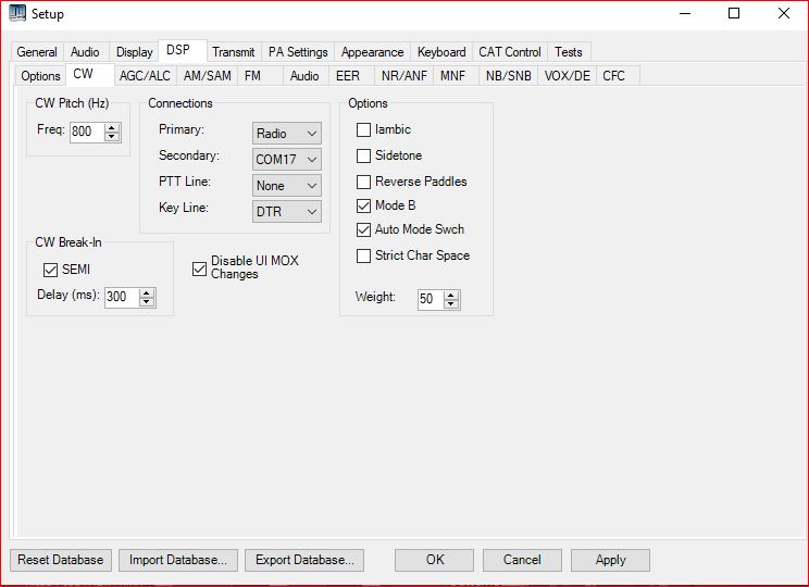

- Thetis DSP CW settings.JPG (53.61 KiB) Viewed 5351 times

You should only need virtual serial port pairs to make this work. You did not say what your specific port pairs were, but in general your serial connection setup looks fine and you say the radio is keying, which is a good sign that it is working fine.
What does not appear to be setup correctly are the virtual audio cables:
- Thetis VAC1 looks fine.
- Thetis VAC2 is unnecessary as it cannot be used for transmitting, so those settings do not matter.
- You are showing the N1MM Digital Mode setup tab, and that also is a "don't care", it has nothing to do with voice keying.
What is missing is you have not posted the N1MM setup tabs located in Config > Logger+ Audio Setup. Those are the settings that need to match up with your Thetis VAC1 settings. Since you say that you have successfully made recordings, you should probably look at Config > Logger+ Audio Setup > Playback. Select "S01V/S02V Single Soundcard". Below that, based on your VAC1 screenshot, select "Line 2 Virtual Cable 2" (or whatever the closest equivalent is, since Windows sound device names seem to be shown differently in every application).

Sorry for late reply. Just now saw your post. I needed to change N1MM+ to "PTT via radio command" under set up. Once I did that it worked well. Thought I could record messages using Voicemeeter through 7000 but couldn't get that to work so recorded through computer sound card. Later learned to normalize using Windows Wave Pad editor. Seems to be all working now.
