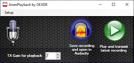

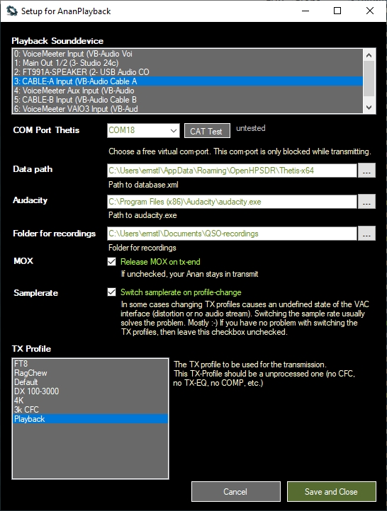

I created a little tool for playback of the Thetis-Recording file (SDRQuickAudio.wav in data-folder).
What does this tool?
Green Play Button:
1) switch to the desired playback tx-profile (configured via setup) (current profile is "remembered")
2) switch MOX ON and plays the SDRQuickAudio.wav
4) switch MOX OFF
5) switch back to the previous tx-profile
Thetis Button:
1) asks for a filename. ie. "oe3ide"
2) copies the SDRQuickAudio.wav to your desired location (configure via setup).. i.e. c:\recordings\oe3ide.wav
3) opens the copied file with Audacity
Still some work to do - mostly error-handling.. I guess it will be ready in July 2021 ... of course free of charge :-)

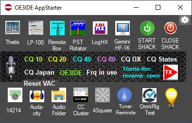

The goal for this tool is, to replay a recorded station with a special (unprocessed) tx-profile. A part from the code is from my own tool ("Appstarter"). With my old radio (FT-2000) I have sent the replay-audio to the USB input (SCU-17, unpocessed).
