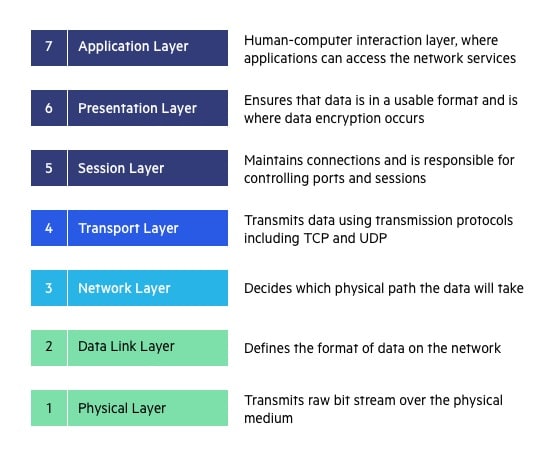

Postby w-u-2-o » Mon Feb 07, 2022 3:35 pm
oe3ide wrote:@Scott: Would you be so kind and move this post to the TCI-Tread? Thank you!
IMHO we need only one tcp-port for TCI and it would be nice if we didn't have to sacrifice a serial port for this.
I can't see why "sacrificing" one of four ports is a problem? Particularly if all ports could be set to either serial or IP mode.
I am not sure, if the N1MM tcp/cat implementation meets any existing "standards".
There's no special standard required, per se. CAT is already the message payload standard, that continues unchanged, and the IP socket/port standard is what it is. Don't overcomplicate this.
An IP port interface is one thing. CAT and TCI over that port are apples and oranges, or chalk and cheese, or whatever they say in your neck of the woods. TCI could easily work over RS232 serial or IP. Since Thetis already supports CAT if you add the IP port capability you then get CAT for free via that kind of connection. TCI is an entirely different protocol that would have to be added. But one step at a time. First let's get the IP port interface.
In other words: don't conflate TCI with IP port comm's.
Another way to understand this: the serial port (real or virtual) and the IP port comprise layers 1-4 of the OSI model. CAT and TCI comprise layers 5-7.
