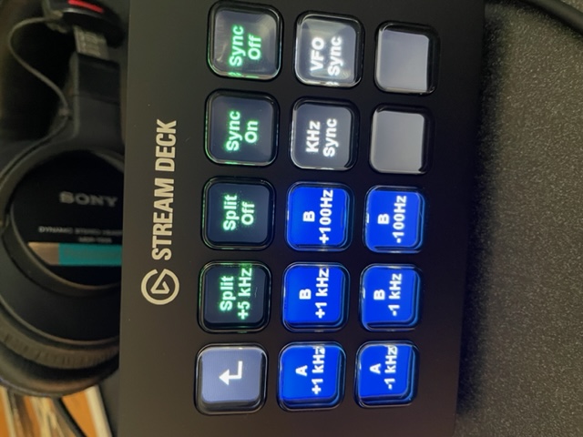

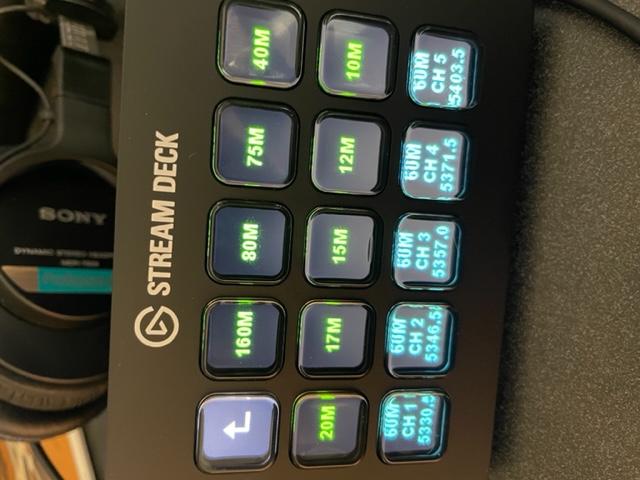

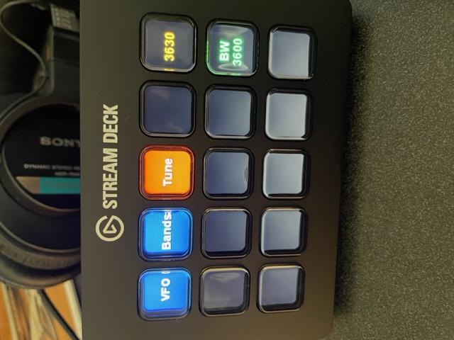

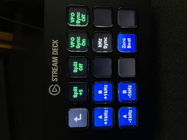

Postby w9ac » Sat Feb 19, 2022 6:09 pm
Photos attached. The camera angle distorts some of the labels.
The top image shows the home layer, followed by the VFO and Bands sub-layers. Gary created this hierarchy to get many more functions out of 15 buttons.
Anyway, this is a good start..

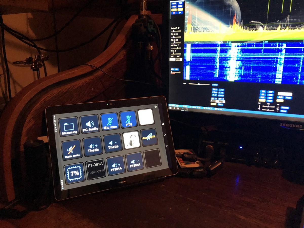

I am using only the StreamDeck app and a cheap 10" android tablet (it was a free gift for an internet package). PC software to configure is the same as for the physical deck.
Android is tuned (auto startup, disabled display saver, etc.)
The app connects via network (wifi) to the PC where the StreamDeck-software is running.

The pictures above that Paul W9AC posted are the layout on a 15 button StreamDeck

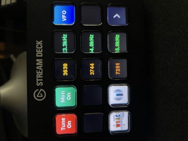

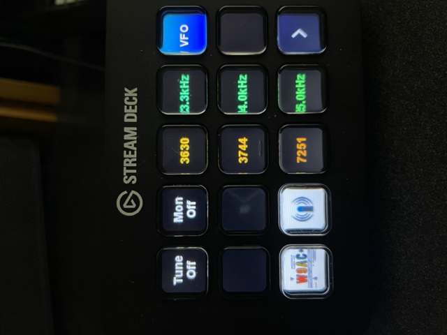

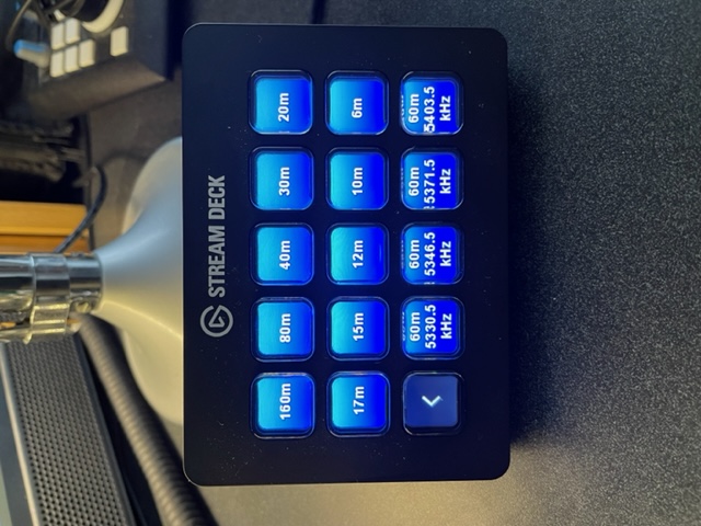

Postby w9ac » Tue Apr 26, 2022 5:18 pm
Some interesting features were recently added to my Stream Deck. In the images below, you'll see how the TUNE and MON functions are managed. Instead of separate On/Off buttons, Stream Deck has a multi-switch utility that allows for multiple switch states from one button (like a MIDI controller). Button text and background color is also differentiated based on the state of the switch. The switch buttons appear to show some astigmatism, but that's a byproduct of the camera angle.
Also seen are web-based buttons. The button with my QSL card image is a direct link to my QRZ page. Next to it is a button with a small Apache Labs logo. That button launches the web browser straight to the community forum.
On the HF band page, note that the 60m FT8 channel is missing. That mode isn't part of my operating vocabulary. Even if it was, digital software would automatically set the 60m channel.
