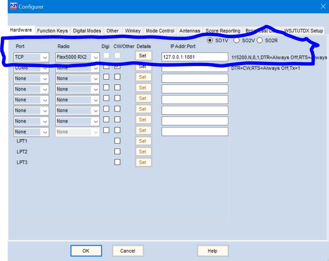

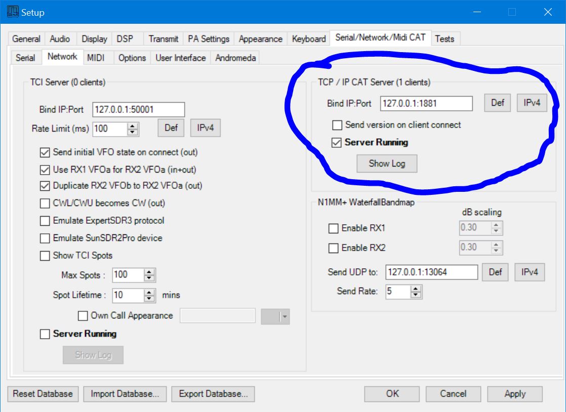

1. In Thetis go to Setup > Serial/Network/Midi CAT > Network, set the TCP/IP CAT Server to 127.0.0.1 (and a custom port if you wish, I changed it but you can use the default), and enable the "Server Running" checkbox.
2. In N1MM, go to Config > Configure ports... and choose port type TCP, Flex5000 RX2, and put in the IP and port that is assigned in Thetis. Click the "Set" button to adjust your PTT preferences as desired (the serial port parameters shouldn't matter).
That's it, it should just work.

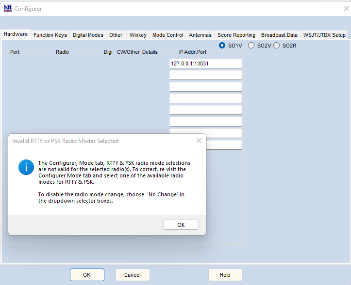

Still no joy with this. Here are the relevant screens:
I don't know what that error popup is referring to.
Any help please?
Andy EI5JGN
Any help please?
Andy EI5JGN

You have port 13031 instead of 13013 . Radio selection should be TS-2000.

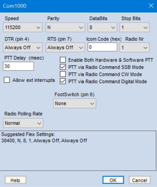

For CW support you need to set up a virtual serial port pair (virtual serial cable) connection. Assign one of the ports for CW interfacing in N1MM. Assign the other port for CW interfacing in Thetis. So you will need to install virtual serial port software first, then set up a port pair (virtual cable), then configure both app's.
More information on how to configure N1MM and Thetis for CW keying is in this topic: viewtopic.php?f=16&t=3975&p=17250
That topic is a bit old so you will have to ignore the parts about using a serial connection for basic rig/logger control. However the parts associated with CW keying setup are still the same.

Thanks. I figured it out. I did not have the server running box checked. Thanks for your help.
