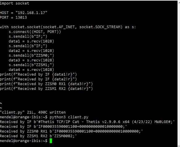

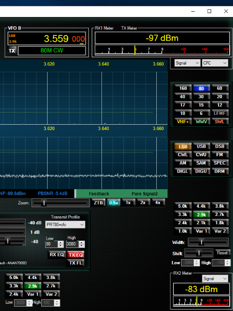

Today, for my project I try to read S-meter level of Thetis. However I couldn't succeed in it completely. For my case, ZZSM0 doesn't work, but ZZSM1 seems to be working.
I attached a very simple Python3 socket program to show this status as well as Thetis Rx meter screenshot. You can see the CAT responses.

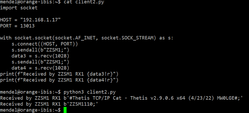

Re: Thetis ZZSM0 not working on TCP/IP CAT
Hello All,
My post has been resolved. My code of Python was not adequate.
I confirmed the very correct reply from Thetis regarding ZZSM0/ZZSM1.
Therefore I can proceed to the next step of my project.
So far I used to use C# socket program. Python is quite convenient, but is very new to me.
FYI, I attached the reply from Thetis.

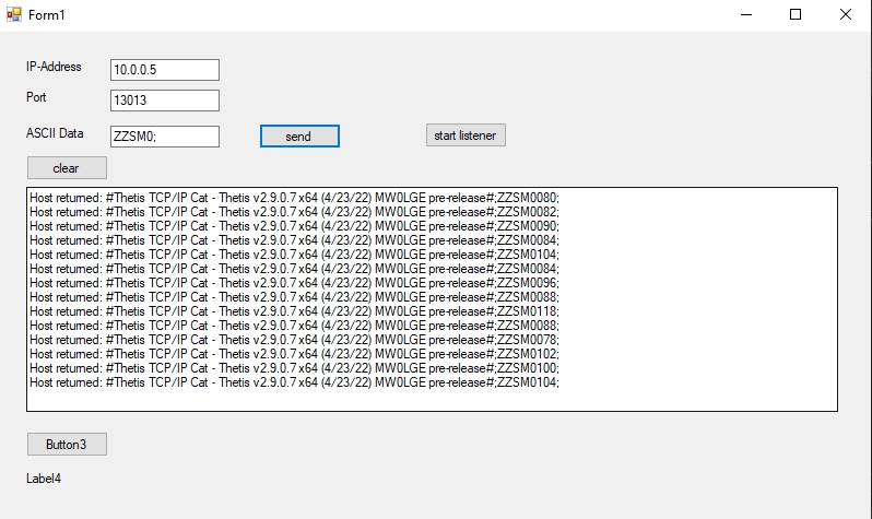

Works as expected here (.net)
