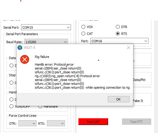

Anyone want to take a stab at this? Working fine until it didnt. Rig Failure message from WSJT-X . Thought maybe I lost the database in Thetis so reInstalled a previous saved version, didnt help, checked Thetis Cat Control settings and PTT settings, they are good, they match WSJT-X, settings in in the General, radio, audio and advanced tabs. Did a clean new install of WSJT-X Vers 2.5.4 no joy same results Here is the Rig Failure message from WSJT-X

Looking at your WSJT-x radio setup rings alarm bells with me.
Is there a reason to be usiing a different/second com port and RTS for PTT Method ?
Normally, WSJT-x and JDTX etc all run fine with CAT selected for PTT Method.
