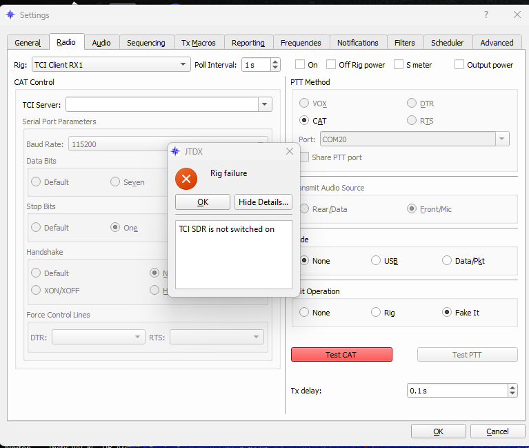

Dear Scott,
Initially, I could not understand how JTDX support TCI as is as there is only CAT settings. I searched and found 2 videos first by our superhero @mw0lge Richie and the second one by N8SDR. Richie did not show any setup though and was running 2 copies of JTDX connected to RX1 & RX2
https://www.youtube.com/watch?v=l-8ttd_4_u0
https://www.youtube.com/watch?v=xiihF5aikKg&t=342s
N8SDR shows that one needs to select TCI as a radio from the radio dropdown list instead of Kenwood TH2000 as we normally do with our sdr.
I did that as he suggested but once I press "Test CAt" it failed and the reason that windows tell me that "TCI SDT is not switched on"
At this time my TunerReminder and Log4om2 both connected to Thetis using TCI and not CAT or hamlib / Omnirig and all these three programs working as they should.
Richie or anyone else may please guide me what am I doing wrong? A screenshot is attached.
Thank you & 73
Bhanu
VU2MB
Dear Scott,
Thank you & 73
Bhanu
VU2MB

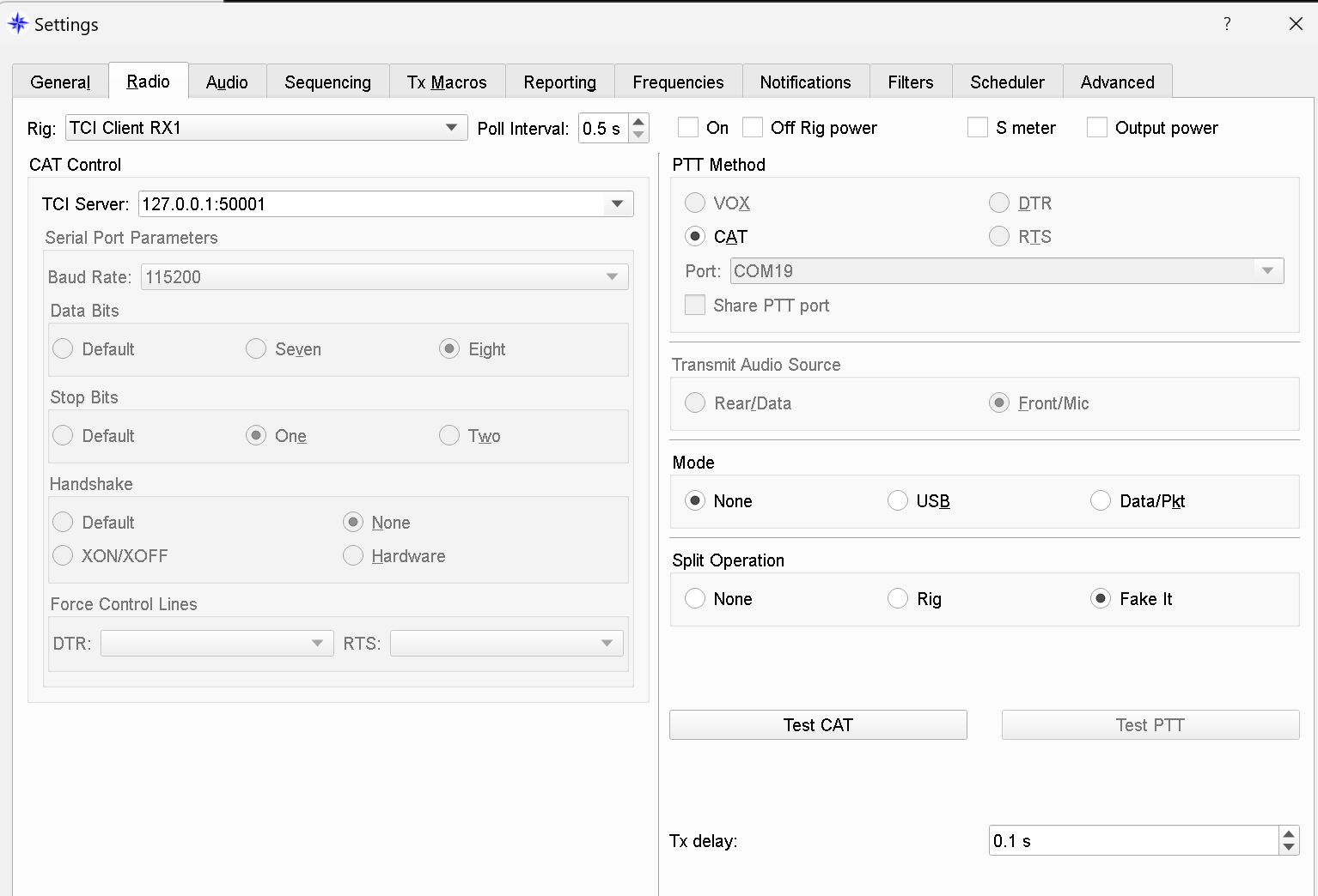

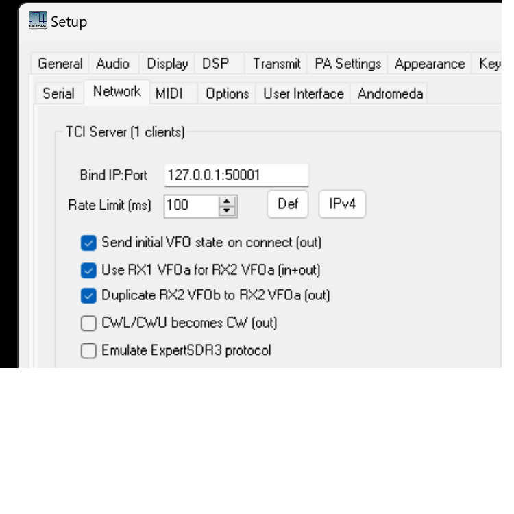

Re: TCI with WSJT JTAlert CW. How to setup?
You need to enter the TCI server details
- Untitled.png (48.71 KiB) Viewed 14414 times
- Untitled.png (51.81 KiB) Viewed 14414 times

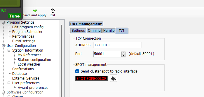

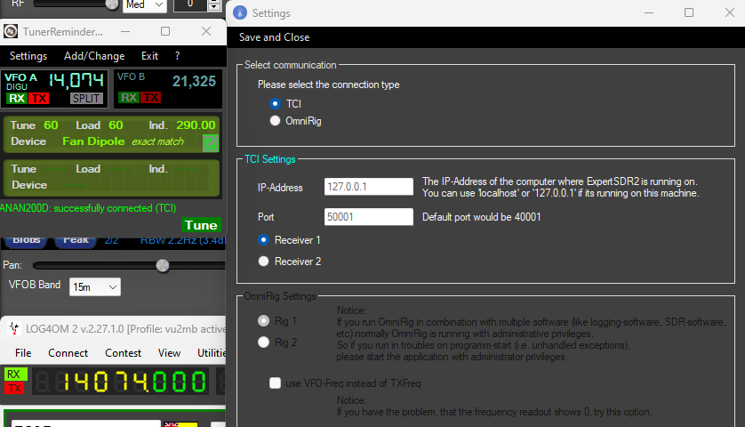

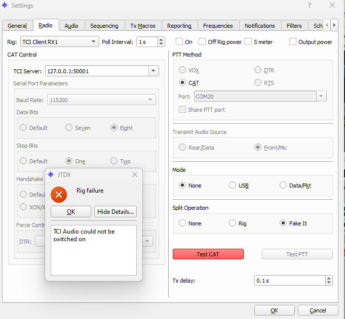

Dear Tony,
Thank you for your post.
I have added the TCI IP address in the JTDX radio tab but it did not make any difference. CAT Test(RCI) is failed yet again.
I am posting all the screenshots from Thetis, Log40m2, TunerReminder and JTDX.
See if still something missing.
Bhanu
Bhanu
Look at the very first tacked thread here: viewforum.php?f=16
TCI audio is not supported in Thetis yet. You still have to use VAC to move audio to/from other digi software.
If JTDX can use TCI for CAT and VAC for audio then perhaps you can get it to work. If selecting TCI in JTDX assumes/requires that TCI audio is also present then it's not going to work for you.

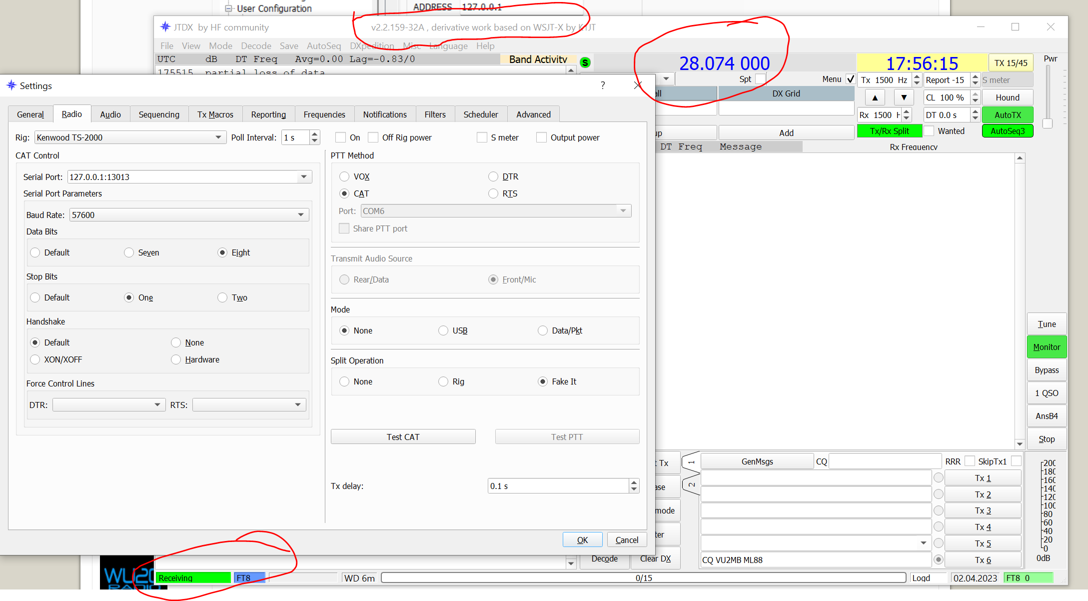

TCI is working with JTDX. I am not sure from which JTDX-version it runs stable, but on my setup it is working.
As alternative you can use the following setup:
1) activate "TCP/IP CAT Server" in Thetis (ie "127.0.0.1:13013")
2) in JTDX select Rig "Kenwood TS-2000" and for Serial Port enter "127.0.0.1:13013" ... yes instead of selecting a virtual com-port, just enter the ip:port
If you using TCI or TCPIP-CAT make sure you are using the correct ip-addresses (ip-loopback 127.0.0.1 or the "real" ip-address, here 10.0.0.5). Running TCPIP-CAT server on 127.0.0.1 and entering 10.0.0.5 in JTDX would not work.
73 de Ernst
73 de Ernst

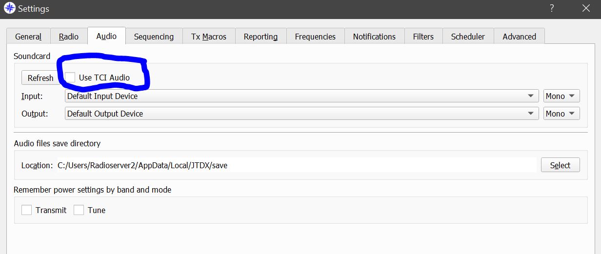

I just downloaded JTDX 2.2.159 from SourceForge, which appears to be the latest and greatest.
Just as I suspected, there is an option in the audio setup that needs to be properly addressed. Do NOT check that box. Instead you must set up some virtual audio cables to make the audio connection. Muzy VAC, VB Cable or Voicemeeter, whatever you prefer.

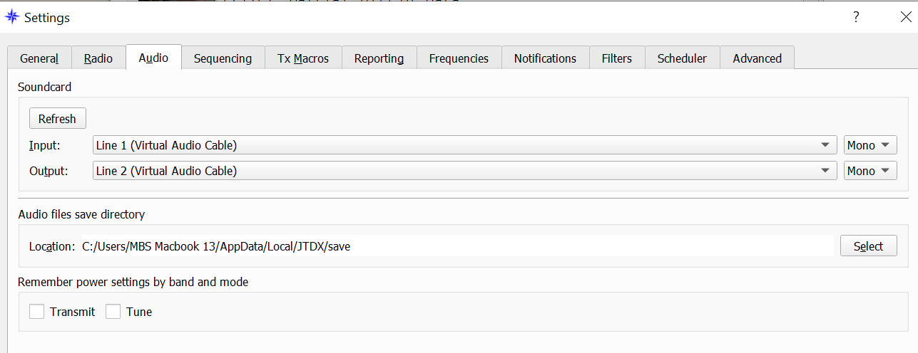

Dear Ernst & Scott,
Thank you for your input. My JTDX Version is the latest 2.2.159 32A
It's now working with the alternate arrangement by activating the TCP-IP server.
The audio settings I am using are old standard VAC and not TCI.
I would like to use the standard TCI though because running 2 instances may be easier choosing TCI RX1 & RX2 and what do I need to do using this way to run 2 instances
of JTDX for Rx1 & RX2 to monitor 2 bands for expeditions or wanted DX.
Here are my working screenshots.
thank you again.
Bhanu
VU2MB
thank you again.
Bhanu
VU2MB
