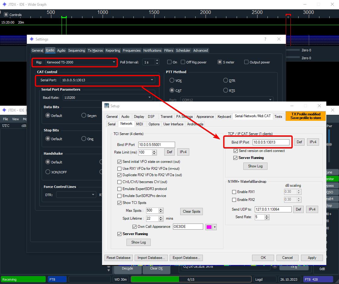

If TCI does not work for you, you can use TCPIP-Cat (only in JTDX afaik)
Re: JTDX jumps 500hz on TX
Postby Tony EI7BMB » Thu Oct 26, 2023 5:56 pm
Thanks Ernst, I'll try TCP/IP-Cat and see how that goes
Postby w-u-2-o » Thu Oct 26, 2023 6:40 pm
oe3ide wrote:If TCI does not work for you, you can use TCPIP-Cat (only in JTDX afaik)
It works in a lot of app's. It will work in anything that uses HamLib, such as Fldigi and WSJT-X. It also works in DX Labs, N1MM and other software.
See: viewtopic.php?f=22&t=4249&p=25803
Postby Tony EI7BMB » Thu Oct 26, 2023 6:42 pm
Thanks Scott FYI JTDX has a rig listing for FlexRadio/Anan PowerSDR/Thetis . I will test with that rig listing
Postby Tony EI7BMB » Sat Oct 28, 2023 2:02 pm
so far so good using TCP/IP-Cat
