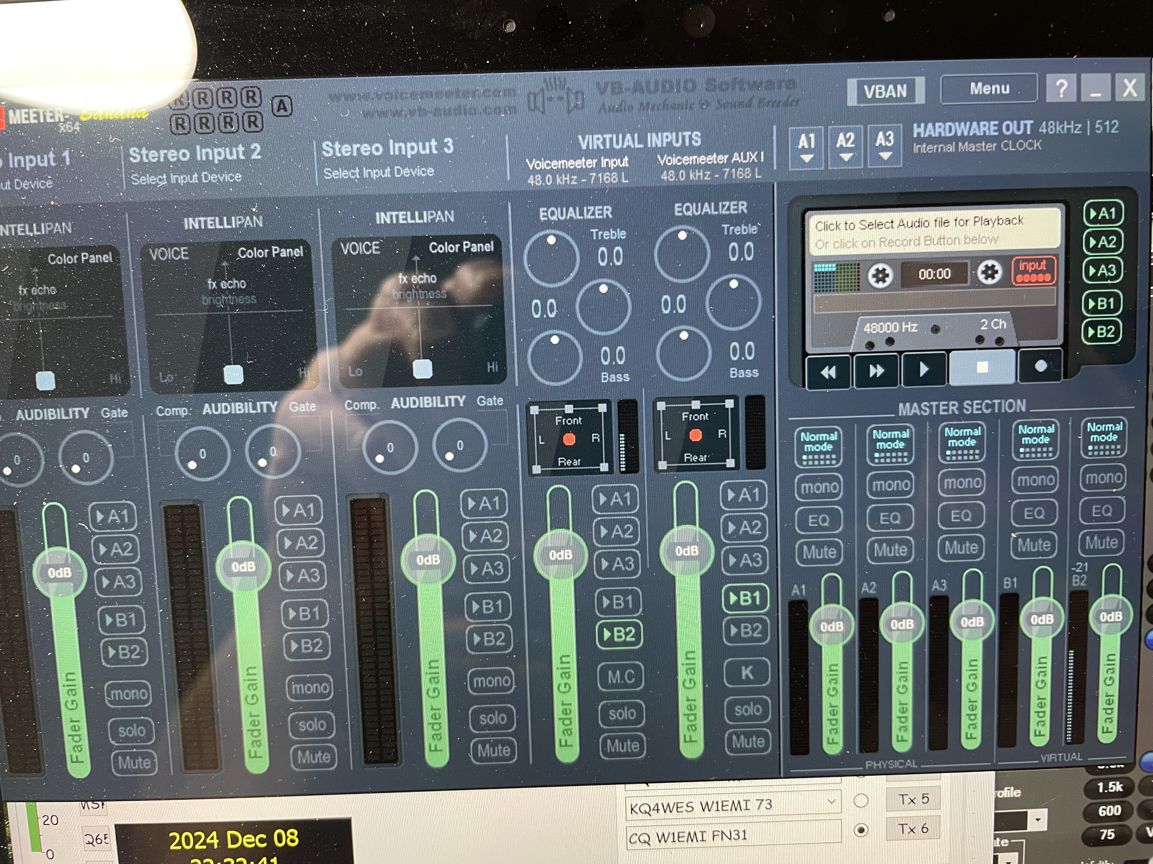

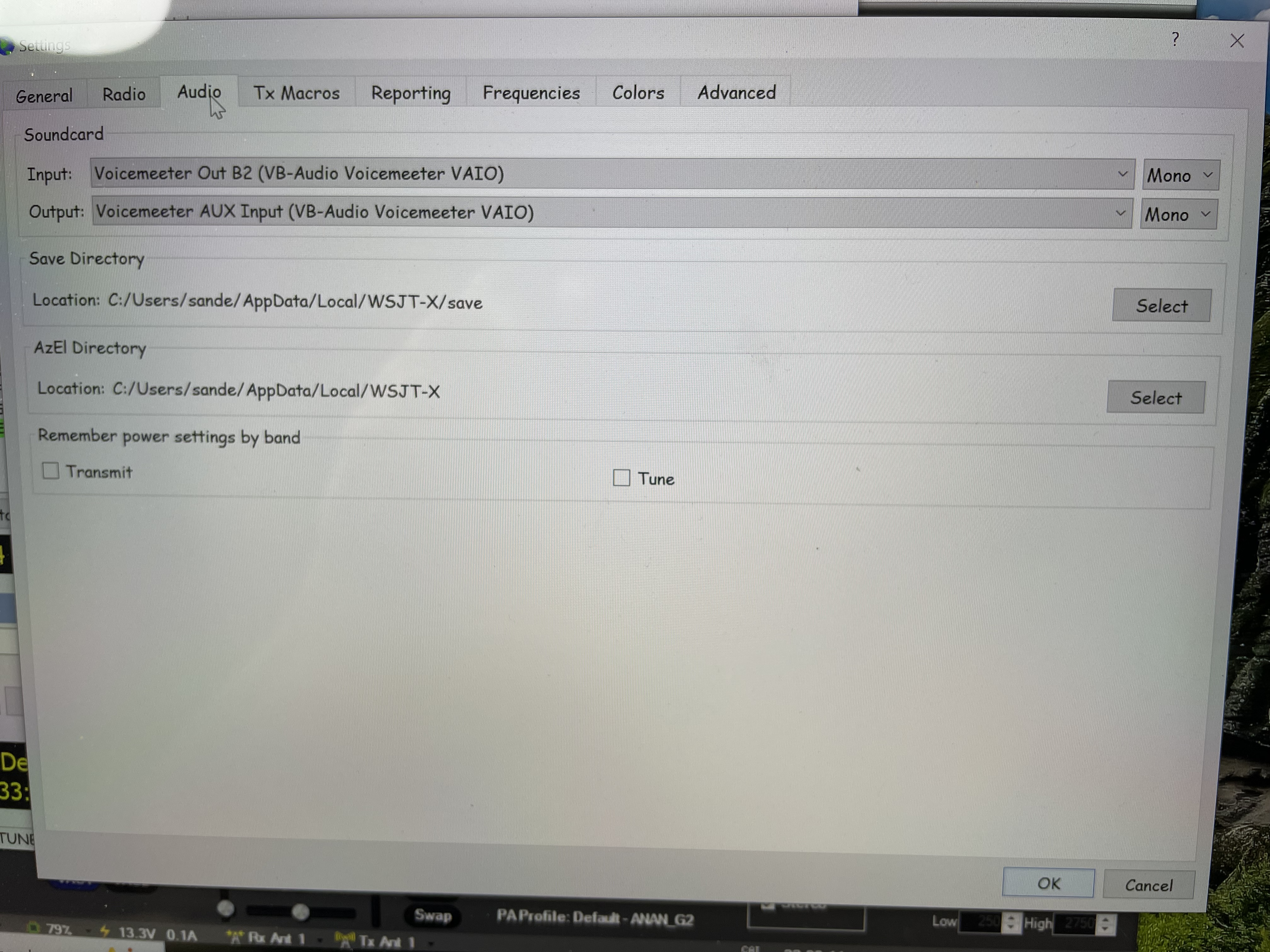

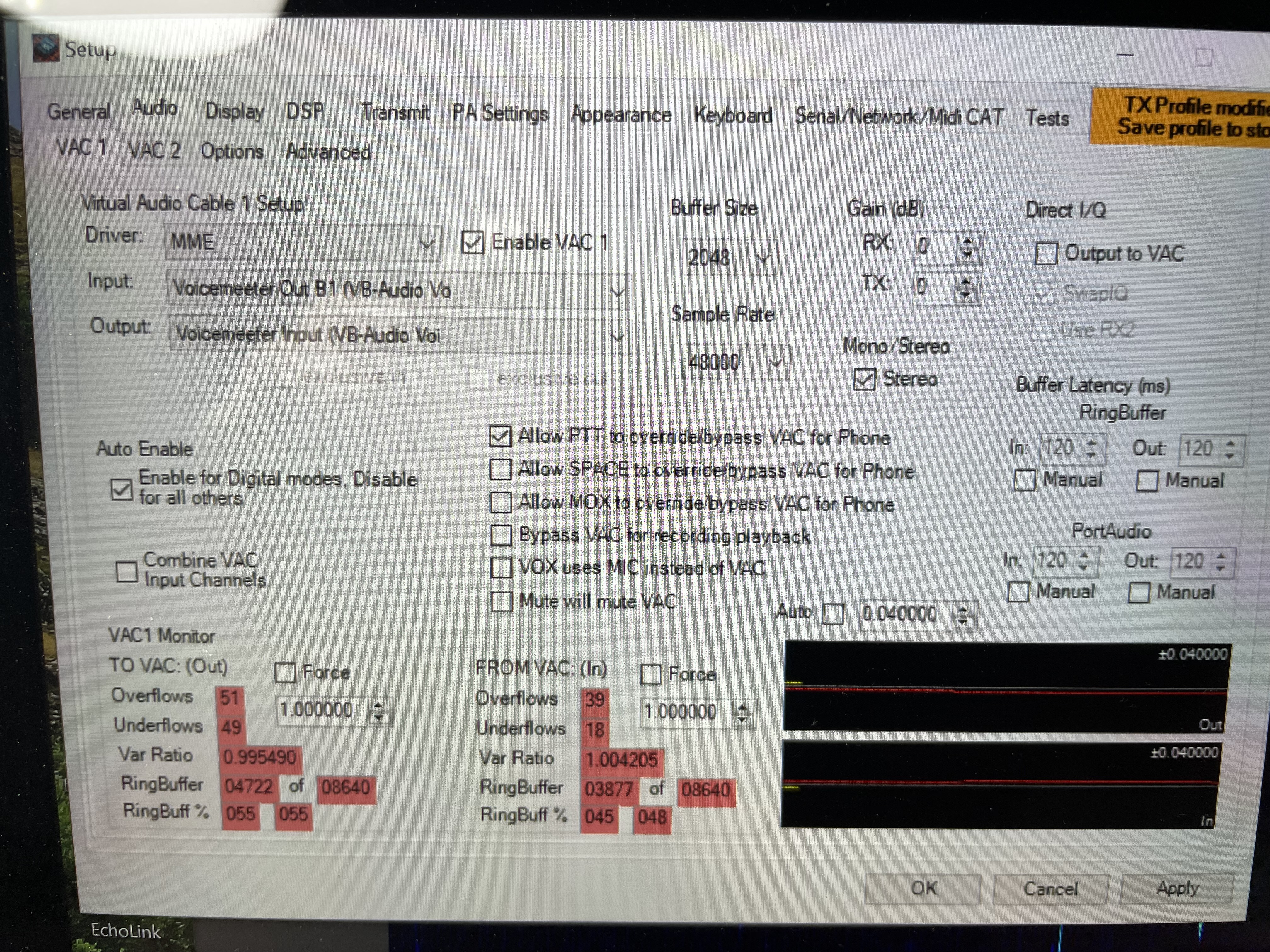

Answer is yes, attaching screenshots of setup which, by the way, were exactly the same in Thetis 3.5 and it transmitted without issue.
- IMG_8110.jpeg (3.24 MiB) Viewed 6116 times
- IMG_8109.jpeg (4.12 MiB) Viewed 6116 times
- IMG_8108.jpeg (6.04 MiB) Viewed 6116 times
Re: WSJTx and Thetis
Hmmm, that all looks fine.
I can see activity on the Voicemeeter metering on B1 that shows receive audio, and on the B2 master showing it going over to WSJT-X.
What happens when you use the tune function in WSJT-X, do you see activity on the B2 meter and the B1 master showing audio from WSJT-X going the other way?

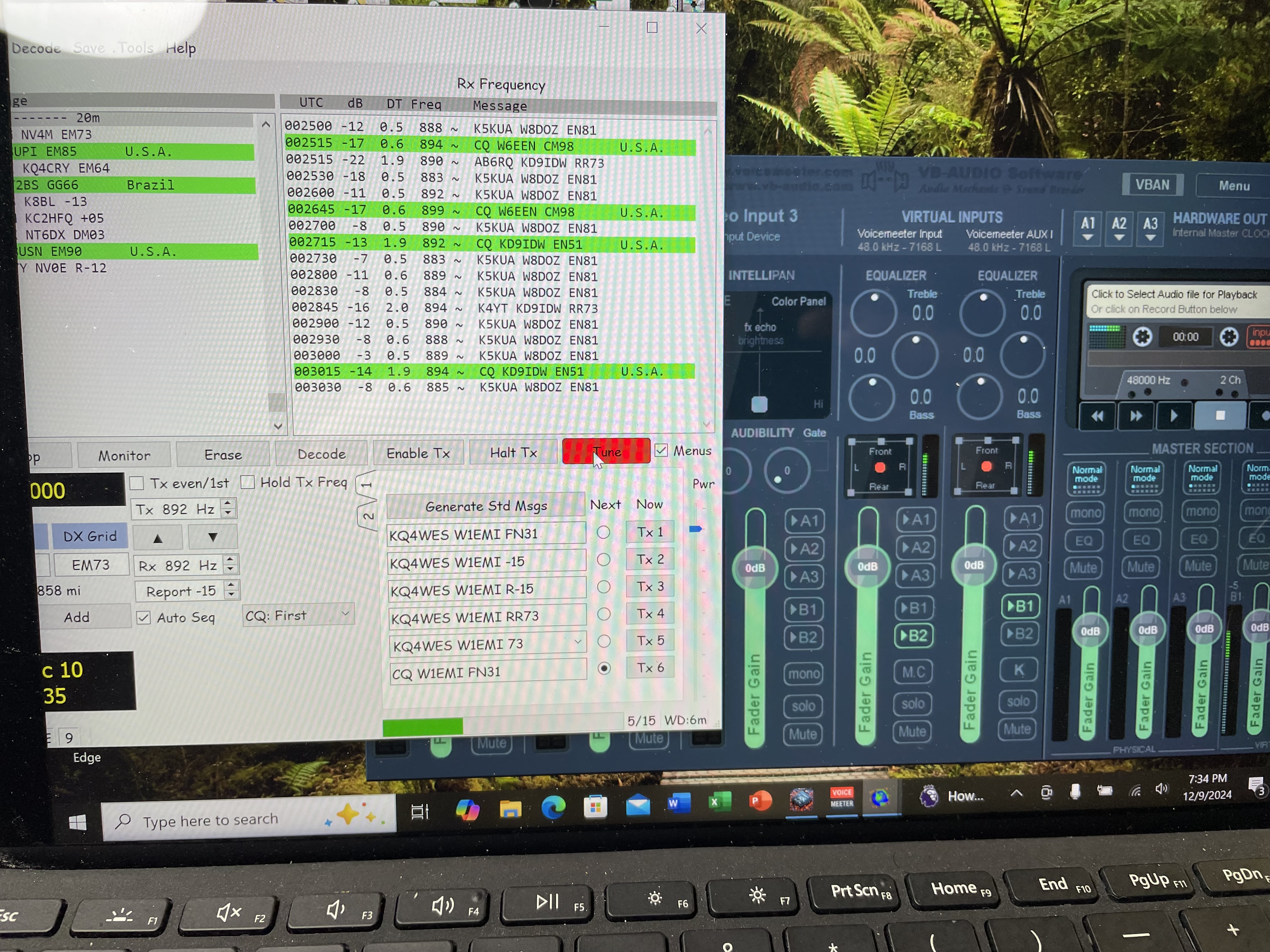

None of these steps seem to help, attaching what happens when I tune from WSJTx. Again, it all worked fine in Thetis 3.5, but not 3.6 or 3.7.

In your photo above I'm seeing audio going from WSJT-X into Voicemeeter. Did you set up a sound device on A1 and click the A1 route on B2 to confirm that? If so, then it would seem the problem is between Voicemeeter and Thetis.
