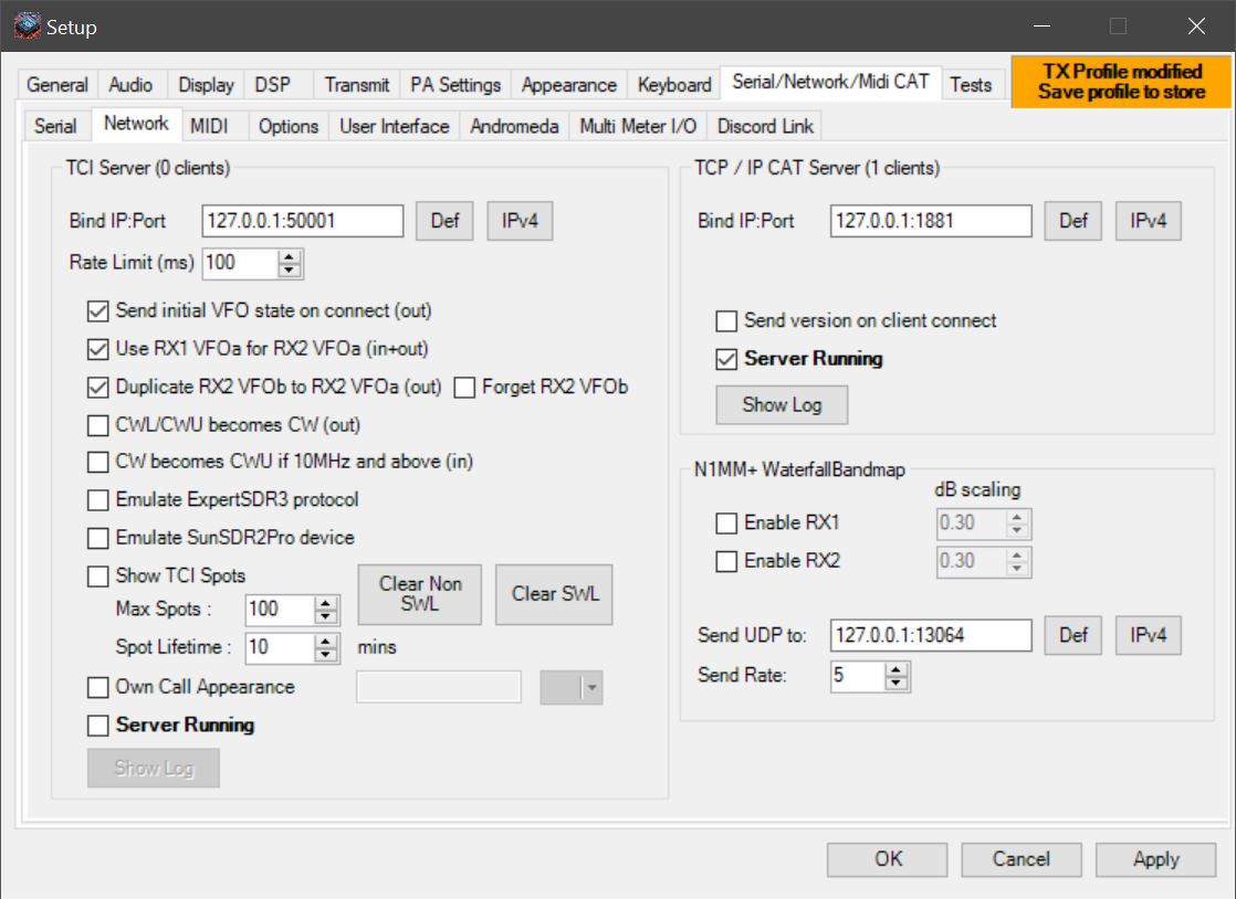

In Thetis I have the TCP/IP CAT server enabled with a bind port of 127.0.0.1:1881

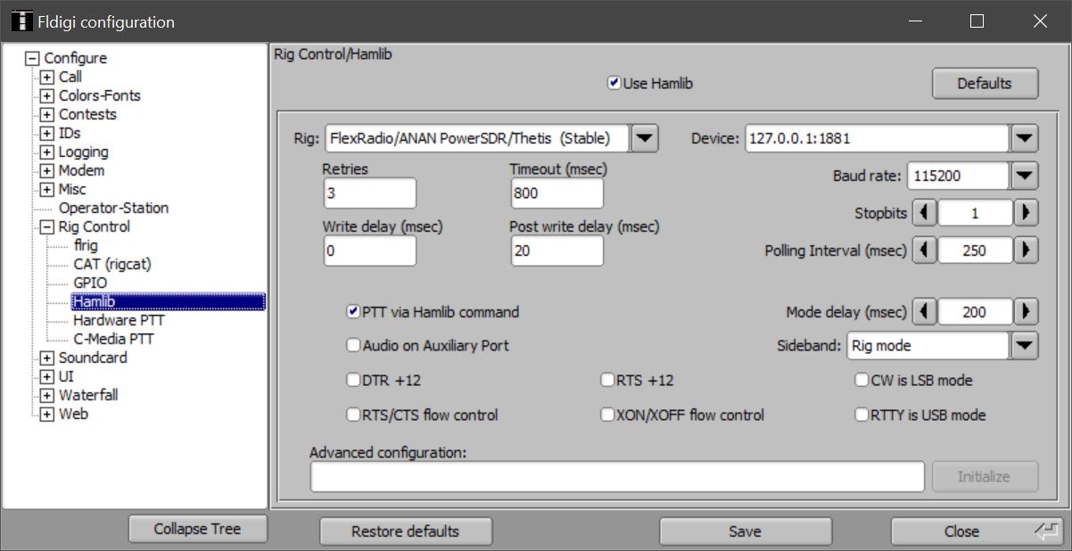

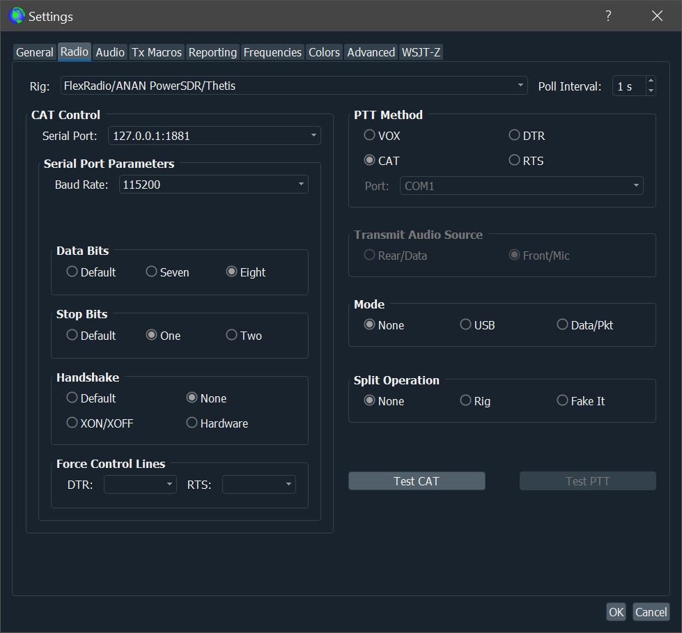

You may have configured it wrong, or maybe there is a Windows firewall issue. Here are some screenshots from my setup.

Fldigi offers a choice of flrig, hamlib, and rigcat. Here's my setup in Fldigi.

Oh I see and understand. That being said I see in your previous captures the Thetis page for configuring the IP address. Where is the second capture from?

I posted screenshots from Thetis, WSJT-X, and Fldigi.
