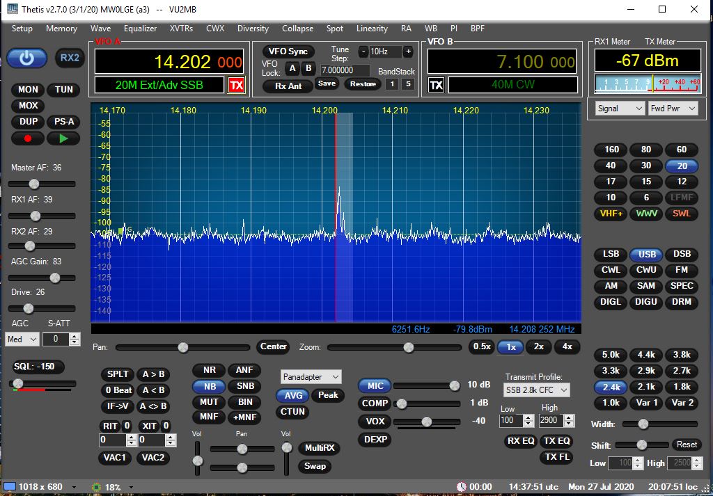

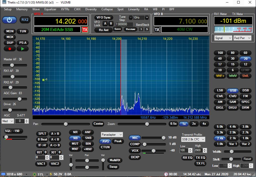

I have recently noticed that my 8000DLE is behaving in a weird way. Its noise floor suddenly goes down to -135 db from -105 and S meter on the same signal to -101 dbm (S4) from -67 dbm (S9+5). It was intermittent few times but today it remained on the bottom. What could be wrong and how to rectify it? Any help would be highly appreciated. I have reset the firmware. I am putting 2 screenshots of the same time with same signal. One is from 8000DLE and another one is from 200D.
200D shows signal at -67 dbm and 8000DLE at -101.
Bhanu
VU2MB
Bhanu
VU2MB
- ANAN 8000DLE noise floor and S meter.JPG (164.5 KiB) Viewed 19435 times
- ANAN 200D noise floor and S meter.JPG (157.86 KiB) Viewed 19435 times

I'm confused why you went to suggesting a fuse on this? It looks to me like you have TERRIBLE noise at your location and it simply went away! -101 is a little bit high for me here with a 2.4Khz passband ... and -67 is terrible noise - but it appears like I'm seeing the same signal and not seeing the second signal on the 'high noise' picture ... possibly he was just gone or he is now buried in the noise.

There may be minor time difference of few seconds amongst both screenshots thats why one signal is weak.

Dear Gary,
Those 2 screen shots are from two different radios. First screenshot is of 8000DLE and second one is from 200D ( just 30 seconds apart) and that's why they have different noise floor levels. 8000DLE when gets hot, its PTC cut off some circuitry and sensitivity goes low. I am not technical so cant explain why? when its cools down it works normally. Second screen shot is from 200D which was okay and thats why it shows strong signal and higher noise floor.
You must be in a cool atmosphere and 8000's LCD may not be showing you 40+ temperature but here in India when outside temperature is around 32 I dont feel like using AC and fan works just fine and 8000DLE gets hot internally but not the outer case as Heat sink is not connected to it.

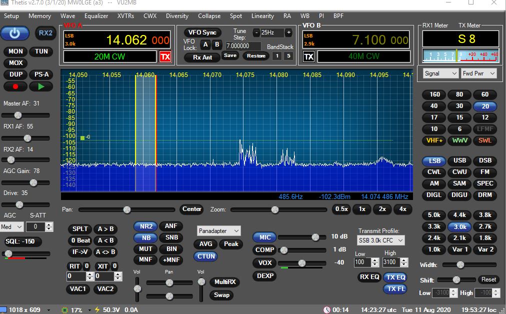

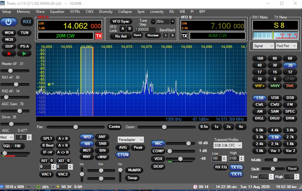

This post has nothing to do with the topic I have started few days ago with low sensitivity but it is surely to do with setting of low noise floor on panadapter. In Thetis setup under Display / RX1 Panadapter detector settings of Peak noise floor is much higher and it drops significantly if I choose average while noise level at S meter remains the same and this noise floor falls even more when FFT Size is increased towards 1.465Hz.
This can be seen in the 2 screen shots I am attaching. See the AGC line difference from the noise floor in average settings.
I would like to know if this low noise floor levels improves sensitivity / Dynamic range or something else or the visual change is cosmetic?
