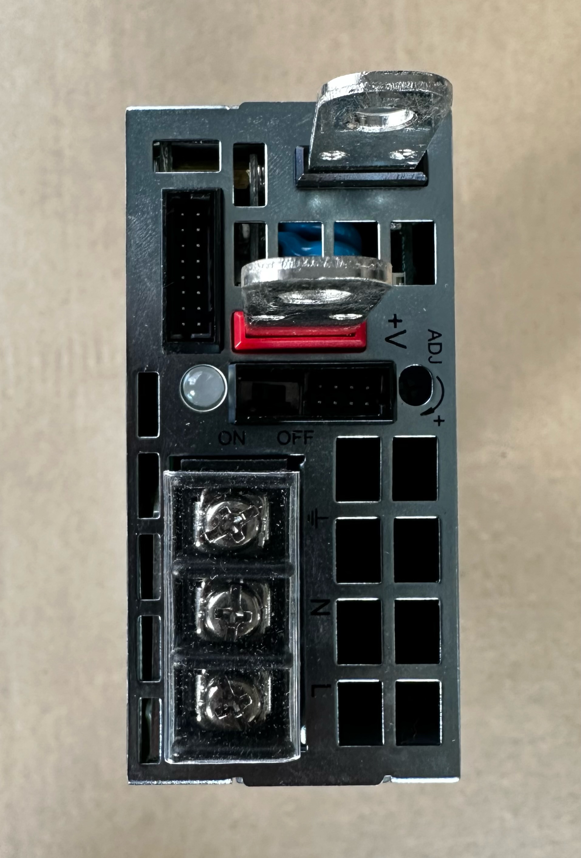

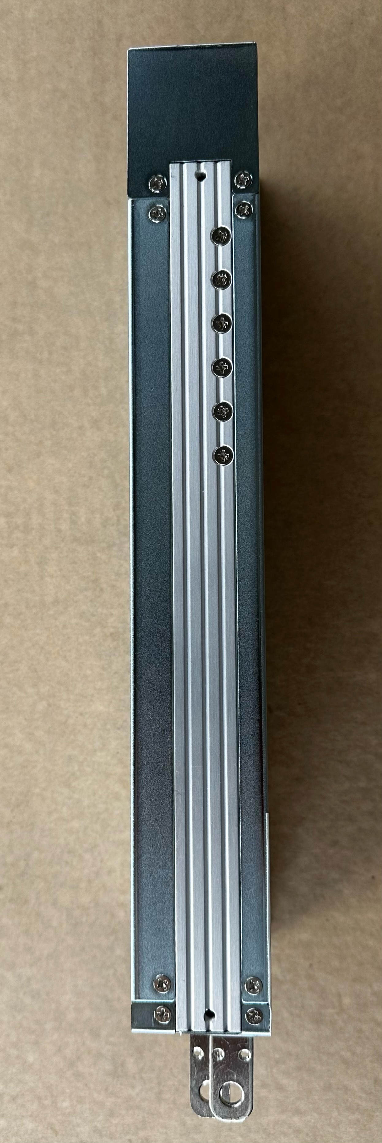

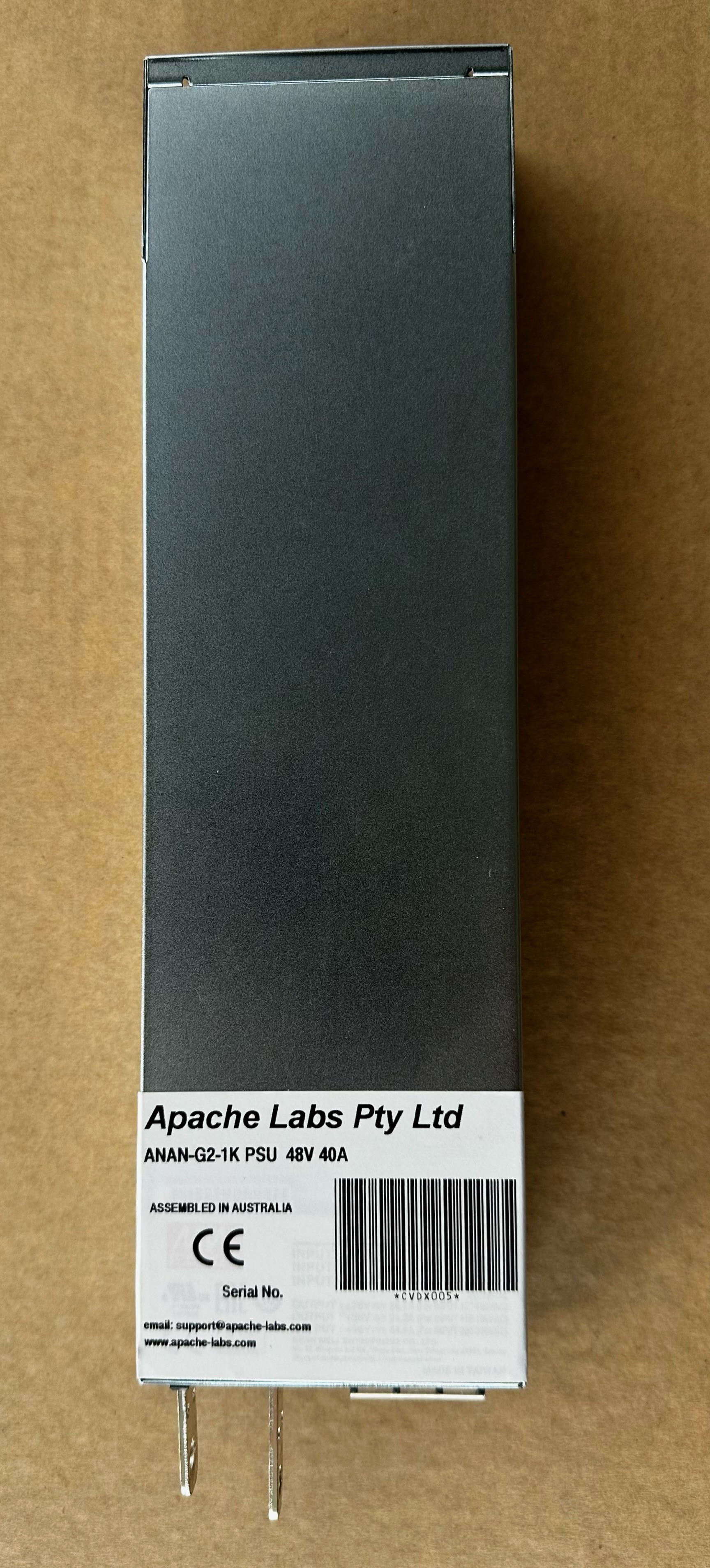

I got some more information.
The dimensions are 30cm L x 8.5cm W x 4 cm H
Fans are temperature controlled.
It's a non-standard Meanwell supply with modifications to make it RF quiet and quieter fans.

Postby VE3INH » Tue Aug 01, 2023 2:40 pm
Thank you again for your prompt response with photos and dimensions.
