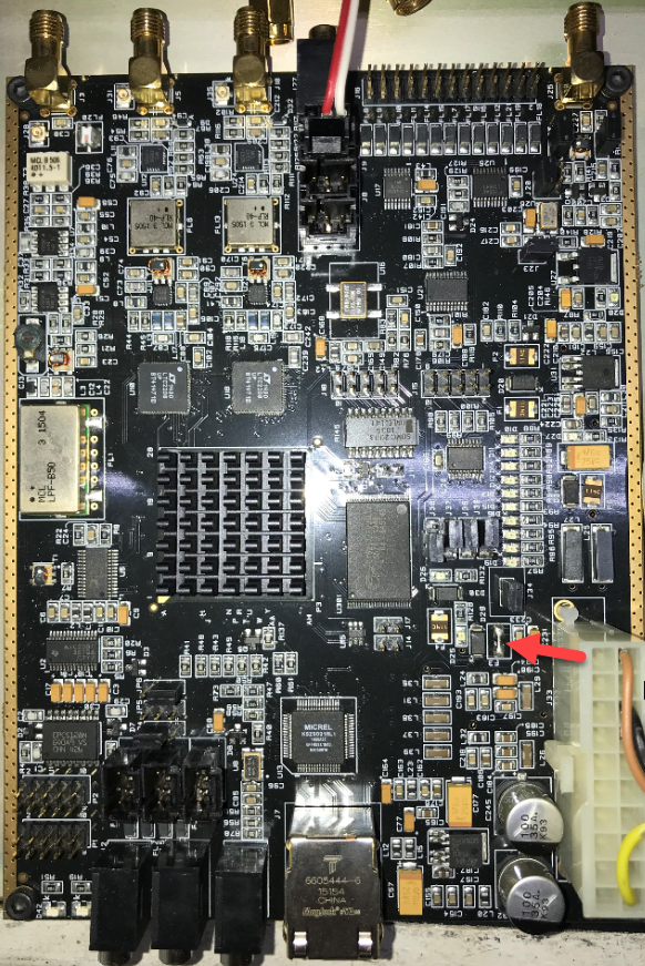

Bobs
100D Full Board F3 Bridged.png (1.09 MiB) Viewed 23594 times
Pauls
I just noticed on Bobs Angelia board the power plug stands vertical (bottom right). My one is different and turned 90 degrees toward the PSU. Does this depict if early/late board for the nosy bugger in me.
Cheers.

Can't say for certain on the age of your board. My 100D is one of the oldest units, and is like yours, so I'd initially guess "early build". However, maybe that is a change they made after adding the center shield piece to the design, so maybe later build, because wouldn't the vertical power connector interfere with the shield? Does Bob's unit have the center shield?
If you look closely at the photo, you can see mine has the improved TCXO board, the old linear supply swapped for the switching power supply, and is modified for an external PureSignal switch to avoid the horrendous crosstalk on the early rev. 15 and 16 RF boards.

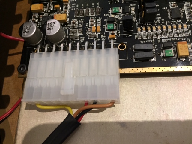

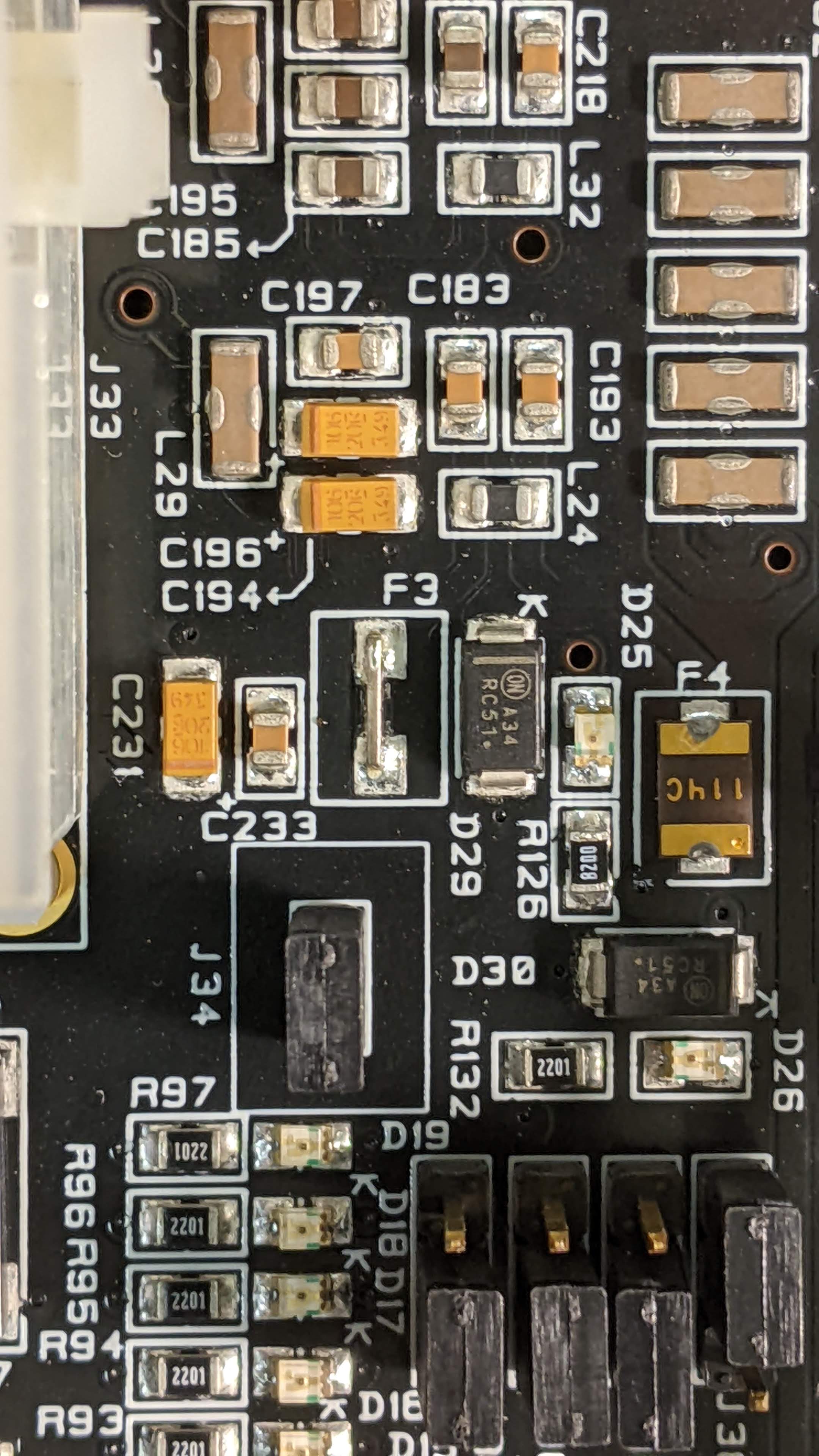

Four years after starting this topic I'm finally getting around to modifying my old ANAN-100D. I ordered a Littlefuse 1210L450SLWR to replace the stock part so as to do it up right.
Upon taking apart my 100D, imagine my surprise when I find this:
It turns out that during the very, very, early days of Protocol 2 development, way back in 2016, for which I was a beta tester, my 100D absolutely refused to run the code. I sent it back to Doug for "repair" and it came back in a state that allowed it to run the early P2 firmware. He had said that he had replaced the Angelia card. That part was no surprise, because it was evident early on that the firmware builds were not making timing on all serial numbers. But what he neglected to mention was that he apparently also "fixed" the F3 problem. In fact, at that time, nobody was even talking about the F3 problem, it was not common knowledge. But it must of been so to the Apache head shed. Interesting...
