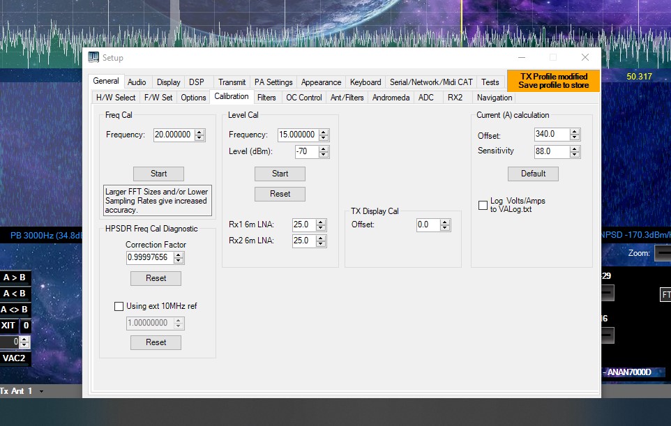

I have been experiencing since day one my Anan 7000DLE MKIII locking in two different places when powered on, I typically just run a calibration with WWV in Thetis to resolve the issue and it stays OK most of the time but very seldomly jumps back off again the correction or offset is to around 0.99997656 instead of 10.000001 or so.
Anyway I had purchased a Leo Bodnar GPS 10 Mhz source many months ago but with limited time to spend with my ANAN, I just hooked it up tonight.
My Results:
Radio is off frequency by this same margin when observing WWV but I cannot seem to enter a correction factor into HPSDR when use ext source is checked?
Pardon me for not seeing much of anything on here about using an ext source and still applying a correction factor in Thetis to get everything to be correct.?
Thetis defaults to 1.00000000 if I check the ext source and I can see the WWV carrier jump to the left of the center crosshair then my radio is clearly off frequency. It looks like I need a correction factor applied to my ext source to get this radio ON freq and hitting the reset button does nothing.
My Leo Bodnar software panel is pretty much exactly the same as the one posted earlier in this thread.
Please point me in the right direction. Thanks

Robert, I assume you have tried adjusting the adjustment that is just below the option "Using ext 10Mhz ref" and not the "Correction Factor" adjustment when you have the GDO connected? I have a 7000 MK II and I use a GDO and have no trouble moving the "zero" around with the adjustment factor in the bottom left of the Calibration Tab. My correction is small but it did take just a bit to zero it to WWV with my GDO; 1.00000003. You shouldn't hit the reset button after entering your offset unless you want to clear it.
I'm assuming you have the Thetis version with this correction area in the Calibration tab. I don't remember which version it came out in. Before that version, there was only the "Correction Factor" window which I don't believe affected the external input at all.

Hi Joe, Thanks for the reply, the version I am running is listed in my signature and I believe its the newest out or close.
My calibration section is as follows:
freq cal.jpg (135.84 KiB) Viewed 25828 times
When I check to use the external 10 Mhz Ref, It will not change if I move the correction factor up or down and it actually reverts back to 1.0000000
If I calibrate with WWV it adjusts and stays put but my radio sometimes jumps off.
I can't use my GPSDO at all with out a correction factor in HPSDR?

Robert, you may have already tried this but if not give it a go. Save your current database then reset the database and shutdown Thetis. Power cycle the radio then start Thetis. Put just the bare minimum setup info in to get the radio operating and then try the calibration routine again and see if anything changes. If it still fails, reload your database.
This actually sounds like a hardware problem to me. Assuming the database reset doesn't change anything, I would think that even more strongly.
You say it sometimes "jumps", I assume you mean it jumps frequency? If so, how much does the frequency change? Does it ever jump back?
Joe, W4WT

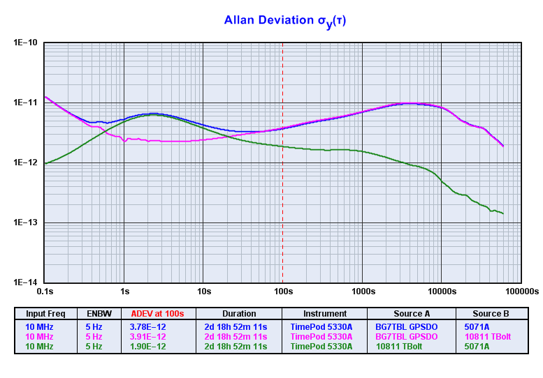

So what I believe that I am seeing is the GPS switching the input to the DAC up and down by one digit because the actual required frequency is between the two levels. The average 10MHz frequency is very good indeed......the instantainous frequency can be back and forward by a few milli-Hertz depending on the logic level set.
In a well-designed GPSO this process should be all but unnoticeable. For instance, take a look at this Allan Deviation plot comparing three different frequency references: two GPSDOs and a Cesium primary standard.
Frequency error is the reference frequency, 10E6 Hz, multiplied by the Allen Deviation. The plot shows short and long term performance, the X axis is the measurement interval ("tau"). In all cases the frequency error is around or better than 100 µHz.
So yes I'm suffering from Segals law. Both GPSDO's that have very good stability and frequency.....but their instantainous frequencys are slightly off and change at a random rate. Not good for the final trimming of my OCXO.
So now do I look for the next level in frequency accuracy...a rubidium standard or perhaps something that uses caesium ?
Now it's time (Ha! A pun!) for another well-worn aphorism, "Better is the enemy of good enough." Sometimes also written as "Perfect is the enemy of good."
Although it would appear the Allan Deviation performance of the two "watches", the two GPSDOs, is not stellar, the question remains: are they good enough? I'd argue that they are more than adequate for HF radio. Either will keep the radio well below 1Hz of perfect. Even if you had access to a NIST-traceable and recently calibrated 5071 (to buy a used one will set you back north of $15K) the adjustment of the OCXO will drift off of that calibration quite rapidly.
